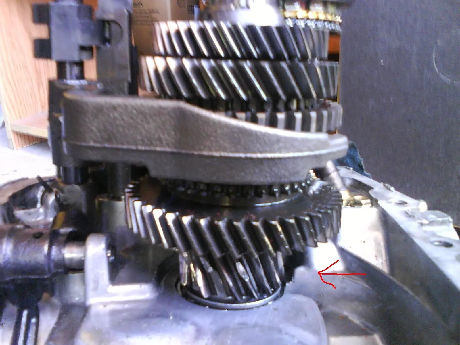

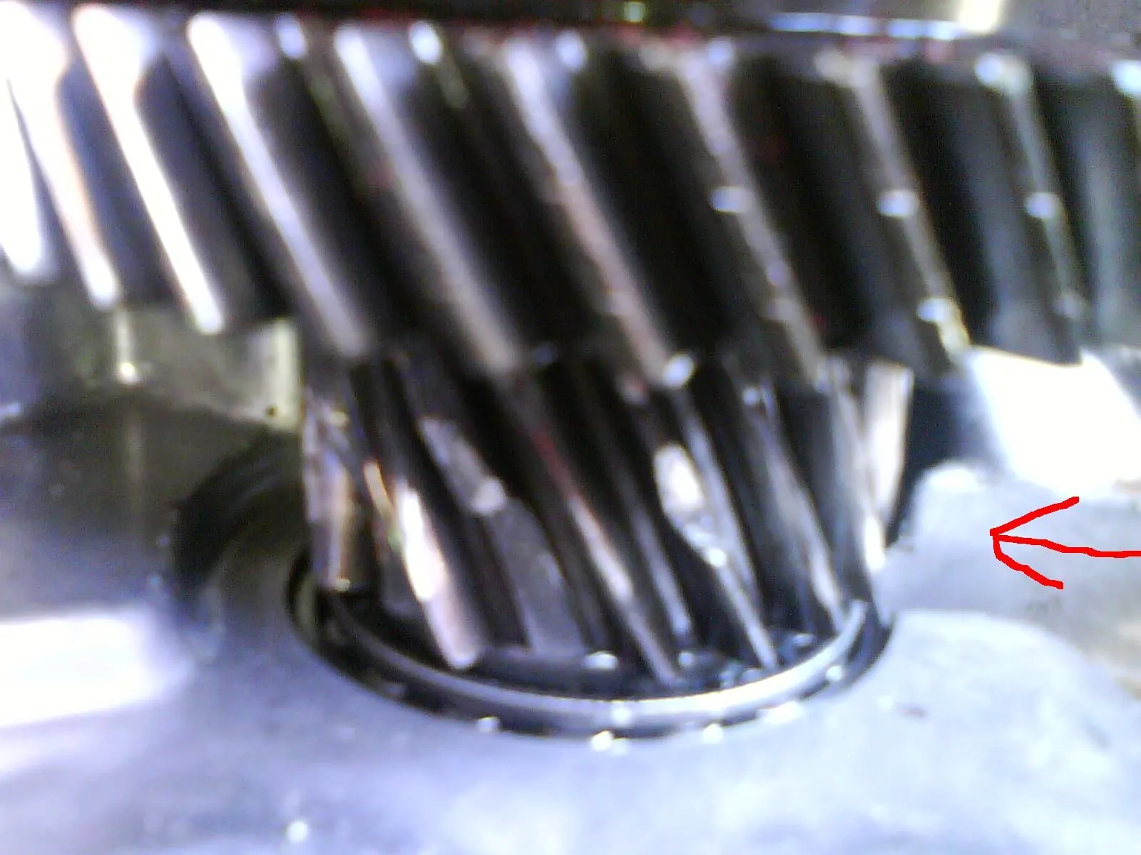

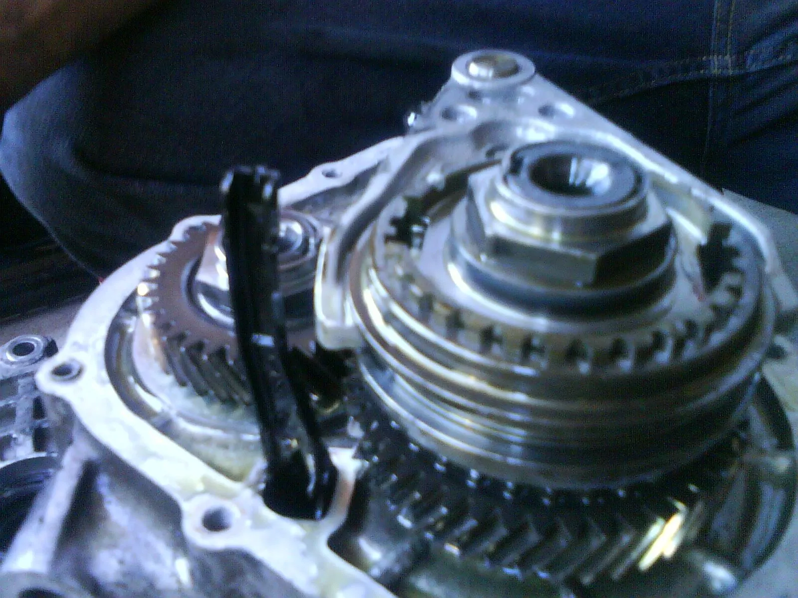

Well I was Geting ready to install my lsd and when i took it off I found out that the gear on the bottom was also broken so I would like to know what the part number is for it. I also would like to know what the part number for a black plastic thing that i broke when i was taking the tranny apart. If anybody knows the numbers please help thanx

So I did'nt want to start a new thread for this question I have. How can I take the bearings off ? What tool do I need or is there a way to pop them off?
just as a fyi, you will haft to take both those shafts out, as well as the shift forks and the 5th/reverse rod and the rod right beside it (i know you knew that). However be careful when you do this because there is a small spring and ball connected to the 1-2 and 3-4 shift rod, when you remove the punch pin at the bottom of that rod, and remove the gearshafts you got to be careful that that little ball at the bottom of the shift rod doesnt fly out (the ball im describing is part of the shift linkage and if the ball is out the linkage will not stay in any gear). o yea and when you go to install the shafts and the rods, go ahead and assemble the rod,shift forks and gearshafts outside of the tranny, because you will find that you cant fit the 1-2 shift fork over the rod and into the selector gear if you put the shafts and rod back in at different times...
you probably know this but i just wanna let you know so that you dont beat yourself up trying to get everything back in properly (just in case) if you need any help email me at wolfy06@gmail.com, my transmission is out right now and I just got the lsd back in place, so if you need any pictures on how to put everything back together i can help.. and btw you should be able to use a gear puller, you should be able to rent it from autozone. o yea the thing your talking about is the oil passage and its part number is G560-17-540A. o yea 1 more thing check the manual from mazda becauces there are a few things you need to oil before sealing the trans. back up.
keep me informed and if you need any part numbers i will try to help you out, i just bought alot of things from mazda.
