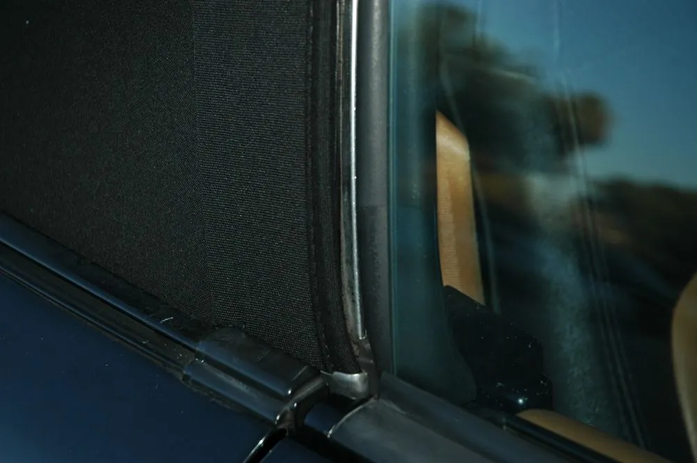

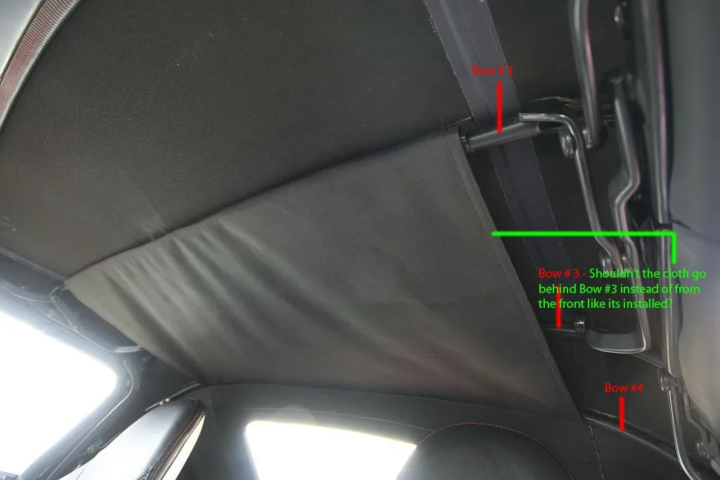

1. Picture1: On the original, I remember the cloth going under (behind) Bow #3. But in the new installation, the shop took it in front (over) Bow #3. How it is actually supposed to be installed?

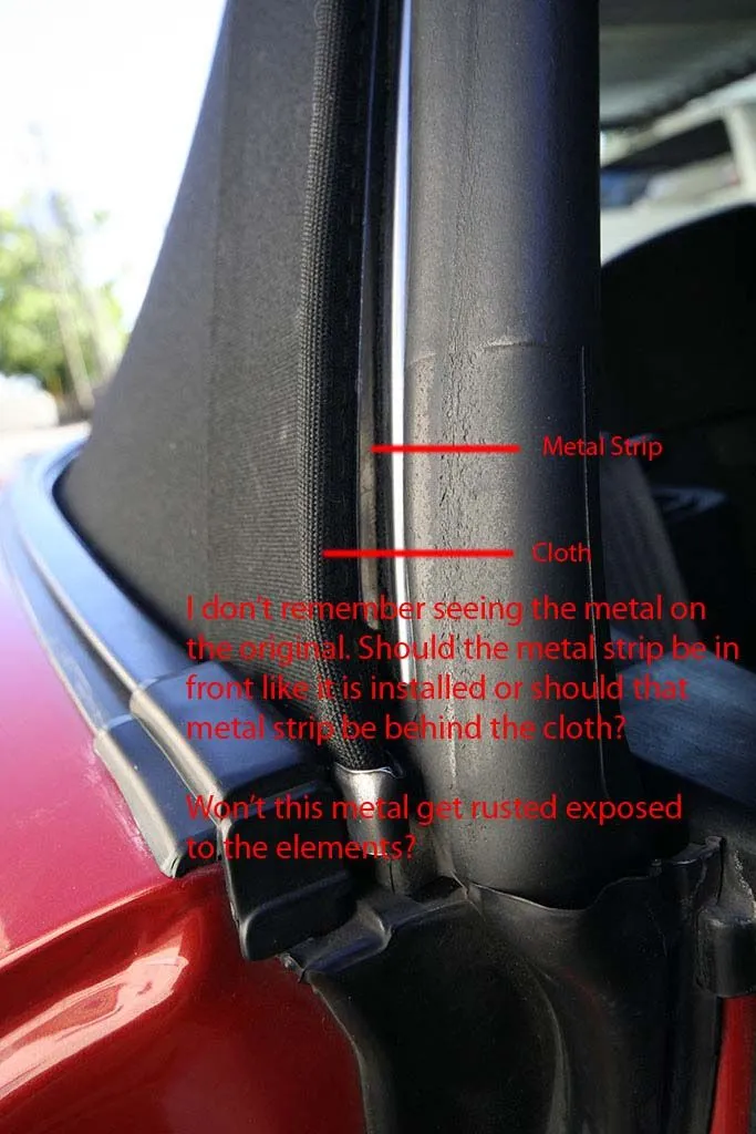

2. Picture2: The picture shows the passenger side. The metal railing can be clearly seen from outside the car and again, I do not remember seeing it in the original installation (but I could be wrong). Is it correctly installed or should the cloth be in front of the metal strip?

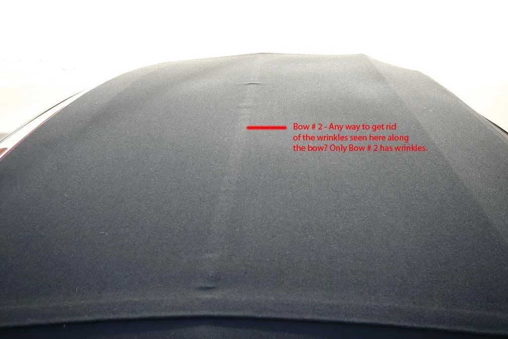

3. Picture3: Only Bow #3 has wrinkles . I was hoping for a perfect installation at least when its brand new. Should I go back to the shop and insist on them getting it right ? Do you have any suggestion on what may be the problem here?

Picture1: The listing panel should be routed above Bows 3 and 4. (The bows should be exposed).
Picture2: Regarding The metal railing can be clearly seen from outside the car.
Please see attached B-Pillar photo taken at a angle to better show the exposed metal. This is a normal installation (2962 top on our car).
Picture3: Only Bow #3 has wrinkles. The wrinkles may go away simply by letting the car sit in the sun for a day or two. Alternatively; after resolving the listing panel installation, ask the installer to lightly steam the exterior of the top, along the bow.
