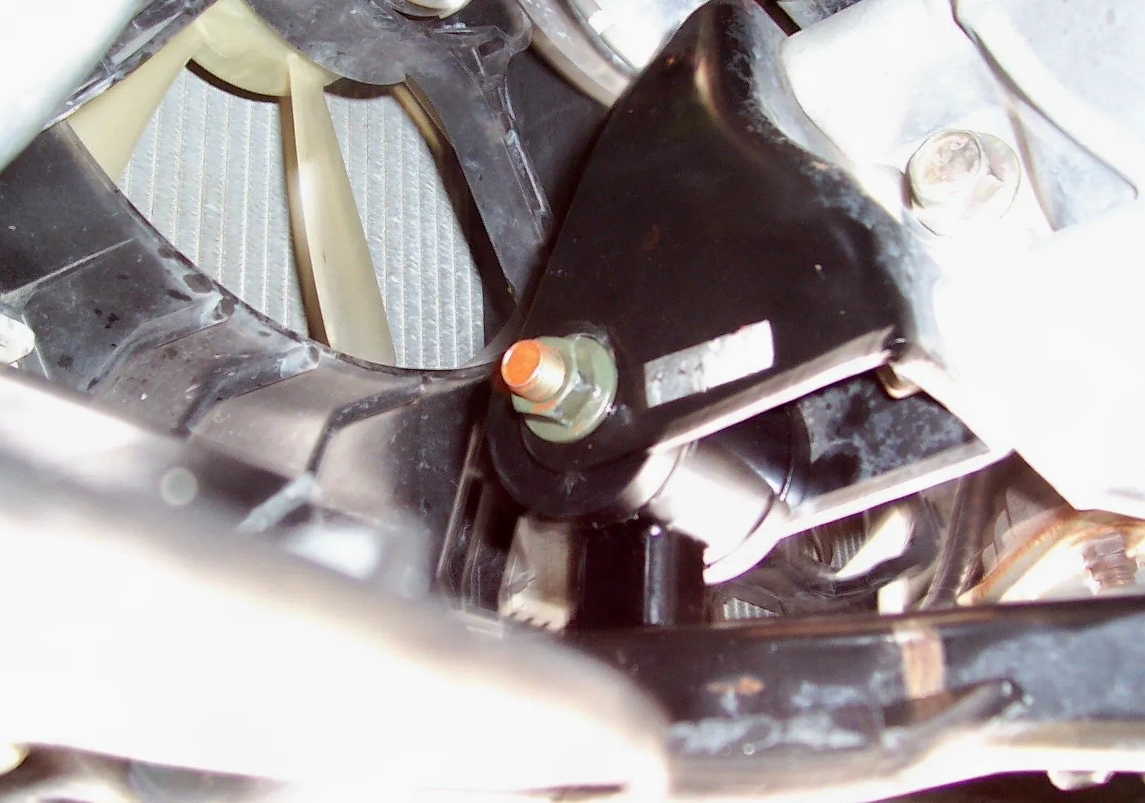

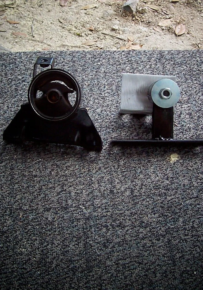

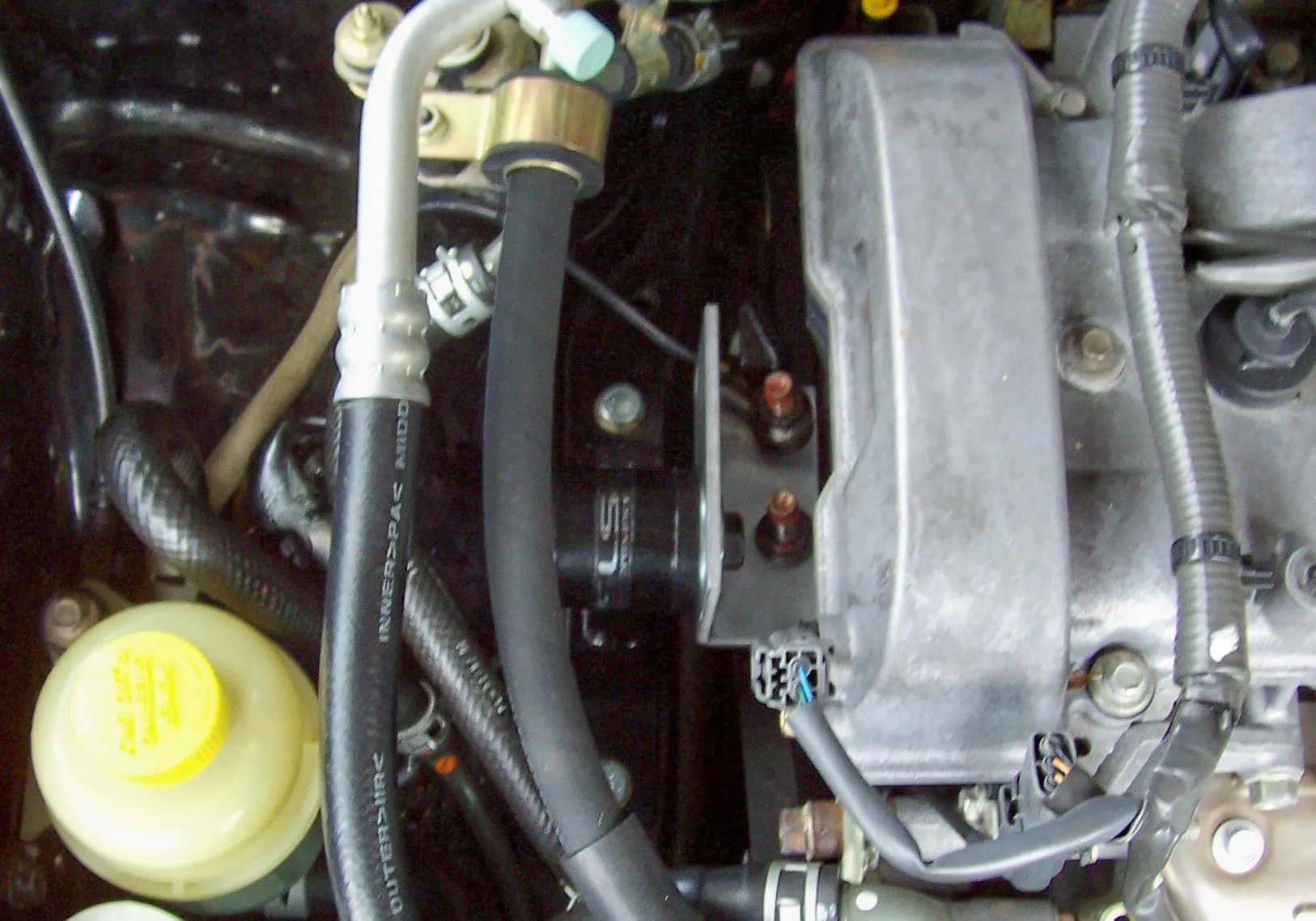

Installed my front and side mounts from SLS Performance. So far so good! The engine moves little to none, no impact on shifting, vibration is slight if any, and the tires plant well with both mounts on. Installation was a snap.Can't wait for their rear mount to be released.

I did the side mount first with all 4 tires on the ground and using a floor jack with a piece of wood to support the weight of the engine. Soak the nuts and bolts with liquid wrench prior to loosening.
There are 3 - 17mm nuts to remove near the timing cover. Then take off 3 - 14mm bolts and 1-14 mm nut and pull the oem side mount out of the way. You'll need 2 new bolts with washers to anchor the side mount. I went with 17mm head 10 x 1.50 pitch bolts. The supplied bolts are too big in diameter to fit in the fenderwall holes. You do reuse the oem nuts near the timing cover. The mount comes with a 19mm bolt and nut to mount it to the bracket.
I put the car on jackstands to do the front mount. Using the jack again to raise the engine ever so slightly allowed the mounting bolt to slide right out. Only 3 - 17mm nuts to remove, 2 on the mount studs and 1 on the mounting bolt. Once all are removed the mount rotates right out. Use the supplied bolts with the oem nuts to secure the new mount. Make sure the bracket is lined up with the holes in the crossmember so the bolts slide through. You'll have to pry the mount in to the exact position.
Working this way allowed me to leave my cai and hardpipe in place. There was no room for me to get to the nut on the mounting bolt from the top. Its a very easy job. Use your 1/2 drive ratchet and deep sockets with a breaker pipe/bar to loosen the bolts and nuts. Don't waste your time with smaller tools.

You're correct. The stock 14mm bolts for the mount do not work with the SLS side mount as its beefier. You'll need a bolt with more bite.

is the f mm alot thicker than stock ?? the side mm frame looks strong ?? thick material ??

Its not any more thick in terms of mounting it in the oem bracket, just has a solid mass around the bolt sleeve compared to the flexible rubber oem front. Its a perfect fit and good alternative to other options. The frames on these mounts are definitely stout.
