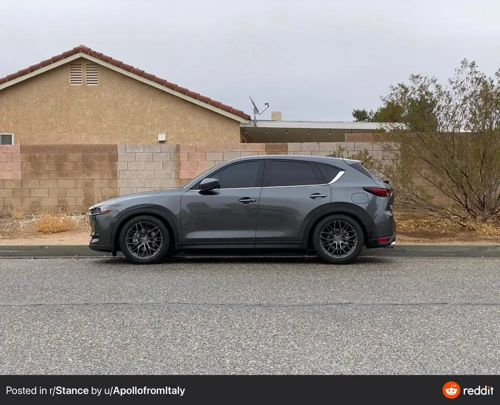

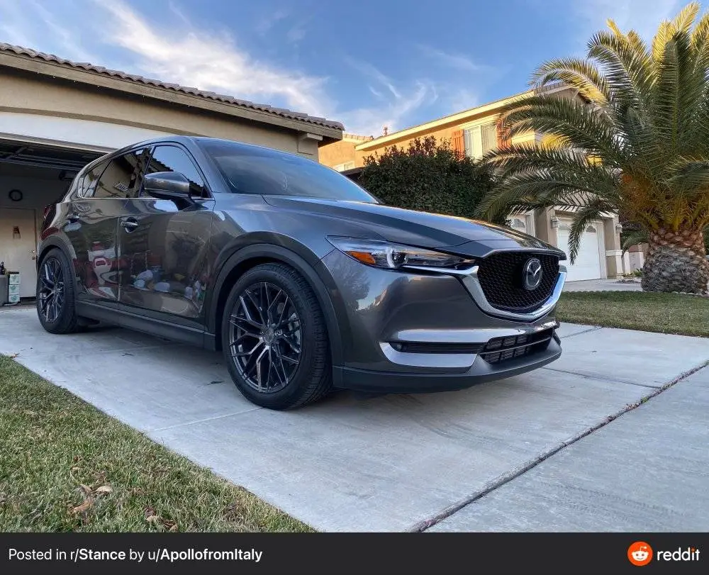

Contemplating 19x9's with either +32 or +20 offset and 245/50 19 tires to maintain the rolling diameter for AWD, and ability to use the spare.
A quick photoshop:
In the past I used spacers with proper extended lugs to perfect the offset. But with lug nuts I don't want to mess with spacers.
I feel like +20 is a bit extreme, but the online calculators show that it lines up with the stock inner wheel. Only issue is that it pushes out the scrub radius a bit, and possible fender clearance if/when lowered.
I feel like there is more to the equation as well...

Like JKidd said... Offset 20
My thinking... People are running 25mm spacers with the stock wheels (45 offset), which leaves it at 20mm and it looks great. But, come to think of it, that's with a 7" wide wheel. Another 2" would be a bit extreme. Back to the drawing board.
There's a reason most wheel shops won't sell rims lower than a 35 or 38 offset.
Can you run lower offset? Sure, you can do anything.
But should you run wide 9" wheels with lower offset?
You risk rubbing the suspension during turns as well as possibly tearing your fender apart. Plus potential camber adjustments, etc.
Not to mention your changing the dynamics of the vehicle. Pushing the weight out is going to affect acceleration and handling, as well as wear down your suspension and braking components, etc., etc.
The further you go out, the cx5 isn't going to be the same.
If you want to change it that drastically, consider trading it in and getting a Jeep or a true sports car.

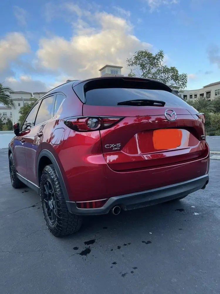

Try to use what guys already have as a starting point. Personally I’d love to push my wheels out a little but by going a bigger tire etc I’m already losing efficiency in the mpg range. Totally worth it since it’s only 1-2mp maybe on the hwy.

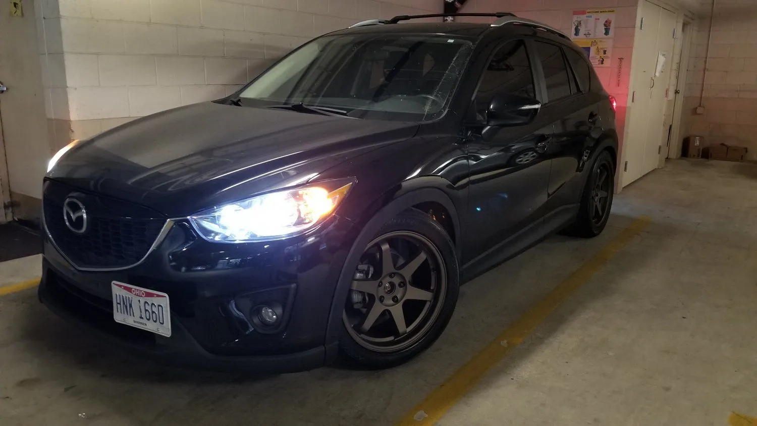

245/65/17
17x8 et38 another pic showing how 8 inch wheels with 38 sit.
245/65/17

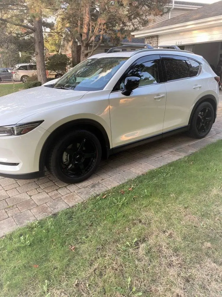

Added some 20x8.5 +40 459BK RETRIBUTION Gloss Black Wheels by PLATINUM wrapped in 245/45/20 General Altimax rubber. Pretty happy with the look but I think the car needs to be lowered a little.

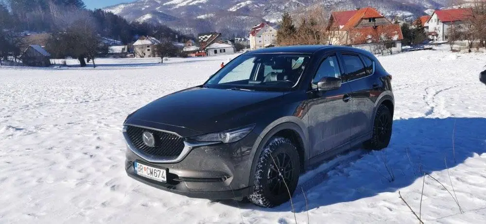

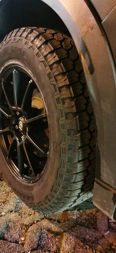

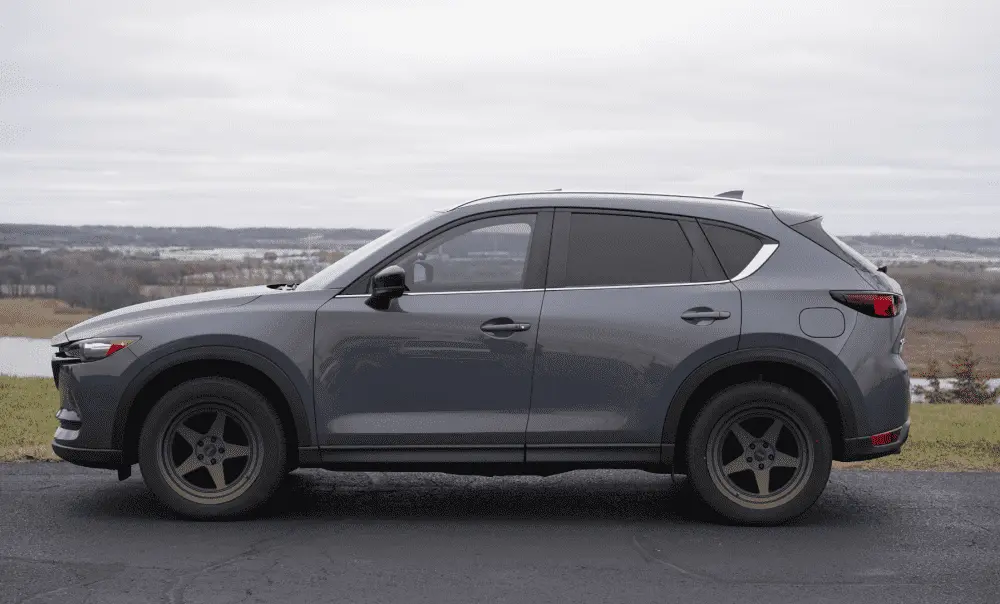

Hello everyone. Just added a new set of wheels. Sparco assetto gara + general grabber at3. 235/65/17. For now i am really satisfied and i love how it looks!

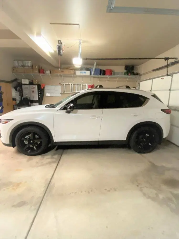

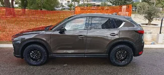

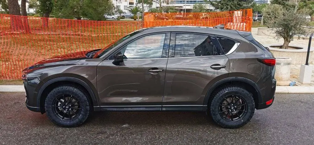

Hey guys. Just downsized my wheels to 16inch. Got poorly maintained roads during daily commute so downsizing is the way to go. Anyway. Here’s some pics and specs
Wheels: ViP Status Turismo 16x7 ET +38
Tyres: 235/70R16 Hankook Dynapro AT-M
Nice!! This is the look I'm after, but thinking about going with 17".

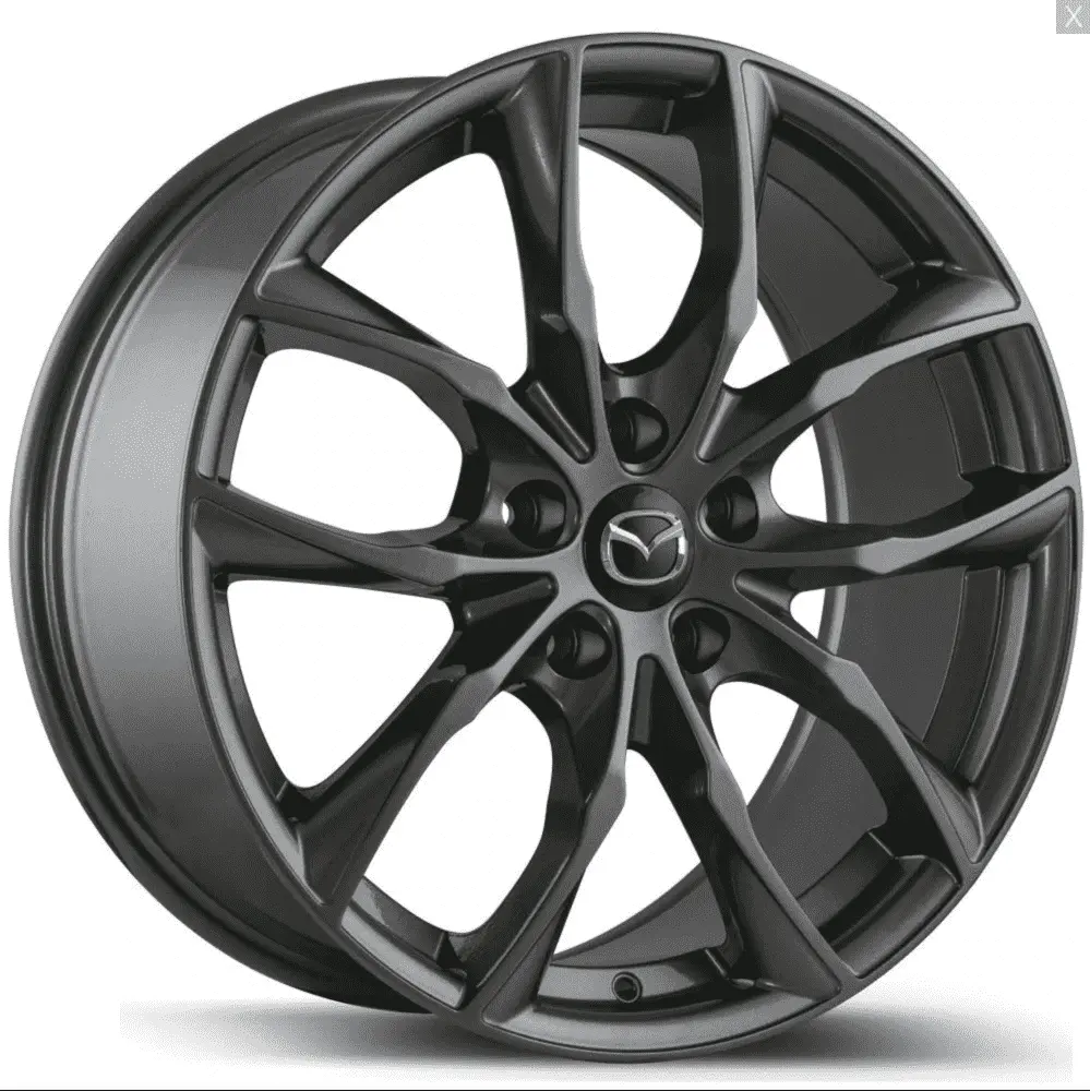

I have a 2021 CX-5 Signature in Deep Crystal Blue Mica. Trying to decide if I should swap the OEM wheels for M001 wheels. Either way I'm going to with larger tires, 245/50/19.
What do you all think? Keep the OEM wheels or get the M001 wheels? Thanks for your opinion everyone!
M001s for sure

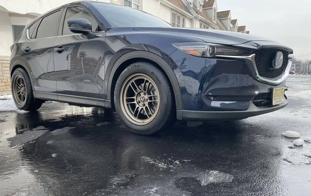

2021 GT-R on H&R spring
19X8.5 Flow One Wheels ET +40
245X50X19 Continental DWS
