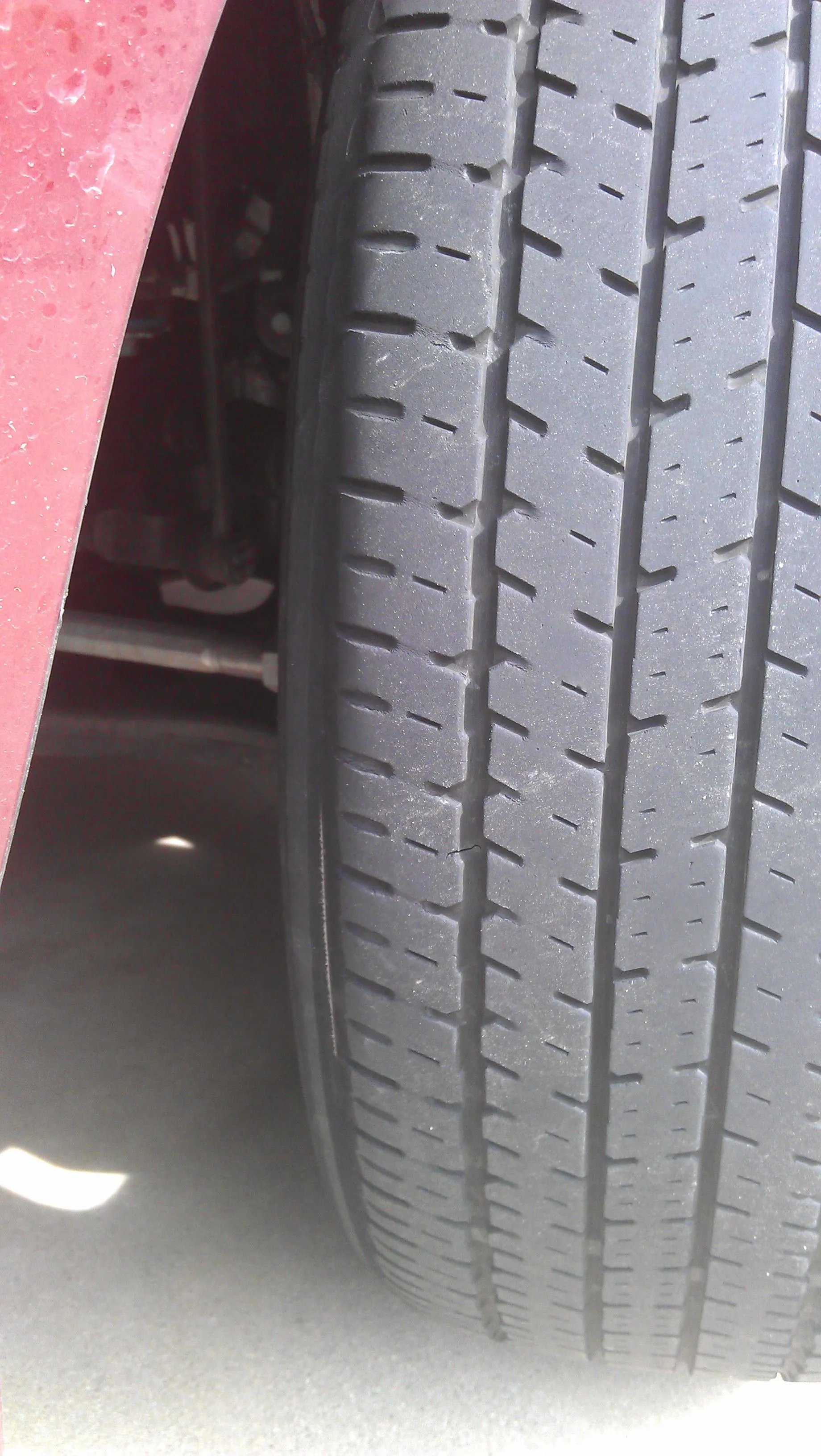

Car was aligned at dealer at 16K miles. Car has 28k miles.
Car is on factory Toyos. Plenty of tread left.
Inner FRONT PASSENGER tire, worn to cords. Only about 12 inches of the tire, not all the way around.
Pic attached.
Any ideas/thoughts?

Wow... I would almost guess a defective tire. A belt partially separating and bulging/wearing at the point of the extrusion. However you'll usually feel a vibration with a mild separation also. Especially low speed wobble in the steering. I've never seen a tire start to expose the cord like that and not have more wear in the surrounding area. The tread area seems to be evenly worn and no extreme feathering or other issues.

I'm having trouble making it out in the pic, but to me it looks like either a separation or a cut. Def not alignment wear. I recommend taking the wheel off and looking closer, also look for any other evidence in the wheel well.

I took the wheel off, but forgot to take a pic. Wheel well is clean. Its just literally a part of the tire is like that.
All 4 tires are wearingly exactly evenly, otherwise.

I still don't think it's alignment, though I could be wrong. >> Need more pics. <<
If it is alignment, that is some of the most extreme toe out wear I've seen. And difficult to believe that one tire has that wear and the other side doesn't (the thrust angle of the front axle is always going to be straight with the direction of travel, so toe wear on the front tires will be about equal)
How many 32nd's do you have left on the rest of the tire? It looks like at least 5 or 6/32nd's in your pic.
Usually toe wear looks more like this:
Note how in this pic, the wear extends inwards into the tread, from the sidewall, an inch or so. I don't see that in OP's pic - I see damage immediately at the intersection of the tread to sidewall, and nowhere else.
Front toe wear will be equal left and right (on the front, at least - you could have toe wear biased to one side on the rear). If you don't see wear on the left front tire, this wear on your right front tire can't be toe wear. Maybe this damage happened when the tires were on the rear of the vehicle and you didn't notice when you did your tire rotation. You would need to be running extreme camber to get wear like this. Camber typically creates more gradual wear across the entire tread like this:
How much are you lowered? (if any?) Do you have camber correction arms in the rear? Like I mentioned, if this happened in the rear of the vehicle, a combination of toe and camber wear may be able to do this to just one tire. Have you taken a close look at the other tires? If you are lowered, have you taken a close look inside the wheel well for evidence of rubbing? (though the mazda5 has pretty good clearances actually) All bushings and ball joints in good condition?
Only 12 inches of the tire is worn, NOT all the way around.
5/32 left on all tire.
I took of all 4 tires, everything looks normal, except this one front tire.
It is POSSIBLE this happened in the rear, but I can't confirm, that.
Car is bone stock, not lowered at all. Running Factory alignment specs.
In that case, I'm sticking with my original "not alignment related" diagnosis. Tire defect or damage from road debris, IMO.
