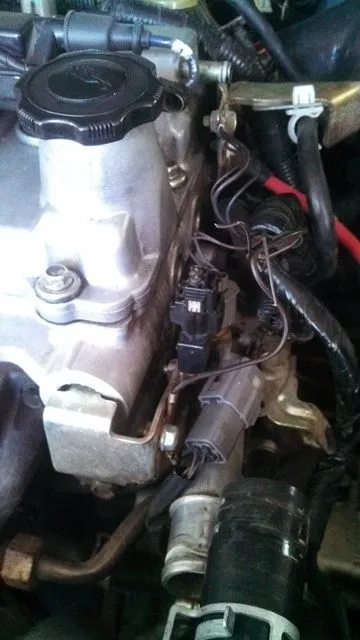

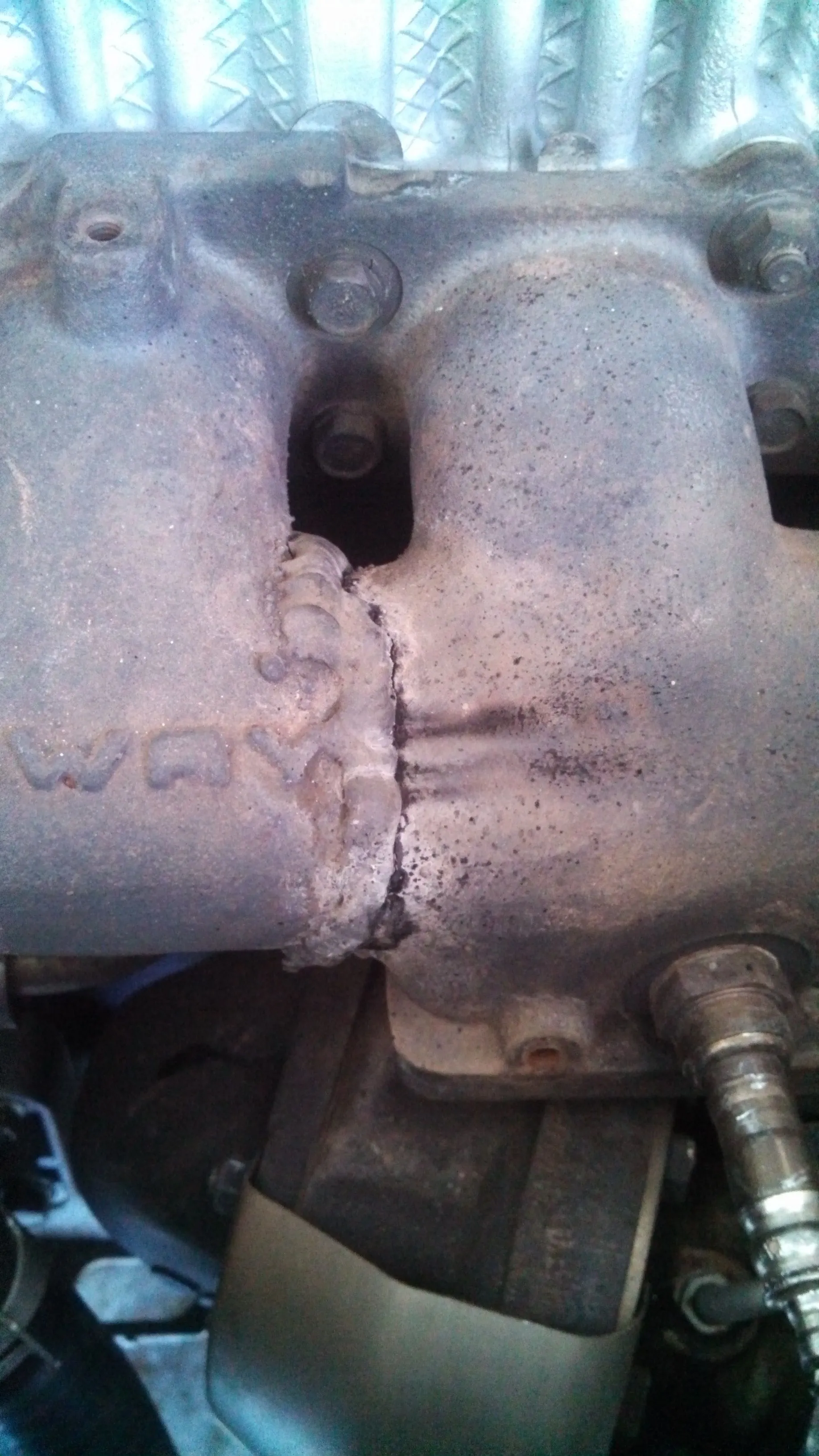

Here is my new MSP i just purchased for $2,000. I did pinpoint inspection on her the past few days. The only things i found were bad vacuum lines which i replaced, a cracked manifold which the new one should be in today, and what looks to be wires cut off a knock sensor. I attached a pic of the sensor or relay with the wires cut, please tell me what it is if you can. I also attached pics of the cracked manifold that was once welded lol, and a pic of the car. I am new to this MSP thing, so any help will be greatly appreciated. Thanks

welcome to the community. post up more pix of your ride when you can. and for starters definitely replace everything u know IS WRONG. before modding anything. that manifold looks horrible lol.
after everything has been repaired. pretty much everyone has the same recommendations for modding. wideband/boostgauge, ssafc to tune, fmic, full exhuast (downpipe if possible) and itll be a night and day difference in performance with the msp. the stock tune is pig-rich/horrible from factory. and definitely replace your stock motor mounts if theyre torn. otherwise youll crack ALMOST any exhuast manifold you buy.

I'd buy that for $2k, nice car man. The 'knock sensor' is actually a ground (may be some type of capacitor for the coils), just snag a pigtail for it from a junkyard and wire it back in.
Thanks hornsfan10609, thats what i was thinking too
