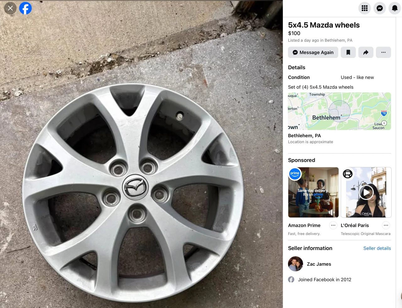

Hey not sure if you will see this but just want to ask a few questions about tire/wheel size. I have a 2009 Mazda 5 Sport so it has the 17" wheels and stock tires are 205/50 R17. All 4 of my tires are shot and I've been putting it off for too long so need to get this figured out. From what I am seeing 17" tires are more expensive and way harder to find used around me. I am considering putting 16" wheels on. I found someone on Facebook Marketplace selling (4) 16" Mazda wheels for only $100 so I'm thinking about picking those up because I know I can find some good used 16" tires or worse case scenario I'd buy new.
Are there any downsides to switching from 17" to 16" wheels? I'm not worried about the speedo being off but I can't find a straight answer as to how it will affect the handling. In my opinion it's a pretty rough ride so I def don't want to make that worse. If I do get these 16" wheels what would the "optimum" tire size be that would give the best ride and handle well? Any help would be a huge help as I need to get this figured out this week hopefully. Thank you!
