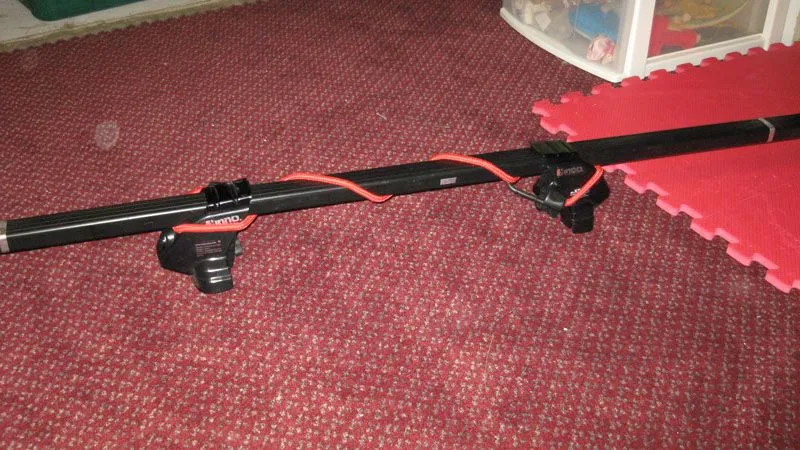

Don't bother with a fairing if you're mounting a box. It'll only make the wind resistance worse. If you're concerned one trick I've learned to reduce wind noise is to wrap a bungee cord around the front rack 5-6 times before mounting the box.
I've got an Inno IN-XR rack coming. Was seriously considering the Sportrack 1300 I posted above because my whole setup would only be $400. A decent Thule box is that much by itself.
I'm not sure I understand what you mean about wrapping the bungee...?

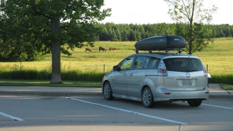

Sorry, I missed your earlier post. Attached is a picture with a short bungee wrapped around the rail. Of course when mounted the stays would be much further apart but you get the idea. I've also attached a picture of the 5 loaded up at a rest stop in Minnesota.
When filling up in Illinois I was directly beside an '09 Touring with the OEM rack mounted. The OEM rack is considerably higher than the Inno but the angle that the racks would hold a cargo box at would be pretty similar. That being said I finally calculated my trip mileage and I averaged 29.3MPG over the whole 6000Km trip. Not bad considering how large the Thule box I own is and how much heavy headwind I drove into.
I'm not sure I under the physics behind this- why would wrapping a cord around the crossbeam make any kind of difference??
I'm not sure exactly what it accomplishes either but I've heard about this from too many sources to discredit the idea completely. My guess would be that it provides the air that hits the bar with a suggested direction of travel. I only took 1st-year physics though so I'm no expert. Maybe it's another urban myth.
