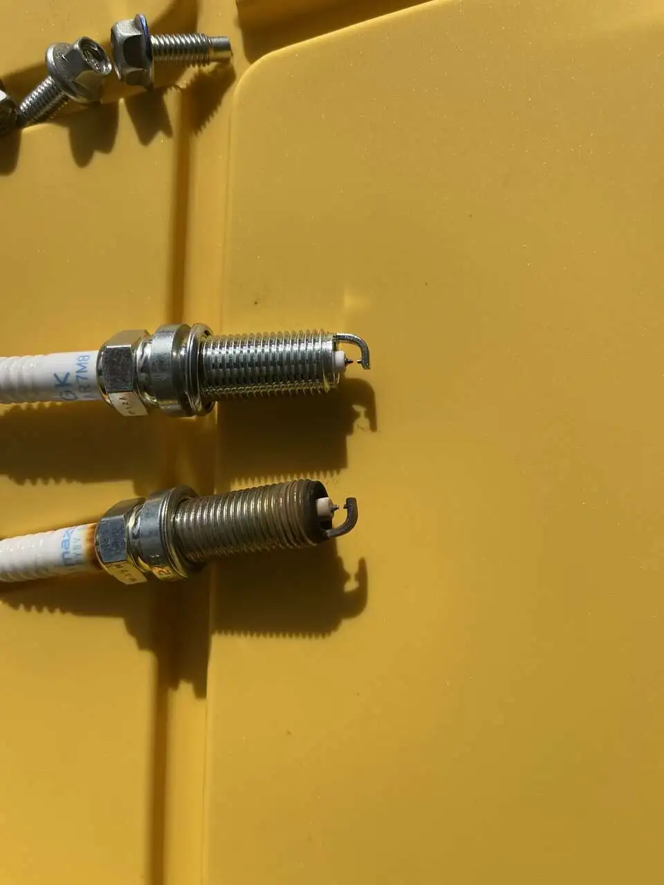

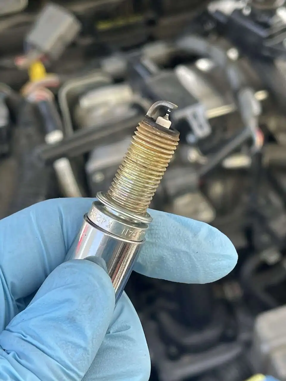

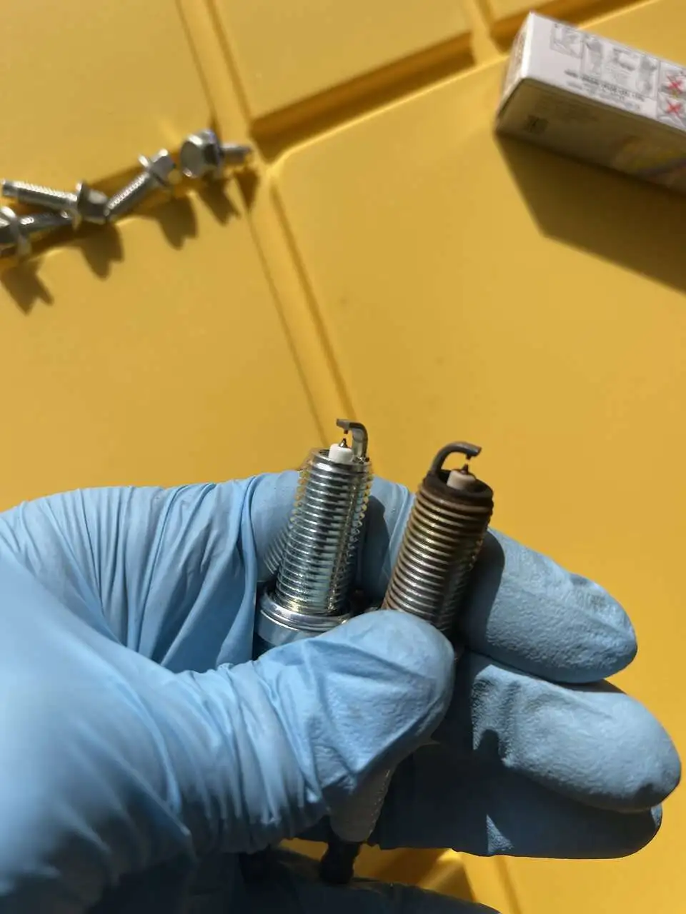

Replaced CX-5 Turbo’s Spark Plugs
…at 40,700 miles, as per owner’s manual.

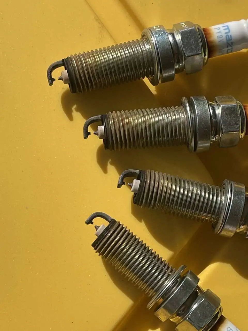

The tips look like they could have gone one heck of a lot longer/further, but I suppose there’s a concern that the ceramic insulator is the weak point.

the iridium tip usually shortens/degrades faster with the turbo cx5 then mpg may start to suffer, misfires,etc. 40-50k is the avg lifespan in those. Mazda is a bit conservative but thats good. given its about 120$ for 40,00 miles not bad.

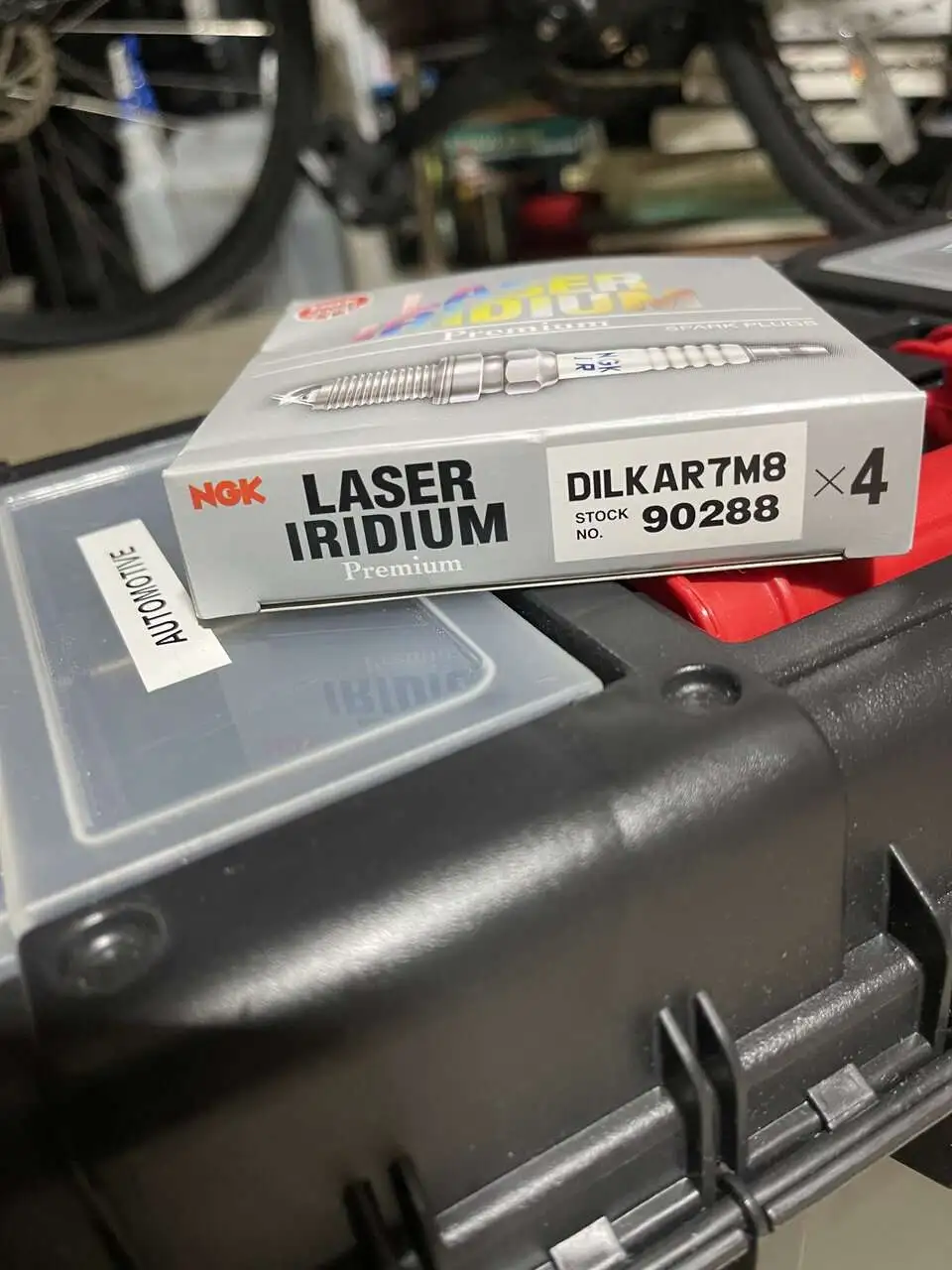

I got NGKs from Advance Auto. With discount code, the total was less than $70.00.

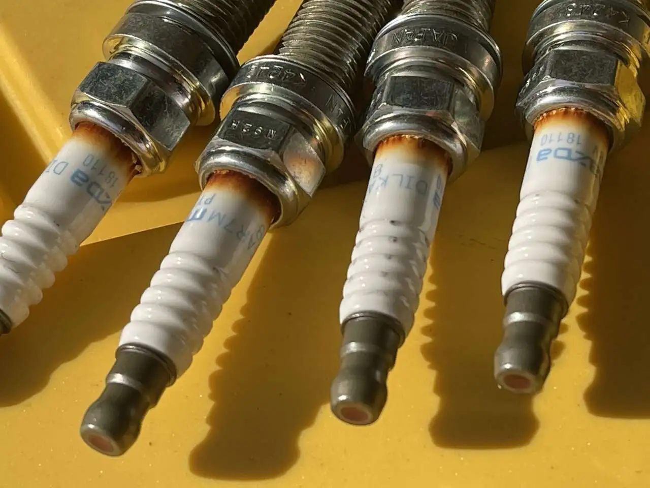

The part number on Mazda OEM spark plug for the 2.5T is PY8V-18-110. I was wondering if the Mazda OEM plugs you removed have the “NGK” and “DILKAR7M8” imprint on the ceramic insulator?

The tips look like they could have gone one heck of a lot longer/further, but I suppose there’s a concern that the ceramic insulator is the weak point.View attachment 314491View attachment 314492View attachment 314493View attachment 314495
