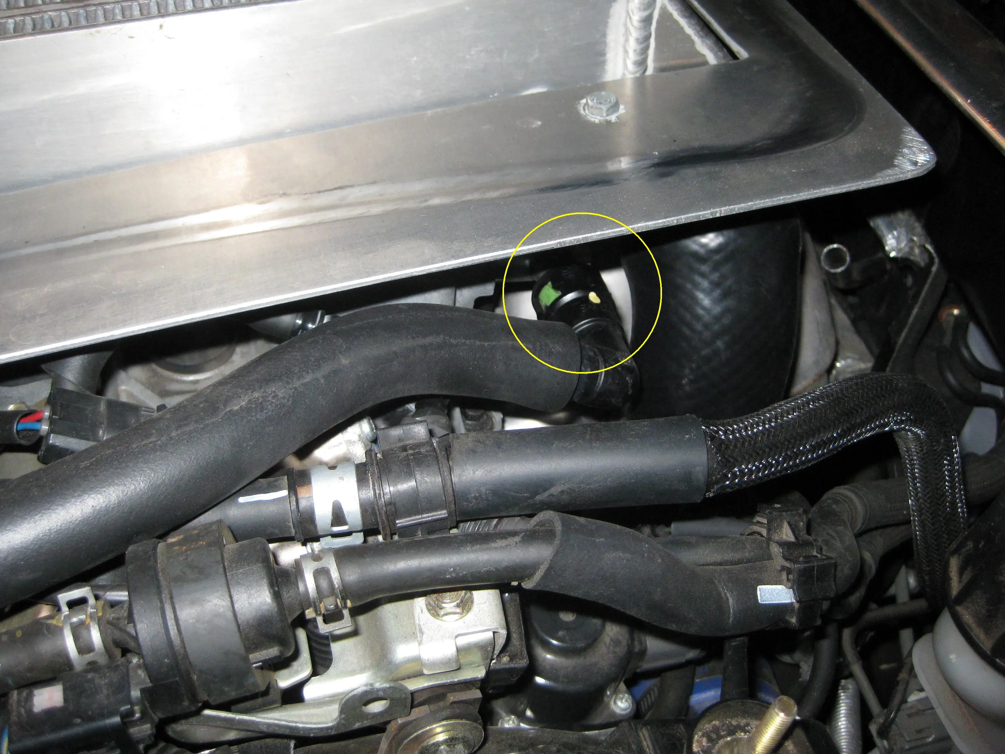

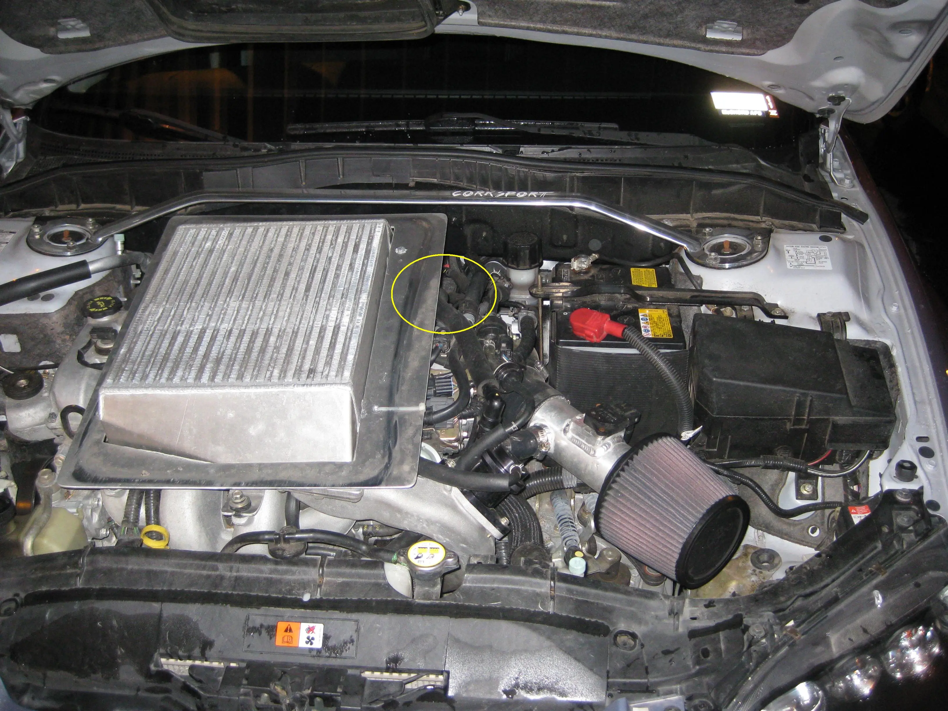

thanks man i might try this can you send me a Pic of where the PCV is or where this would go. or is it say in the kit on the MS6. Thank a lot man was hoping i didn't have to put my @nd cat back in.
Here you go.
Picture 1: Overall view of the engine bay, circled area that is enlarged in second picture
Picture 2: Where the part goes. Remove the hose from the fitting, slide in the part, replace the hose. Real easy.
Hope this helps!

Well, if it comes up again, try the fix that I posted before you turn it in to the dealer again. I let my car idle for about half an hour last night and I had zero smoking. That's in 40 degree weather, 5w30 in the engine, and a catless Corksport exhaust (because I'm hardcore like that. :P )
I'm still on the original turbo, as well.
