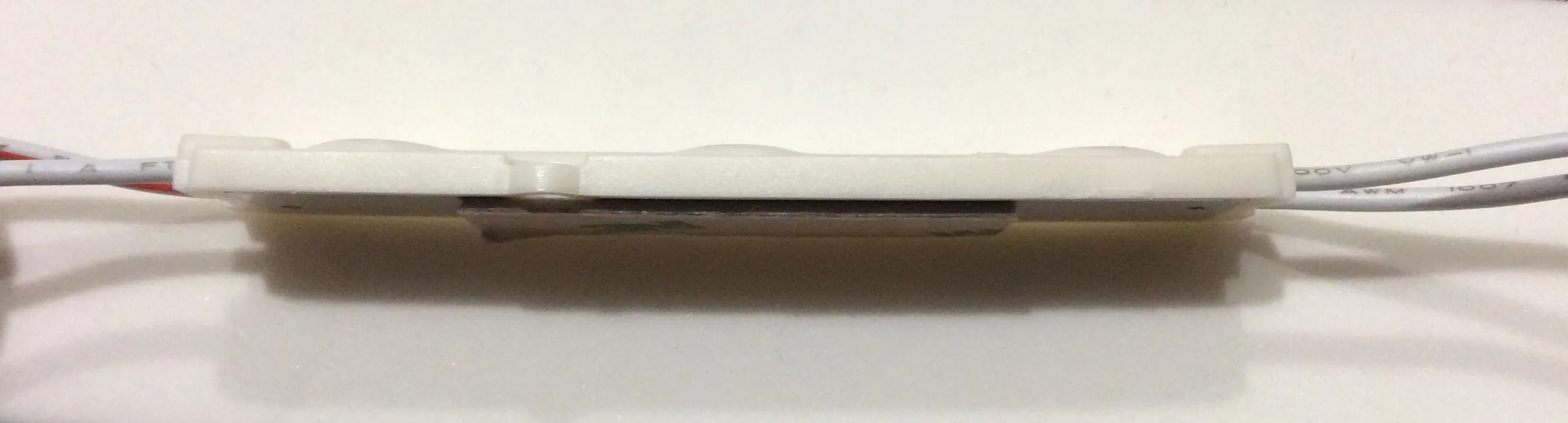

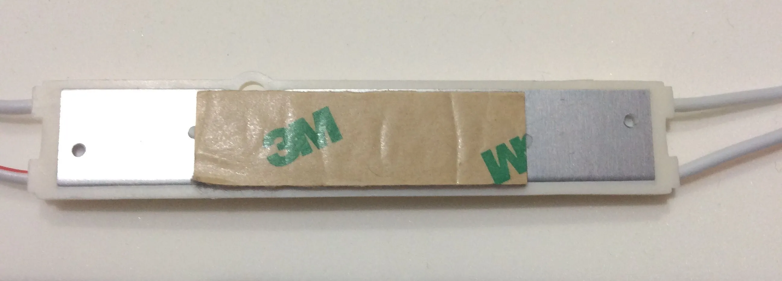

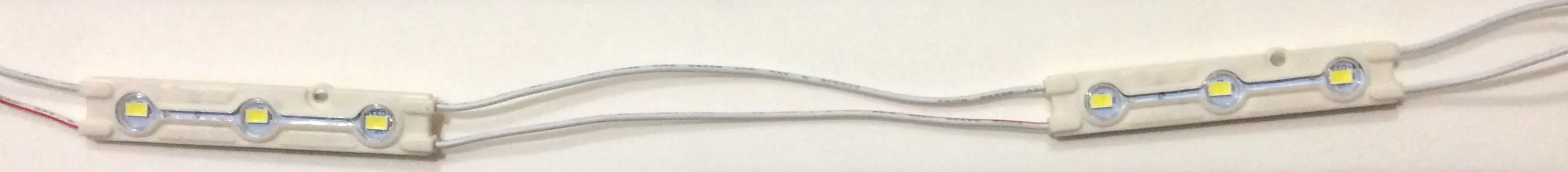

This is what I have two, two set Module LED 5037 bright white and water proof. That I was thinking of attaching with the 3M VHB tape under the door lip inside the weather striping facing straight down, or in the two indentations along the bottom of the door, outside the weather striping. The hardest part and what I've been searching is for the wiring. I want it to come on / off with the diming of the dome lights.
All I can find is that I would have to run wires back to the drivers side trunk area. And tap into them there as the wiring harness looks to be ran through the roof area. Unless someone knows how another way. Information came from other posts for lighting the door CX 5 door plates...
Photo of the LED I have, they are for channel littering for signage. For back light company signs on buildings..
