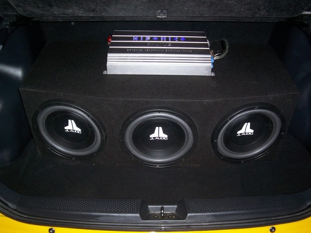

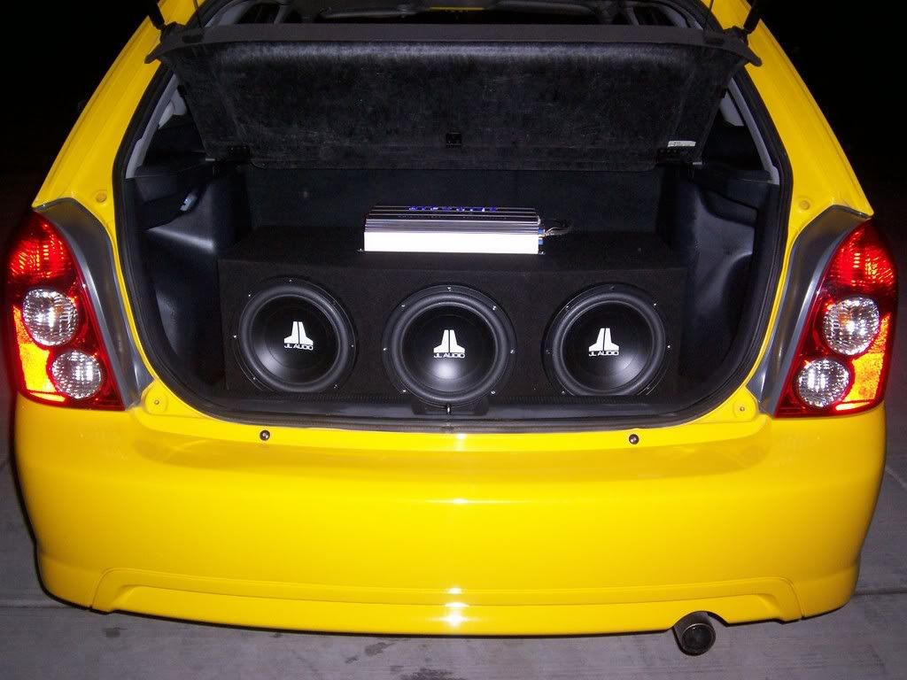

Not a sedan, but this is how i did it.. im not sure if you have enough room as my old p5, but from what i remember from my friends sedan, we had just about the same amount of space width wise.. (someone correct me if im wrong though..) Hope this helps!!

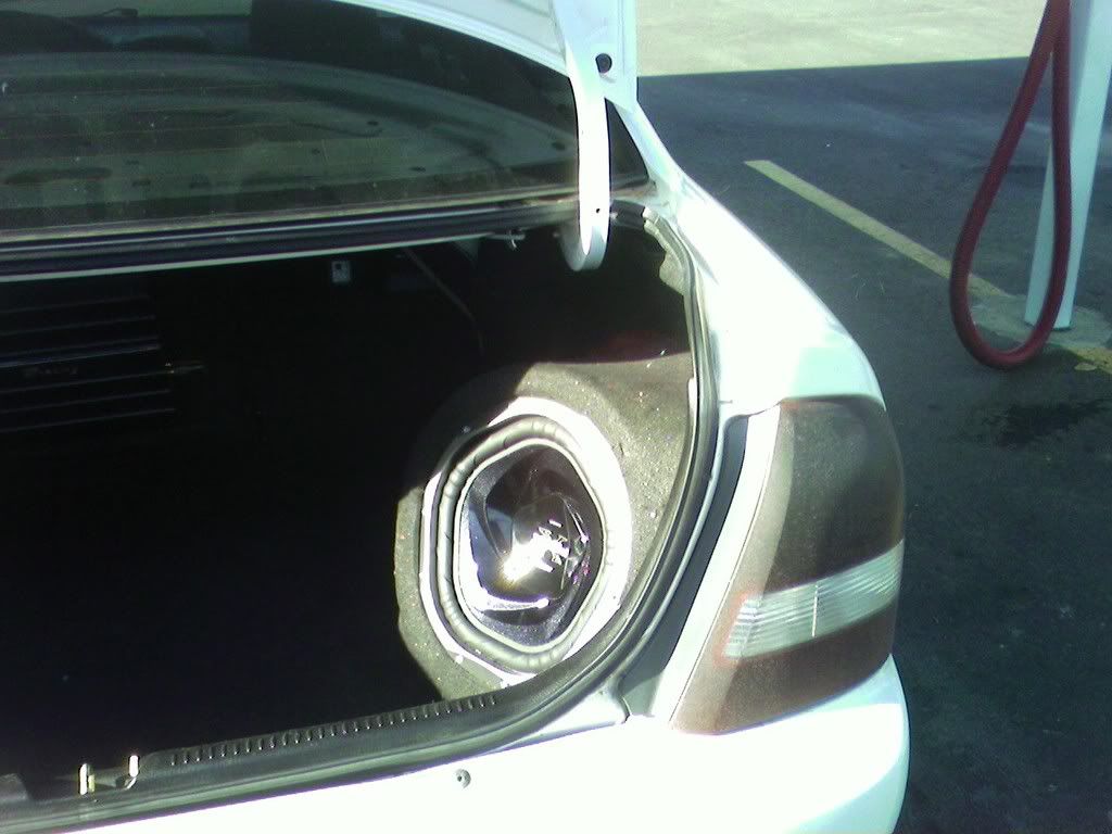

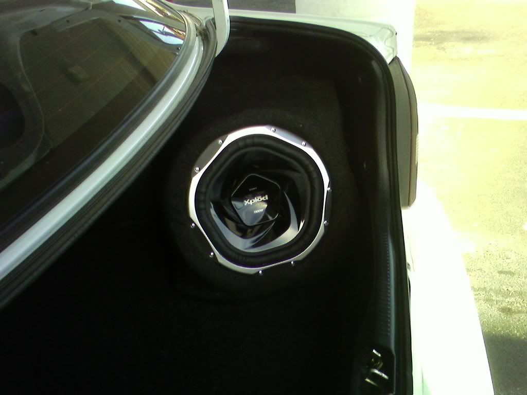

I made a fg box for mine that fits in the rear of the trunk near the pass side taillight. I also made an almost identical box for my maxima, but on the drivers side. For a sedan, I would always recommend facing the subs toward the rear...you'll get much better sound...
Facing the rear usually produces the best results in a sedan with corner placement coming in a close second. You can face them forward too, but if you do that you must create a baffle to seal off the front of the woofer from the trunk so that it fires only into the cabin.

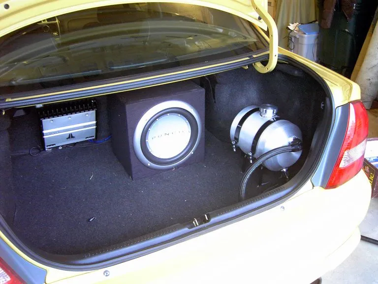

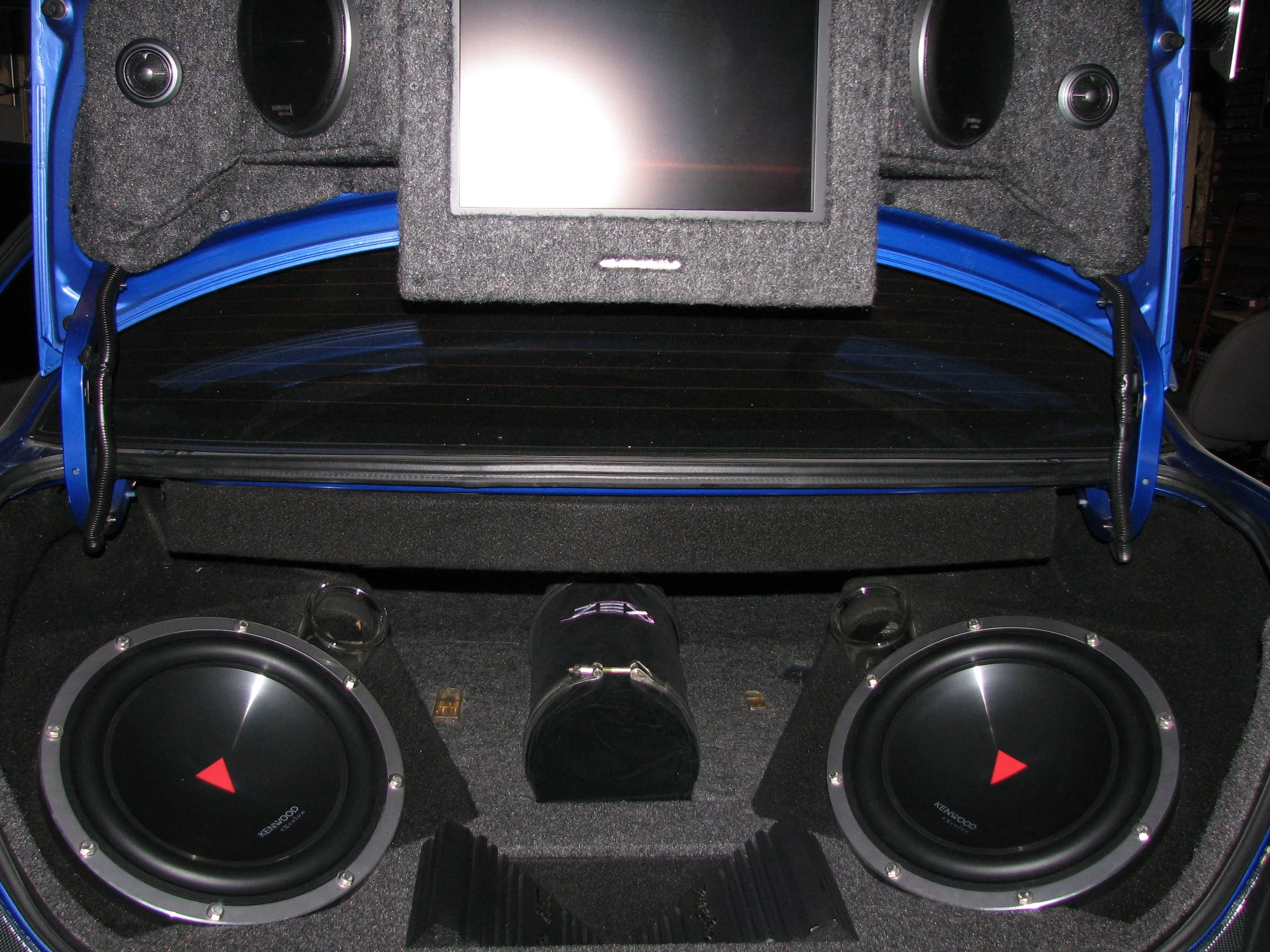

mines facing rear. sorry for the bad pic its all i have at the moment.
