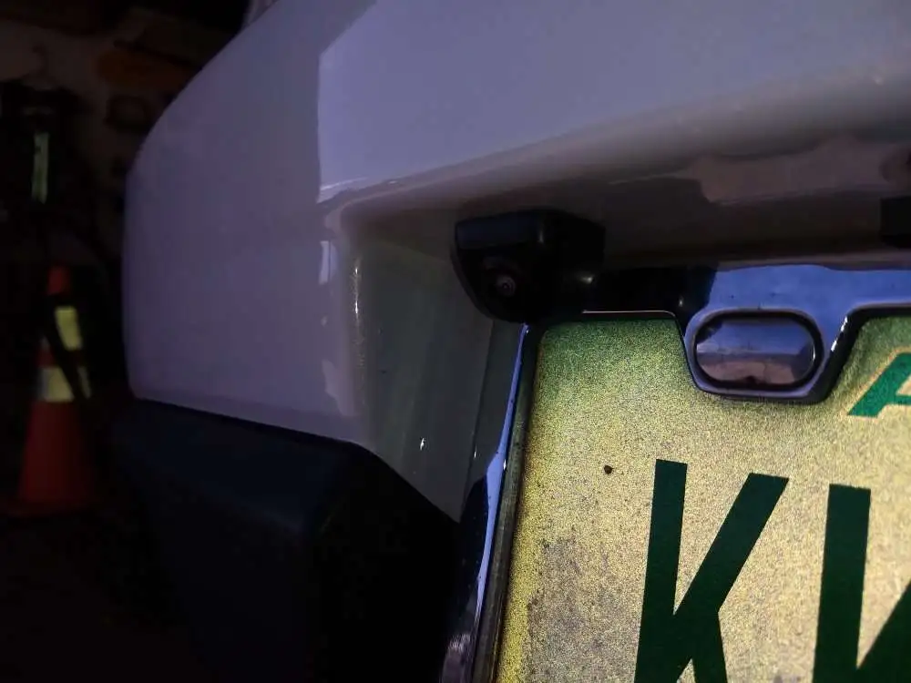

Same positioning as mine, then. I just pulled the plastic trunk panel off the passenger side (or whichever side you ran your wires) and used a tap on the reverse light wire.
I bought a Natika WD-011. It's a factory look camera with a stainless steel post and nut. The connector is a slim plug rather than the typical RCA type so it passes through much smaller holes, and it only requires an electrical tap into one of the backup lights for power and activation, then sends the video signal and trigger up to the head unit. It has on-screen guide lines you can leave or omit, and can be mounted under a horizontal surface or on a rear-facing vertical surface.
It's not the highest resolution but it works well in low light conditions.
It also came nicely packaged with three different gaskets to adjust the mounting angle, a nice trim removal tool, electrical tape, and a 'Thank You' card.
