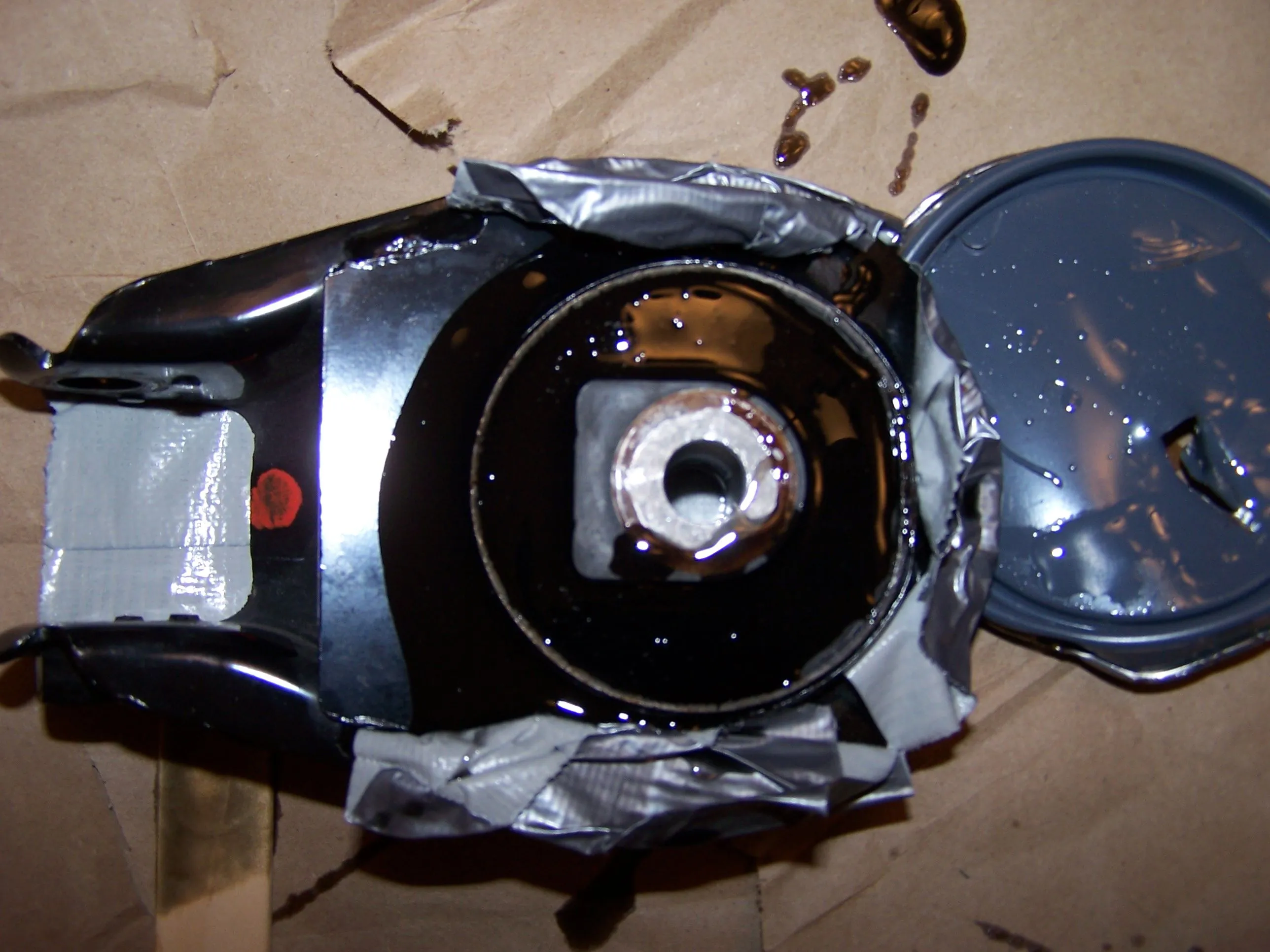

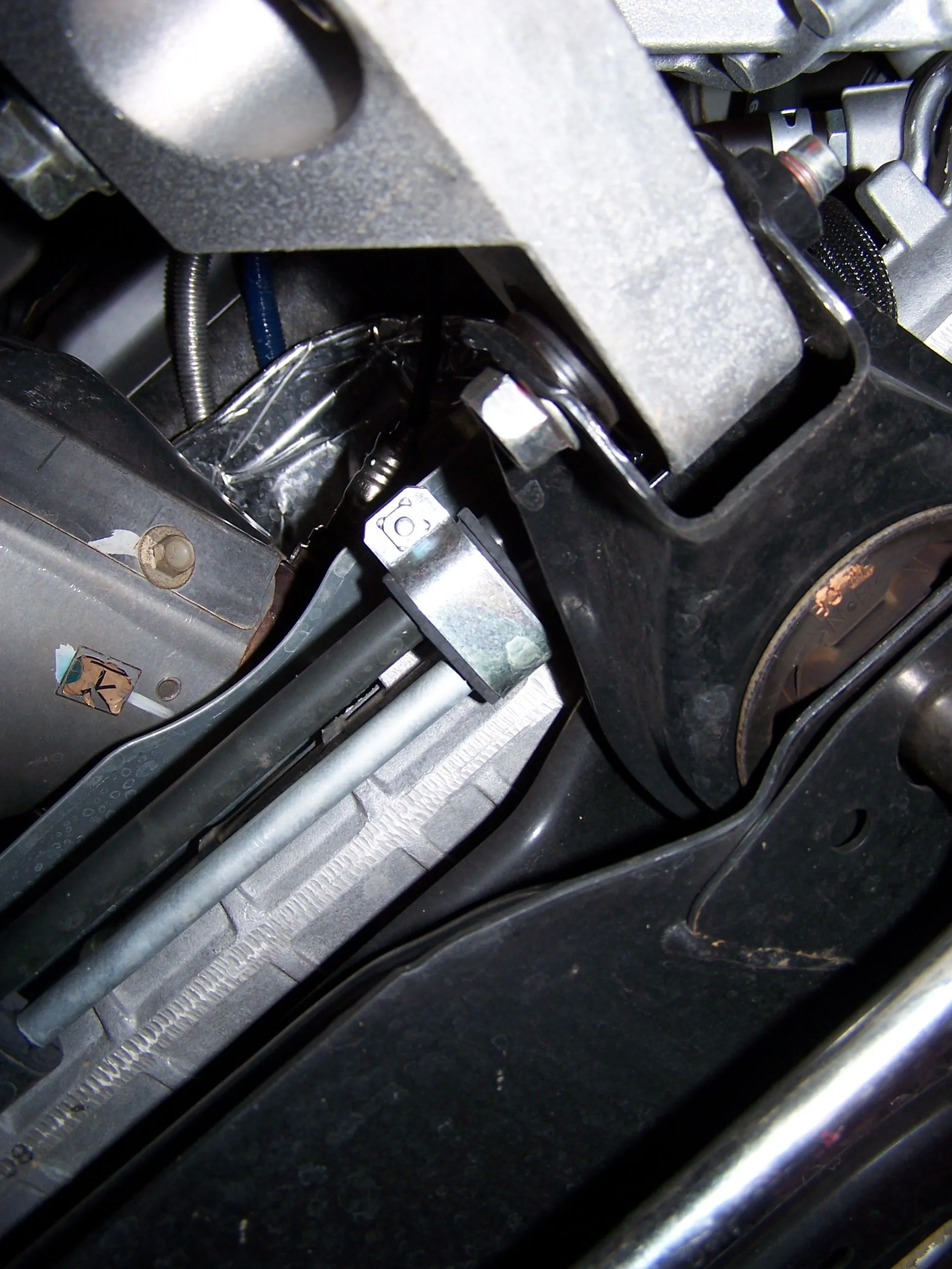

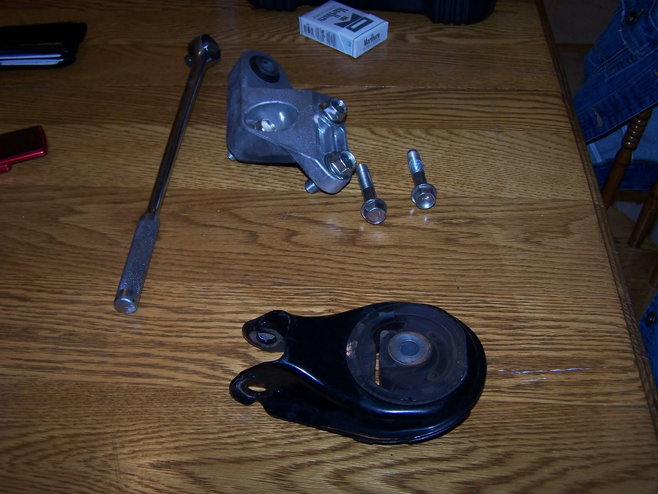

Was look at some other forums and people have been makin there own MM.
SRT-4 neons and hondas are using Flexible urethane casting compound .

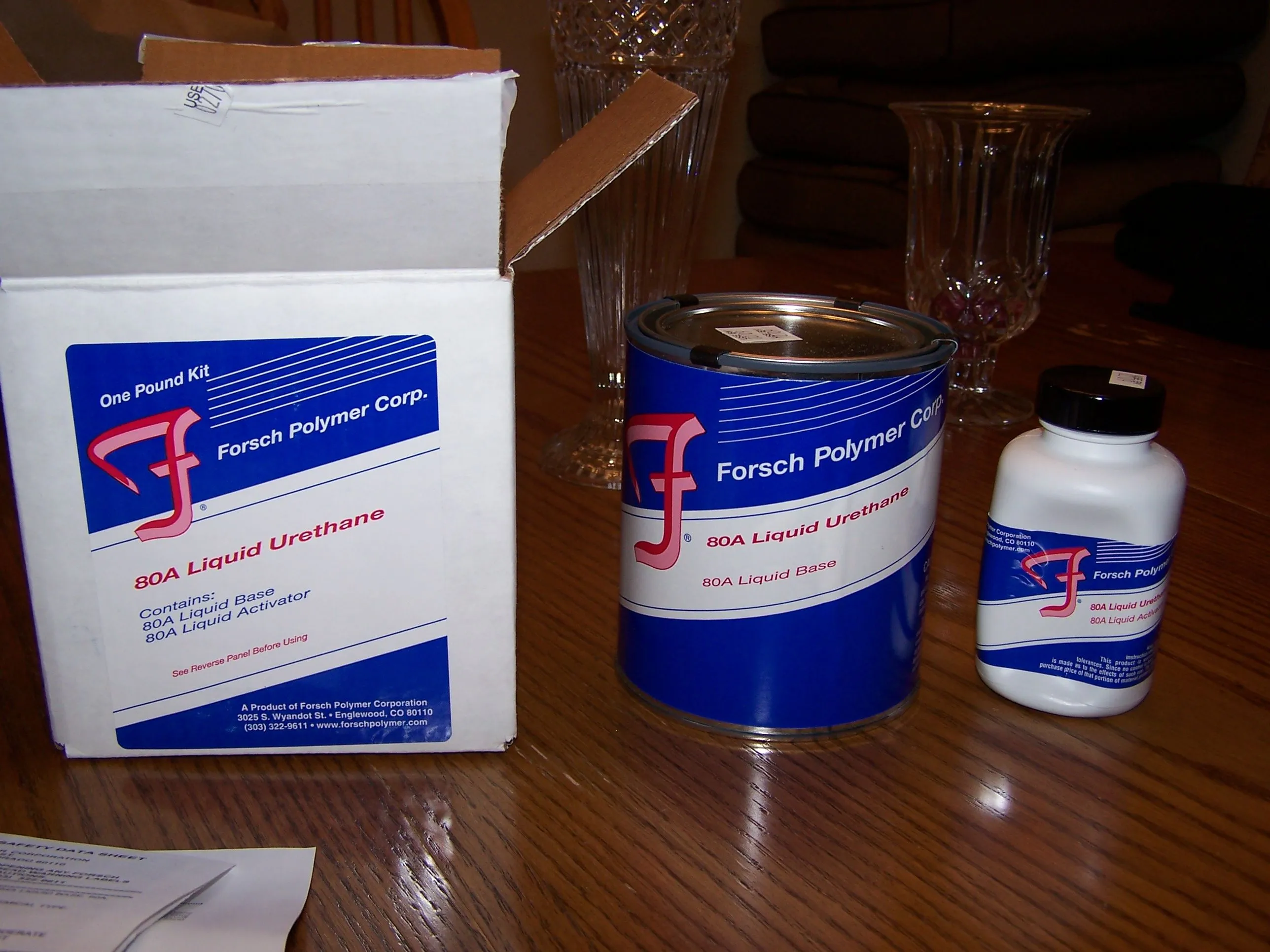

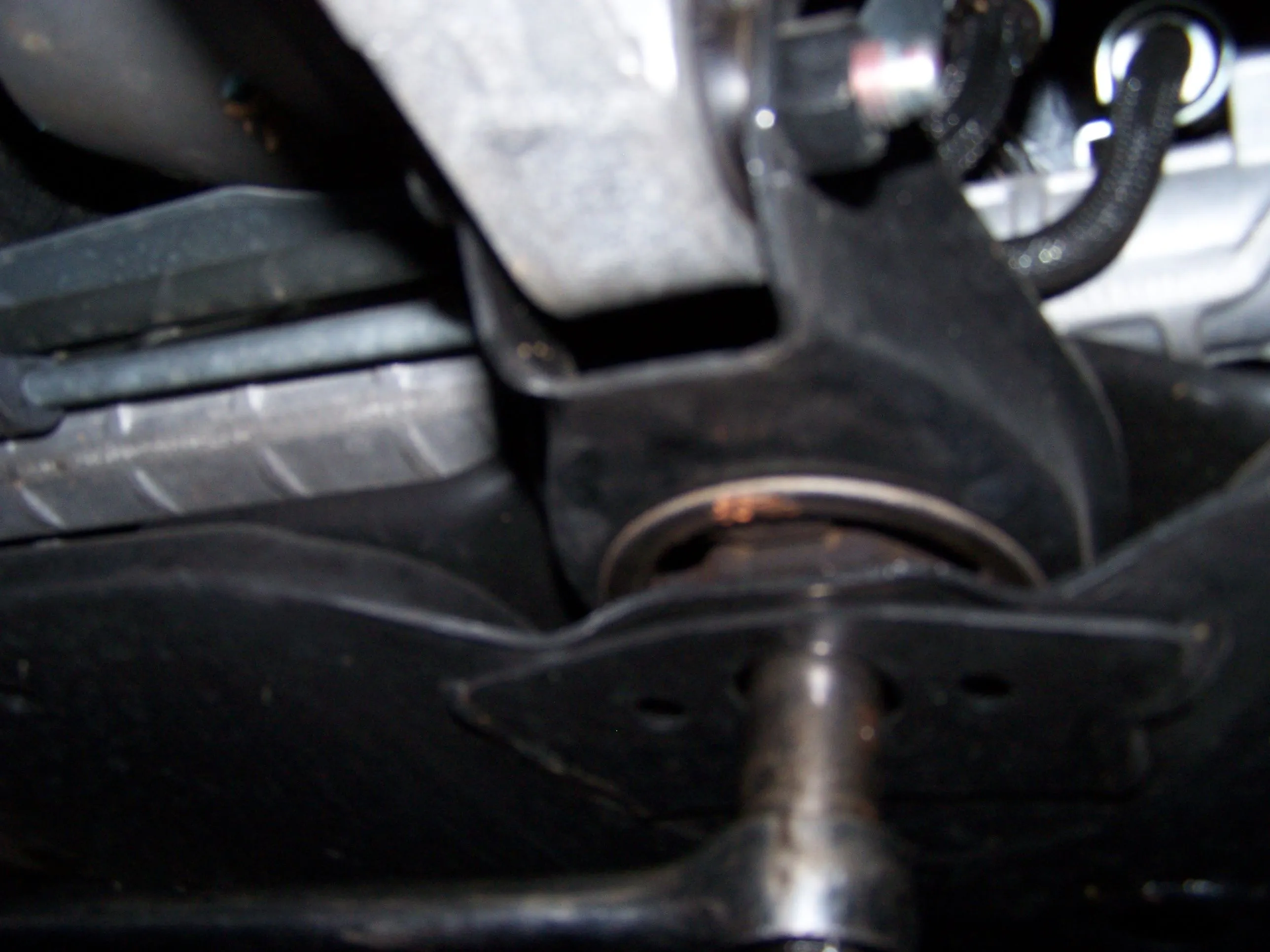

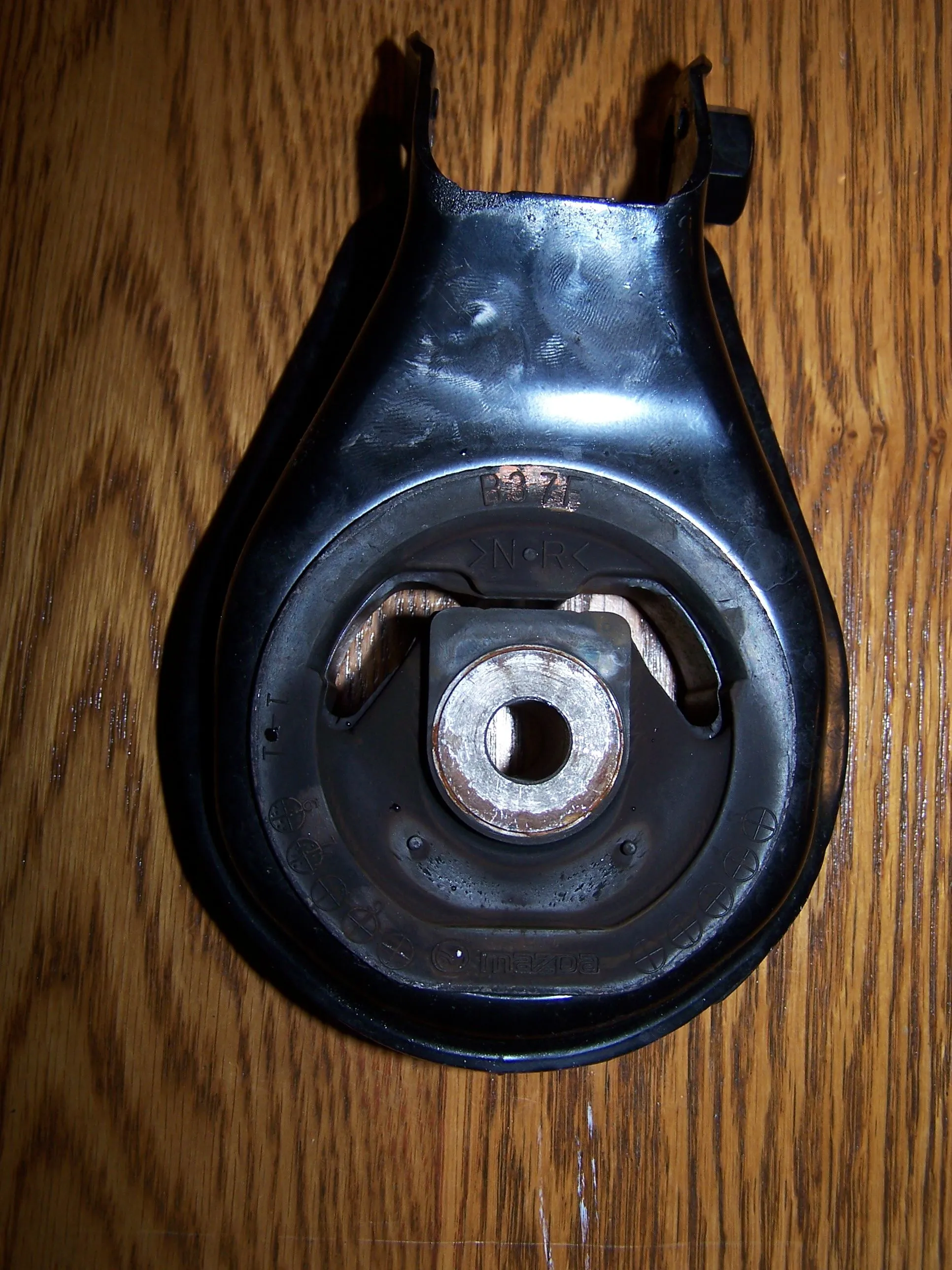

Shore A 80 Black I orded today from McMasters.com 28.83 shiped and it can do two mounts. Have to wait 48 hours to dry i will update when done. These are some pics of the stock mount if you go down the page you will see how I poured the poly in the mount

Urethane Motor mount
Flexible Urethane Offers high tensile strength, plus it's highly flexible, pliable, and water and abrasion resistant.
-40 to +180 F 10-20 48 Hours Black 0.0005"
60A 1250 25 1 8644K24 $32.33
60A 1250 250 10 8644K26 $212.78
80A 1725 25 1 8644K11 $28.83 This is the one iam getting
80A 1725 250 10 8644K12 $190.83
94A 3120 25 1 8644K18 $32.33
This is the site info on the Urethane. I have seen some pics of the honda and srt-4 mounts they look good. Go to mcmaster.com and find products and type in 8644K11 that is 80A little harder than the 60A.

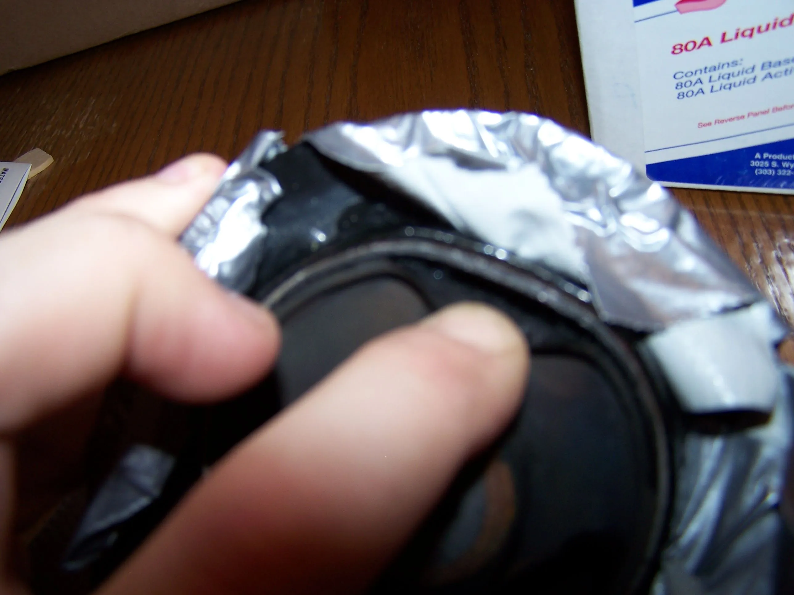

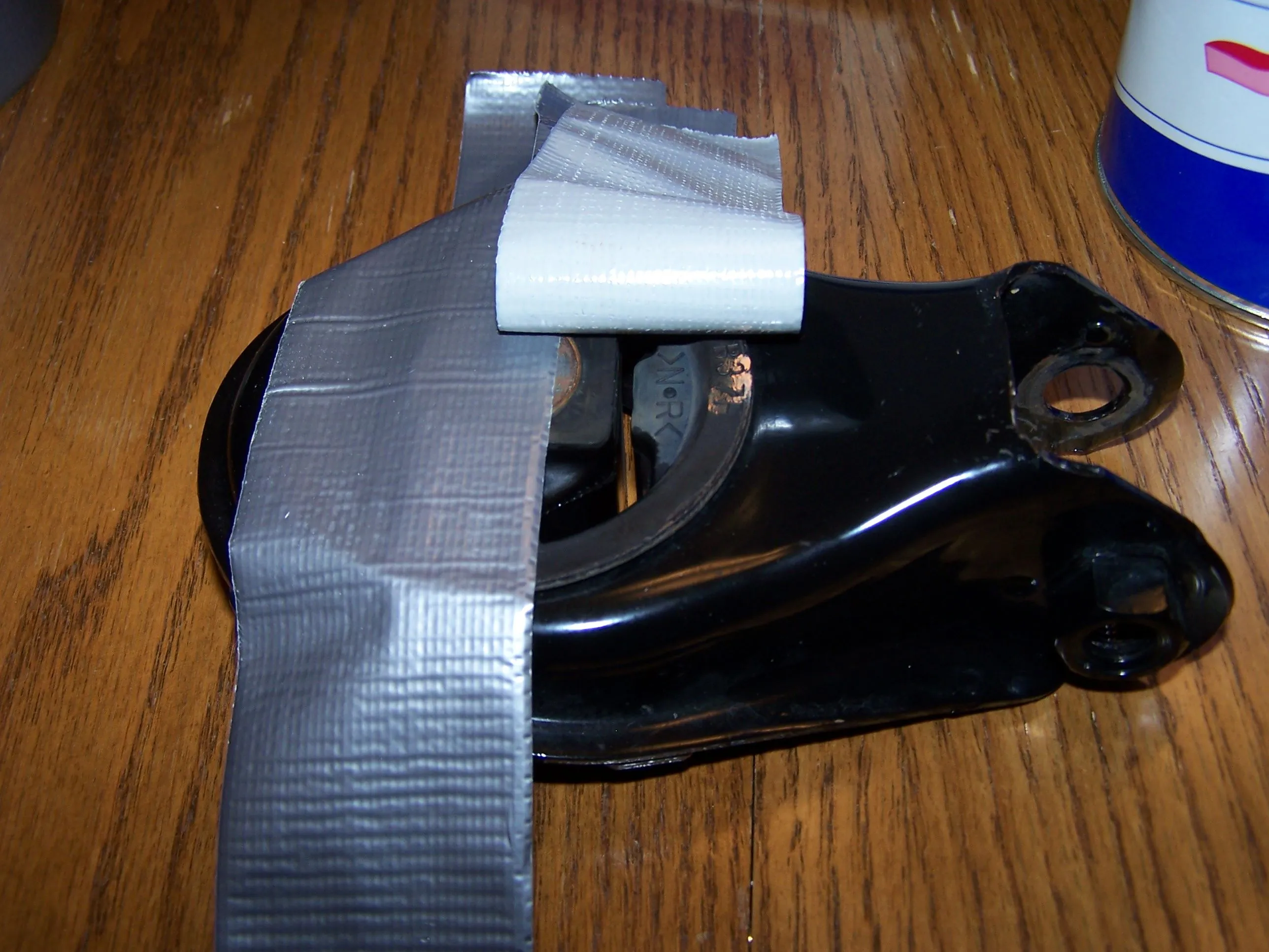

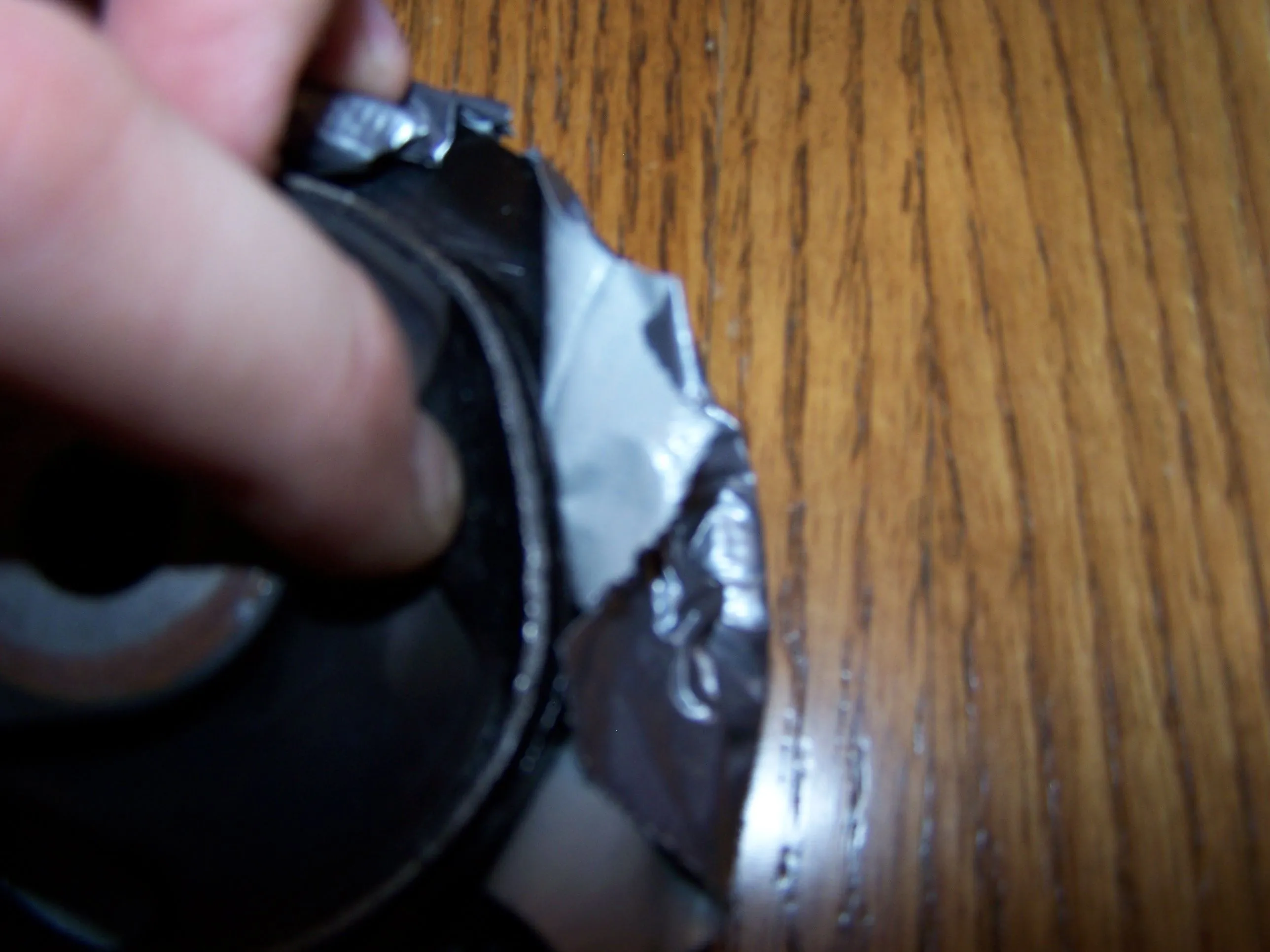

Got the stuff to do the mount

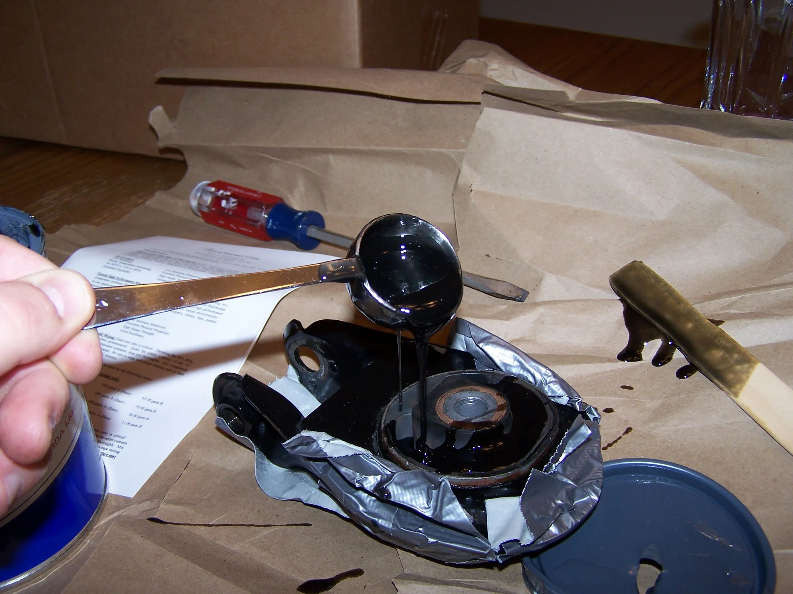

Took duck tap tapped one side off and poured the poly in now got to wait 48 hours to dry www.mcmaster.com 80A If you look at some of the pics my stock mount was starting to break. I hope the poly will fix it ? Will update when drys

maybe a stupid question but i'm used to it. Did you just pour the poly over the orig mount? or did you dig it out?
mount
You dont need to dig it corksport sell a poly insert. That has two side and you push them in so I said what the hell i will pour my own. Its drying now come on 48 hours.
i actually did the same thing, learned it from the teg lol, and i would recommend this one to anyone with downtime. but now i shelled out for a one piece mount when i got the ETD.
I've done this before on my SE-R, however after a while, the material cracked. Dont know if it was my fault or not when I poured it and I did do ALOT of hard launches on nitrous. I forget which hardness I had. Overall though, I was very satisfied since at the time there were no engine mount inserts available.
