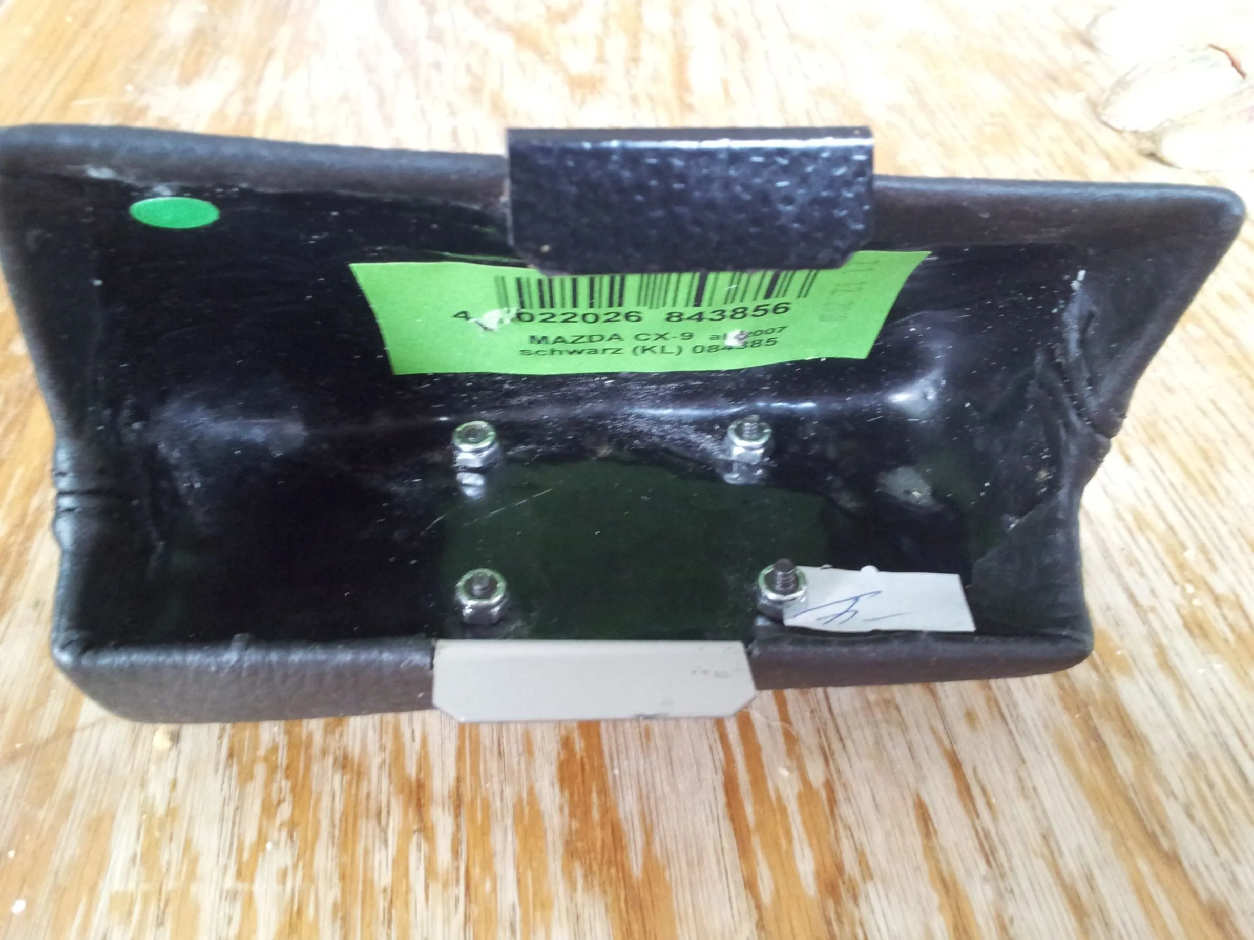

Looking to see if I can drill into the KUDA and install bolts and nuts to better secure the holder onto the KUDA bracket. Only concern is how much room I have between the bracket and the trim piece so that I do not touch the trim piece with the metal hardware. Not really sure if I like the adhesive pads to install the Holder to the Bracket.

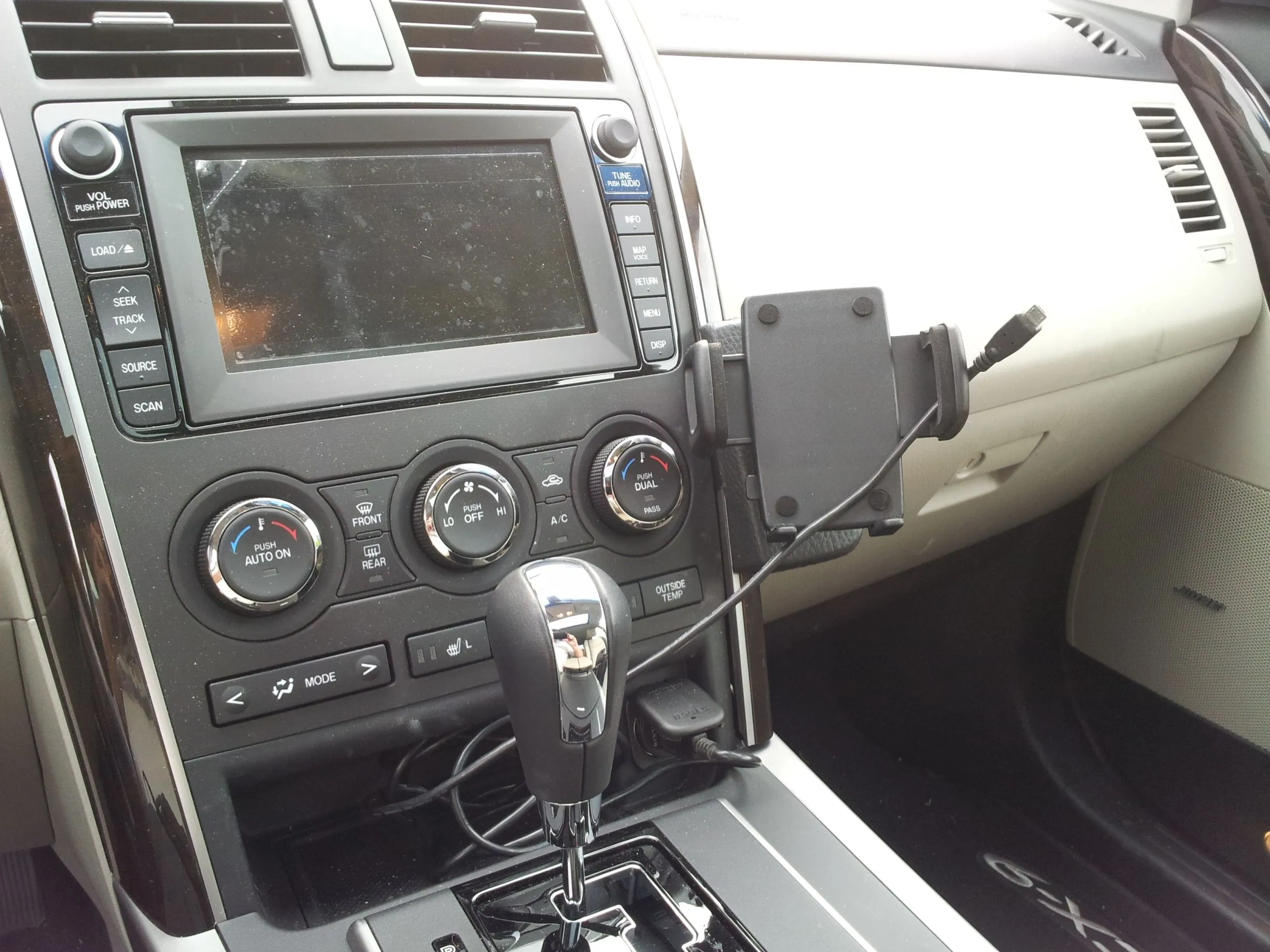

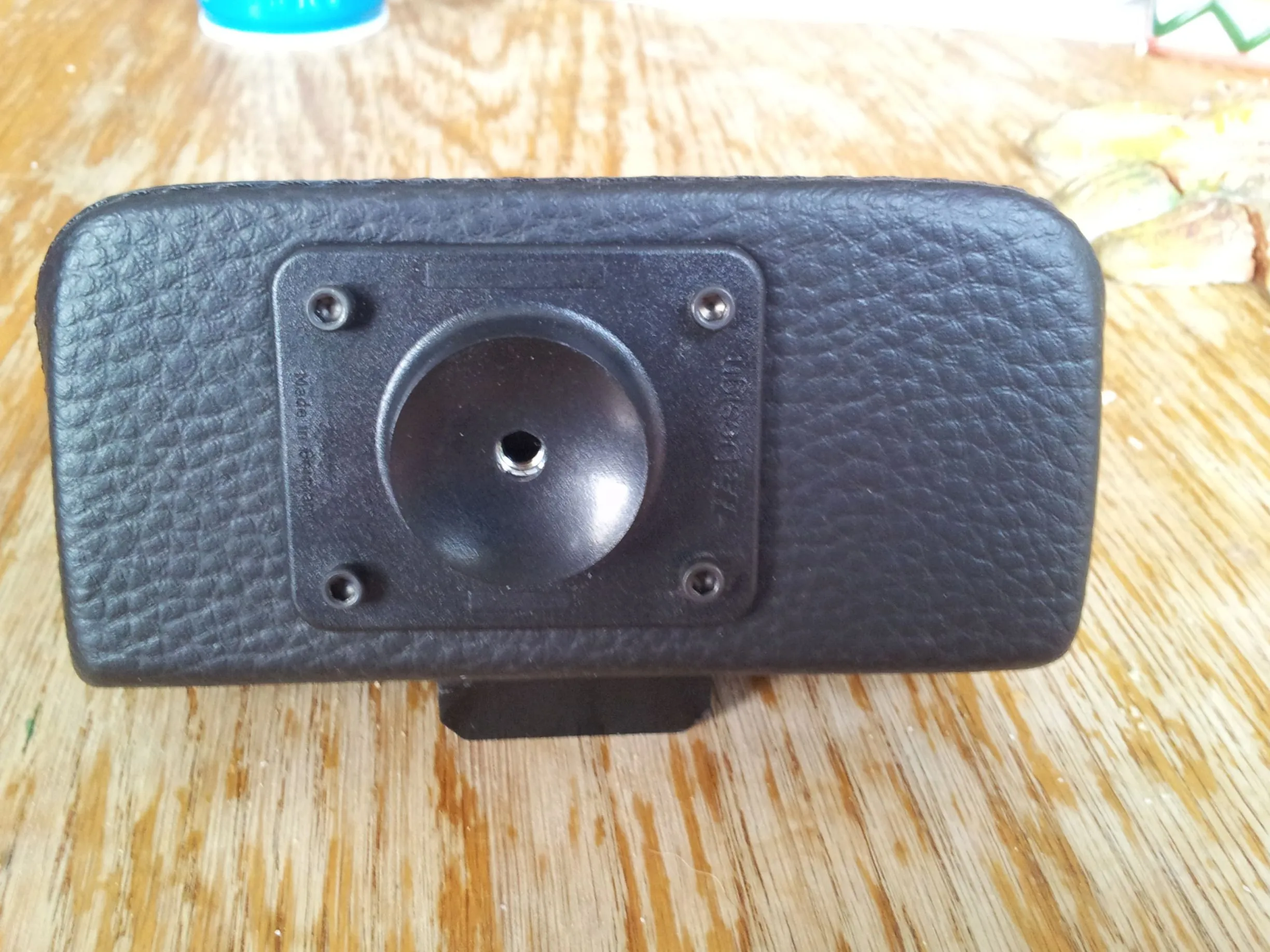

So I got the package from KUDA the other day.
Waited tell today to install the unit into the vehicle along with the Universal holder and mount.
It came with a couple of adhesive Pads and I not a big fan of using adhesive in South Texas as it can get pretty hot in a vehicle during the summer months.
Drilled 4 holes into the holder and used some Socket 4/40 bolts and locking nuts to secure the mount to the KUDA fixture.
Then secured the Universal Holder to the Mount.
Here are some pictures of the Mount with the hardware attached to the Kuda and the Whole unit installed in the Vehicle.

Kuda, nice. I like the Kuda in our 2012 CX-9. Places the phone in an optimal location, in my opinion.
