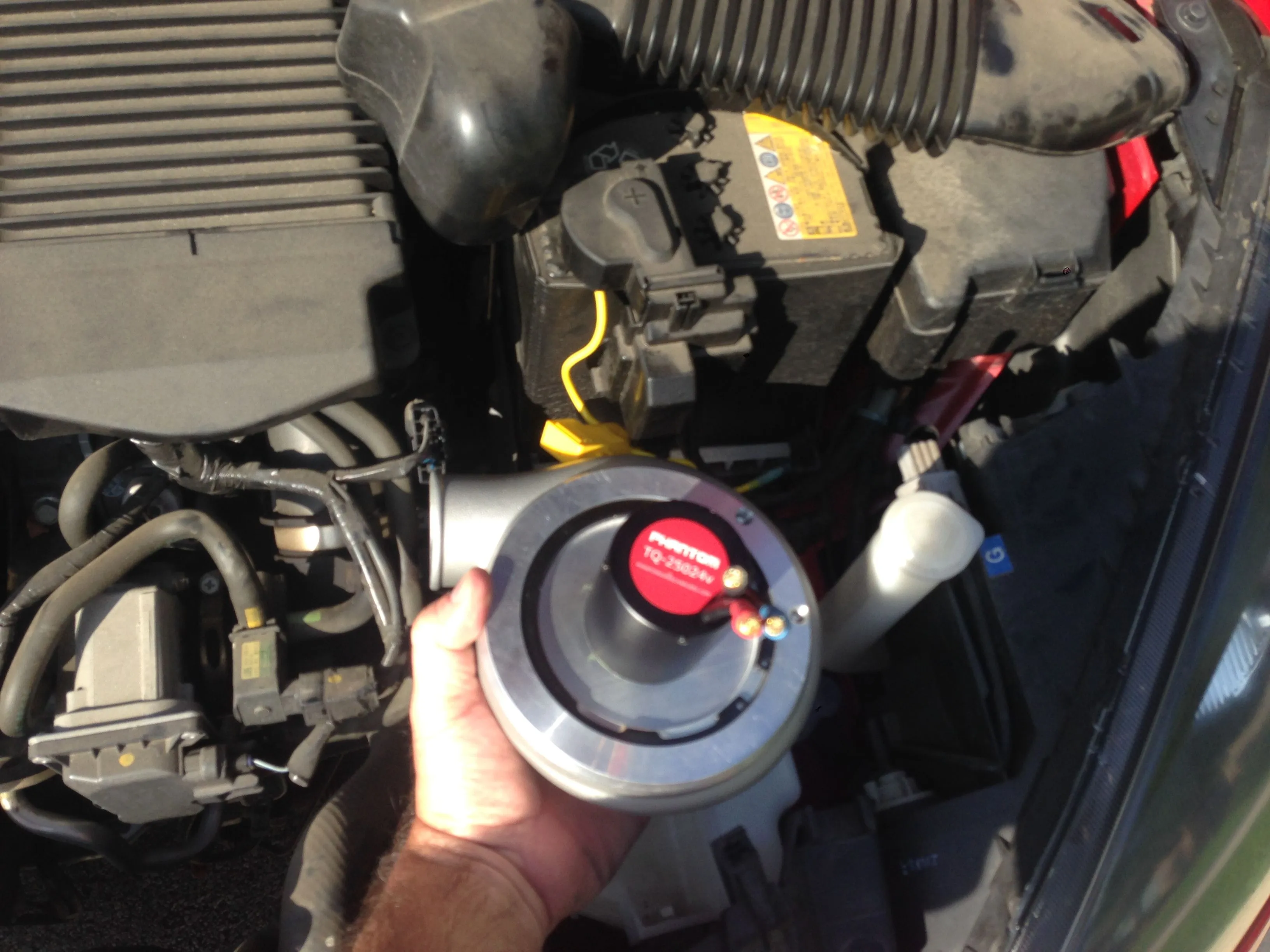

I got my Phantom Electric Supercharger in the mail yesterday and before I installed it into my Miata did a quick overview of the Mazda2 Engine bay. It looks like there is plenty of room in here for the supercharger. It looks like a strong candidate. I've emailed phantom to find out the cost on a developers kit to play with....
You peaked my interest, so I got a nice cold beverage and read the entire 20 something page post on the other forum.. This could be the next big thing. Easy to install, support on tuning (Both from The developer and from Joe(he mentioned he could develope a map no problem)), and low cost. Any estimation of HP increase in the 2? At 5psi non restricted (giving a claimednet of 7psi) I would think at 30% increase would be easy, but if we could get 50hp at the flick of a switch, that would be something...2200lbs, and 140whp would net a 0-60 in the 6 second range.
