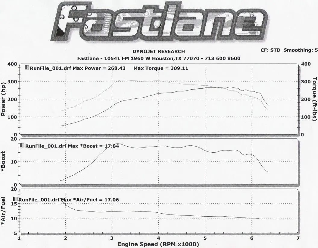

here is a copy of my dyno with the wide band connected at 18psi. do you see and signs of a lean condition or running out of fuel?? this is why its hard for me to believe that a larger fuel pump on the stock turbo will do any good. Im thinking this larger fuel pump you guys are getting is just a band aide for a simple tunning issue that can be fixed using the stock fuel pump/ any ideas??
Hey nig I think the stock pump had a big lean hump at the onset of boost. Your tuner smoothed yours out well but you still have a 13:1 at 3000 and even a tad leaner aproaching 3500. The bigger pumps seem to be able to get this number down in the 12's sooner. You peak your boost at 17.84 at 3200 the sime point you have a 13.5:1 afr down low.
look closer, the small dots arent consistent with the marks at the end of the graph. my car is closer to 12:1 afr at peak boost, thats fine for these motors and BTW im running stock ecu with no tune.
Also i just data logged my car several times with the snap on modis scanner and, even after turning the boost back up to 18+psi i couldnt get the car to sputter, pfhhh... that figures hahaaha! anyways even at 18+psi the car showed no sign of loosing fuel pressure and the afr's looked fine. I really think this is a tuning issue rather than a lack of fuel issue. The pump your using is just dumpping more fuel in to bandaide somthing a reflash or EM could fix. NOT SURE THOUGH HOPE TO FIND OUT SOON
your not making enough power to run out of fuel. 270whp is low for 18psi and whatever else mods you have on there.
well the dyno i was ran on a stock ms3 put down like 23owhp so im pretty sure im making enough power. hell on a dynodynamics dyno i would be right around the 300whp range.
so you made 40whp over stock and you think your going to run out of fuel? Im not a fan of dynoes anyway, but trust me. Your simply not makign enough power. What exactly are your mods.
