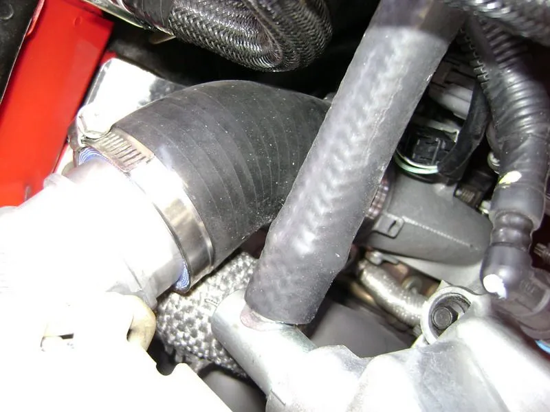

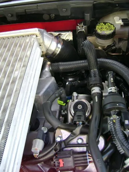

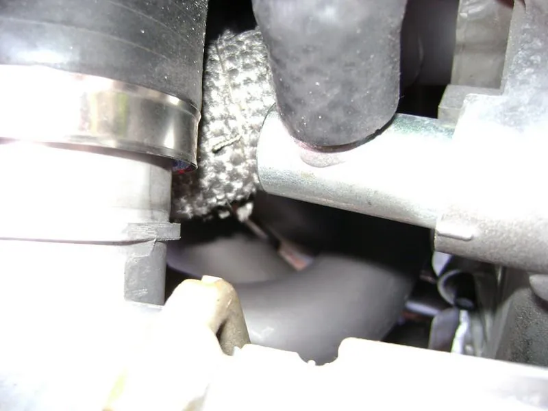

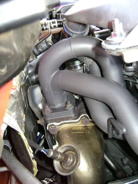

OK i am posting the optimal solution photos for the PG manifold install with minimal modification and easy,simple make shift adaptation and no problem results.Car has been run and tested for 700 miles under hot climate conditions.
Just heat wrap manifold runner next to intercooler hose.
Shorten hose to minimum or max it out as seen and clamp as usual at very edges.Done no need to raise intercooler or get a big hose.No errors or complications or CEL as a result of it.
