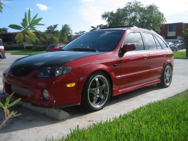

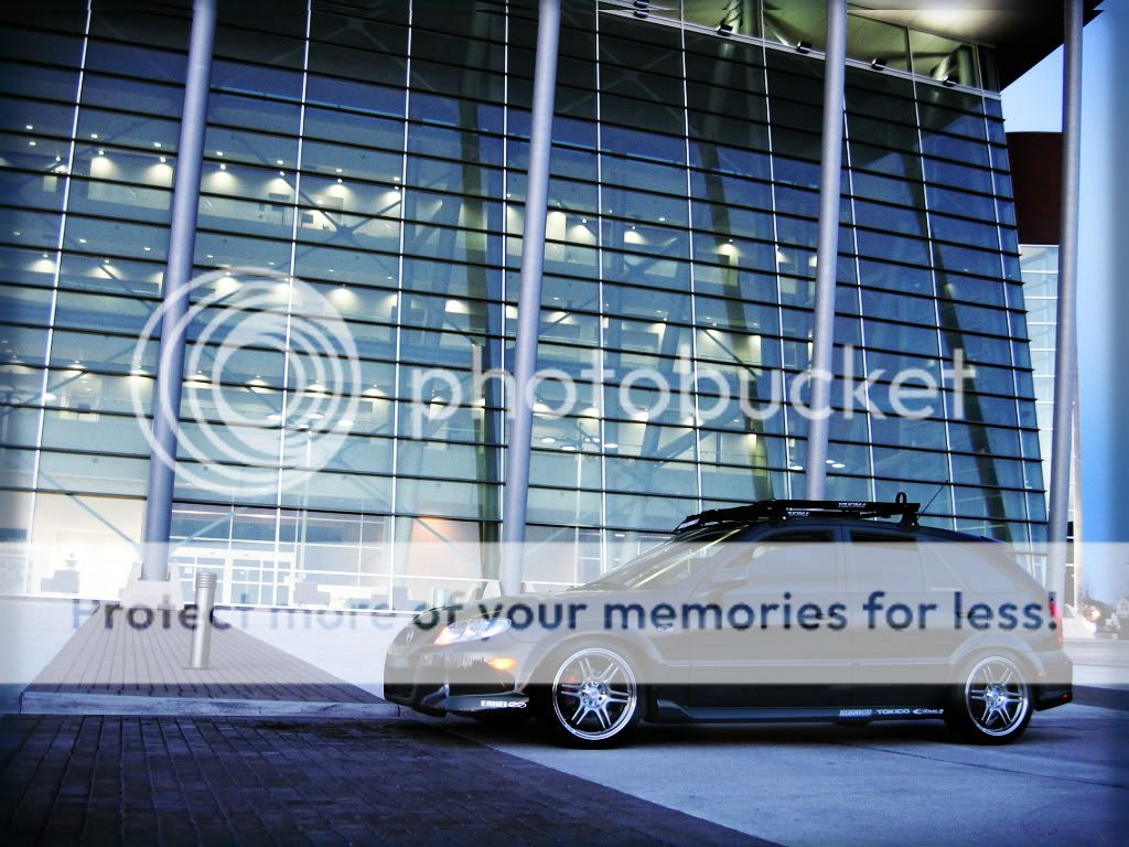

I posted some other pics in the photo/video section and somebody photoshopped one of them to make the car look lower. Here it is:

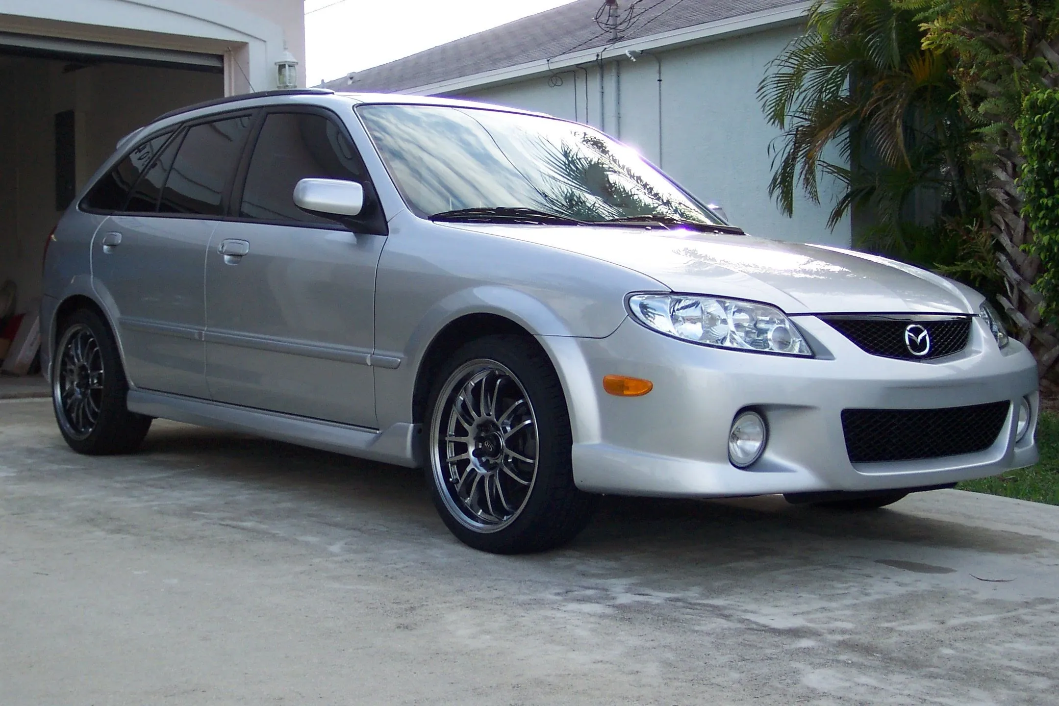

Riax Seca 10 spoke.
Not a name brand but my wife picked them out when it was her daily.
Now that it's mine, I am tempted to swap with her new Mazda3 and paint the mz3 wheels dark silver.

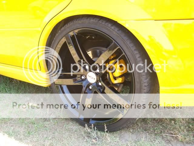

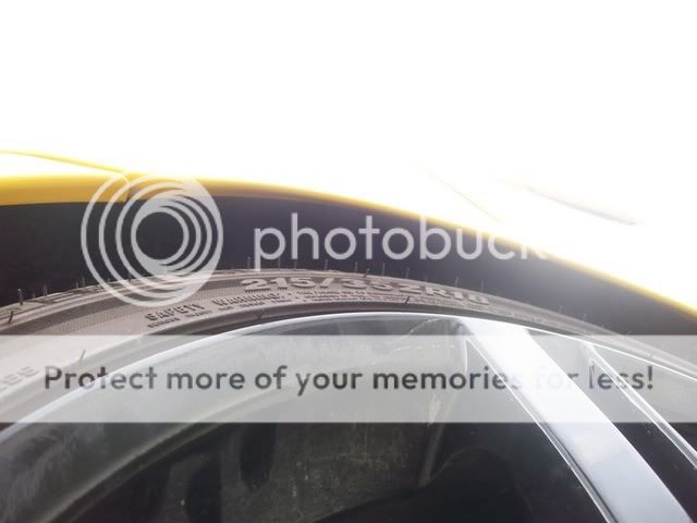

So basically I'm just asking for trouble if I wanted to do an 18" set +40? I'm lowered 2" front and back.
I have a set of 18s but I have no clue what the offset is the brand is VSR
My tires are 215/35/18

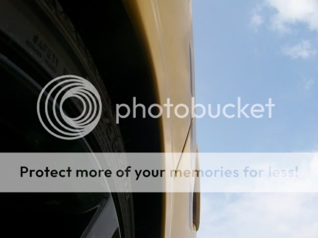

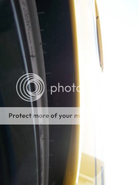

I had a rub issue untill I had fenders rolled here are some pics
Here are some pics of the roll I had done
Nope.
:p

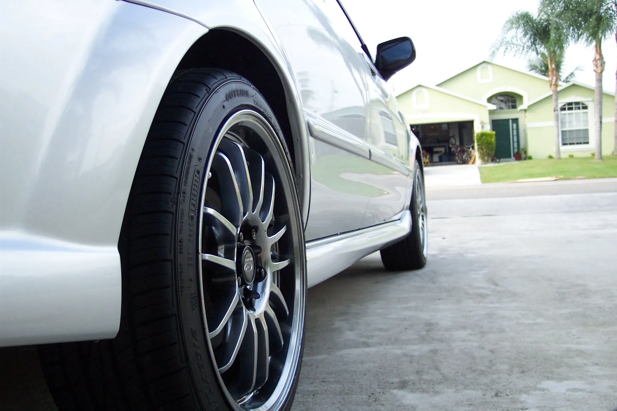

Rota SVN Hyperblack 17x7.5 +48 offset ^_^
Fake volk re30's FTW!
