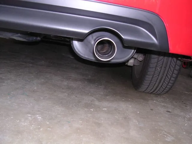

After getting my 2002, I got stupid and discovered all the cool aftermarket stuff and decided on the Tanabe Medallion Touring even though its a little pricey ($360). I liked the idea of low noise and ease of install as I didn't want to mess with a cat back. The photo on their web looked ok even though I sort of don't like the idea of an oversize diameter bumper outlet (seems "fake" to me).

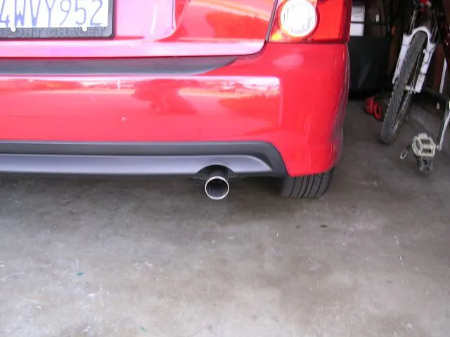

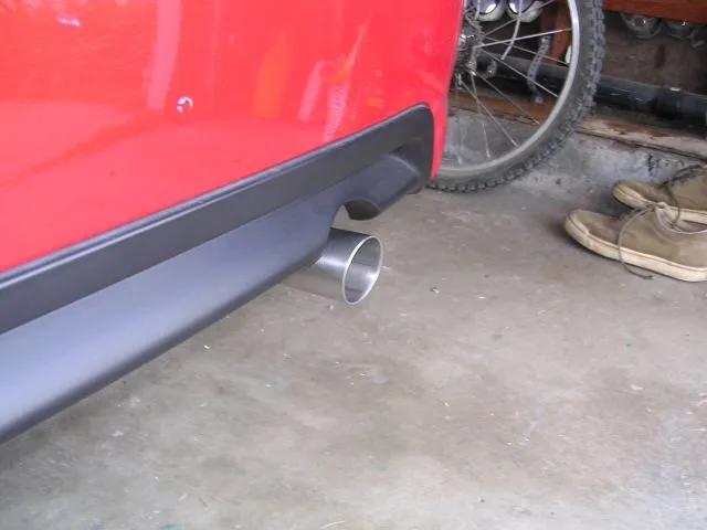

After install and starting the car, it didn't seem any different from stock, but then realized the idle was a little deeper. Unfortunately driving 75 on the freeway caused just enough additional drone to really bug me, and I even tried to sell it. After realizing I would have to give it away, I decided to keep it, so I got a 2 1/4 " stainless tube and slipped it into the end as an experiment and noticed the drone was almost gone. So I cut off the fancy tip and had the extension welded permanant. I did go back to the stocker to see if it was a lot quieter, which it was however, the Tanabe seems to be giving me maybe 1 to 2 mpg better, so its back on.
Not much to look at if you want flash, but it works for me and is still pretty quiet but lower toned than stock. I also used Hiheat black so the muffler wouldn't show as much.
Rusty in San Diego

Well, after removing the tip, it just didn't look right, Ideally I would have butt welded a 2 1/4 OD pipe all the way back, but its stepped down to 2 1/8" (slipped right in and maintained the alignment) and the "taper" was noticeable, so the blackout was a compromise. I had to have this removed from the car to get a free weld job, so couldn't play with alignment of a larger tip.
