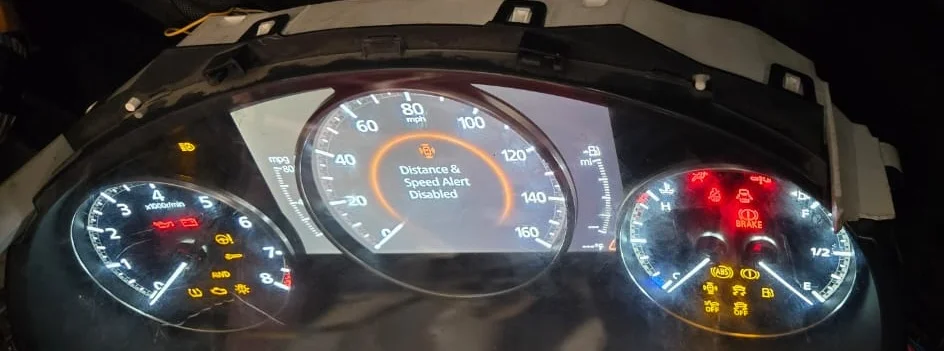

basically all the lights in the car is on apart from the dash light only blinking the security indicator light. just to check if the dash is faulty the mechanice bypassed it from the bcm and all the light with the error code came on but as you know the car wouldn't start that way

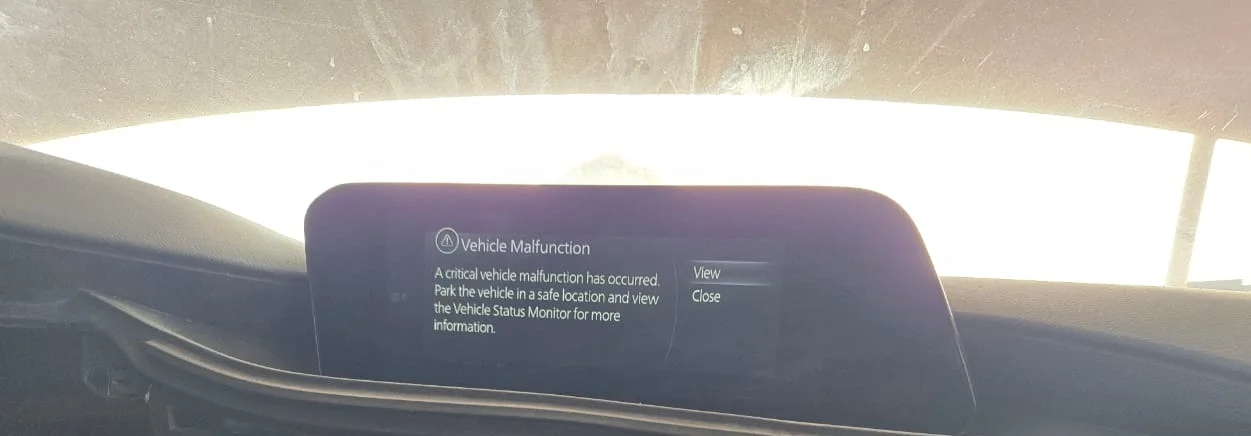

We have socketed the driver door molex/socket
Still looking for the mazda vcm/ford moongoose cable
Fixed all the wiring of the vechicle to the best of my knowledge
Noticed the bcm/ECU is very hot most likely it is calibrating i don't know
Here are a few images of what it is so far
I believe the mazda software will point us to the right direction
however the bcm isn't corroded just the bracket
