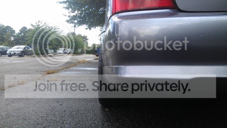

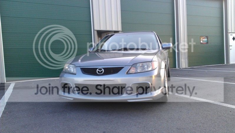

currently how the car sit just 1mm spacer in the back 225/50 tire sleeves maxed out
17x8 45 offset is what im running with a 245/40. but thats just to give you a idea. my setup sticks out 14mm further than your current setup. if you put the 17x8 30 offset and i 225 tire its gona stick out 5mm more than my current setup. which isnt much but i rub on big dips.
rear camber to get them to fit.
fitment of front im running a 8mm spacer in the front so there pretty much 37 offset in the front
