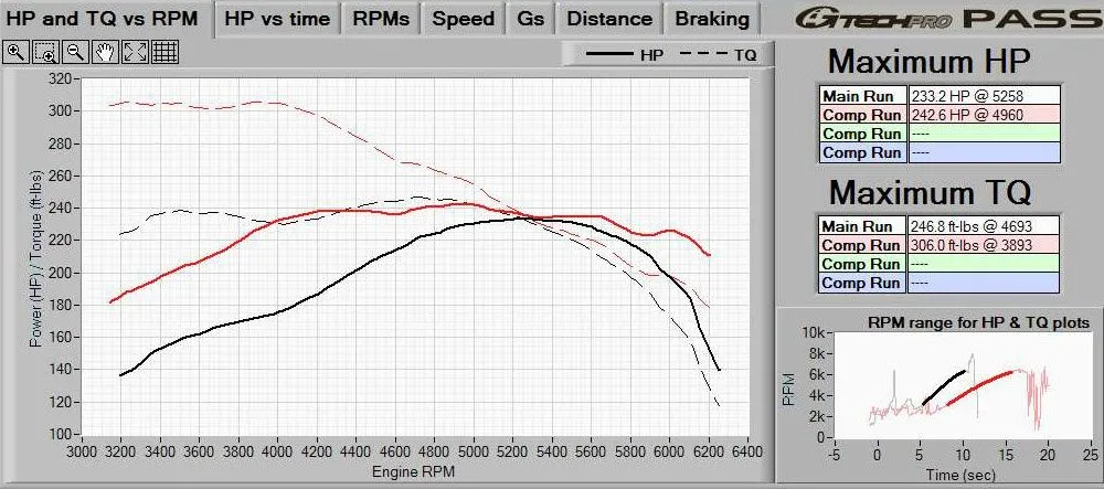

I would be very interested in seeing a dashhawk graph 4rth gear pull from 40 to 80 after the tune has settled in
With OP's mods, such a fourth gear pull graph might look something like this posted below:
Almost no "peak" power gains at 5,500 rpm at this mod level (actually peak is about 11 hp higher, but it occurs earlier) as the engine is closing in on load cap, but huge increases in torque and a much broader, flatter power curve that is much more usable before peak power and an nice extension of usable power out several hundred rpm higher than stock tune.

kickass, thanks. is that with all mods in your sig?
TurboXS DP/RP "Stealthback" Stage 1 Package (stock CBE) Vibrant 3 inch Ultra Quiet Resonator in RP section, Magnaflow 3 1/2 unrolled stealthy exhaust tip, second generation Mazdaspeed CAI w/45 degree positioned air straightener, NGK Iridium IX LTR7IX-11 one step colder plugs. Hypertech tune added at 37,000 miles. Stock BPV. New tires at 27,000 miles - Pirelli P Zero Nero A/S. Stock BPV, Stock RMM.
Yes, the red line and the higher dotted torque curve are with all mods in the signature.
The black line and the lower dotted line represent all mods in signature but before adding the HT tune. Do not take the hp and torque numbers literally as absolute numbers, but rather look at the differences between the before and after numbers.
And also realize that as rpm increases in those 4th gear pulls, this is out on the highway and not strapped down to a dyno, so the hp is actually pulled down by the effect of aerodynamic drag which is damn severe by the time you get to high rpm. You are actually losing 40-50 whp to drag by the time you get to 5,800 rpm, so keep that in mind. Whp out there is probably in the 280-290 range as it might appear on a chassis dyno, but that is just an estimate.
