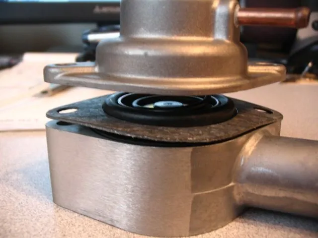

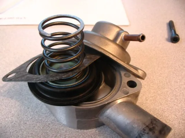

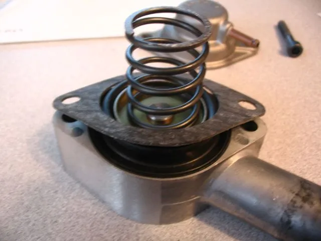

Anyone now how to put the HKS BOV that comes with the hiboost FMIC back together. Theres the gasket on the bottom, then the large metal peice, a circualr rubber peice with a metal disc in the middle, a spring, and the top portion. Anyone know which way to put all the internal peices back in? Thanks
Hey Sniper, this is how mine is put together.

ok thanks allot your a life saver. Thank god for these forums. I have it in wrong right now ive been shifting at like 2k to avoid damage. Thanks!
The right position is:
Gasket between the BOV pipe and middle aluminum piece, then the rubber diaphragm, then the spring and then the top.
It is just like the picture, but the gasket shpuld be placed between the BOV charge pipe and the big piece.
