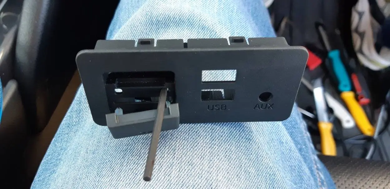

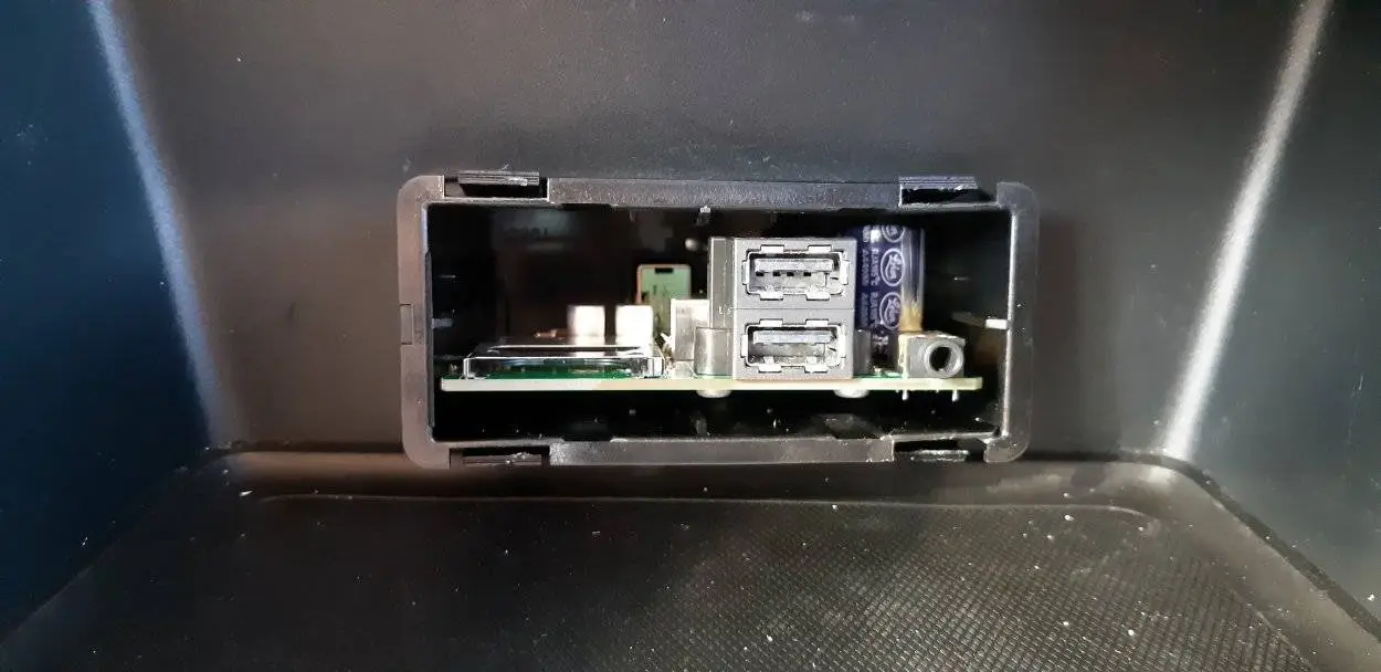

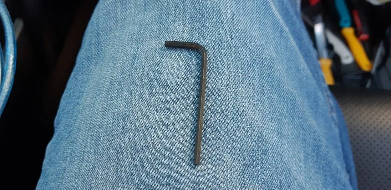

I did my AA/Carplay USB hub replacement and although it took forever, I now know how to do it best. :)
You insert the hex tool like shown in the pic below, and use pliers to yank the front face out.
Now you just lift the 4 tabs and you can temporarily insert small screwdrivers in there and then you push the entire unit out from behind. Should come out fairly easily...
