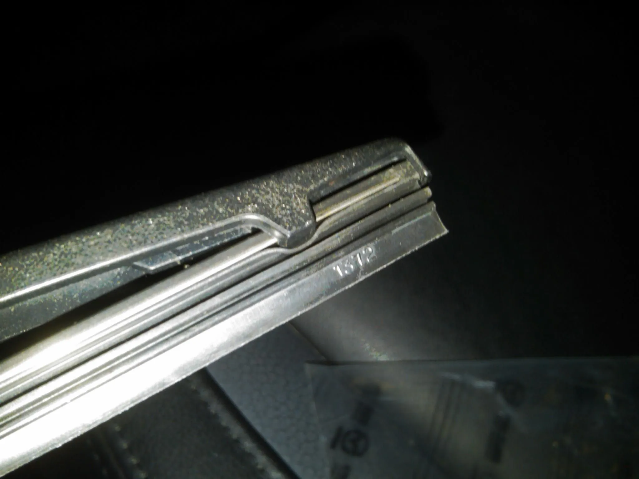

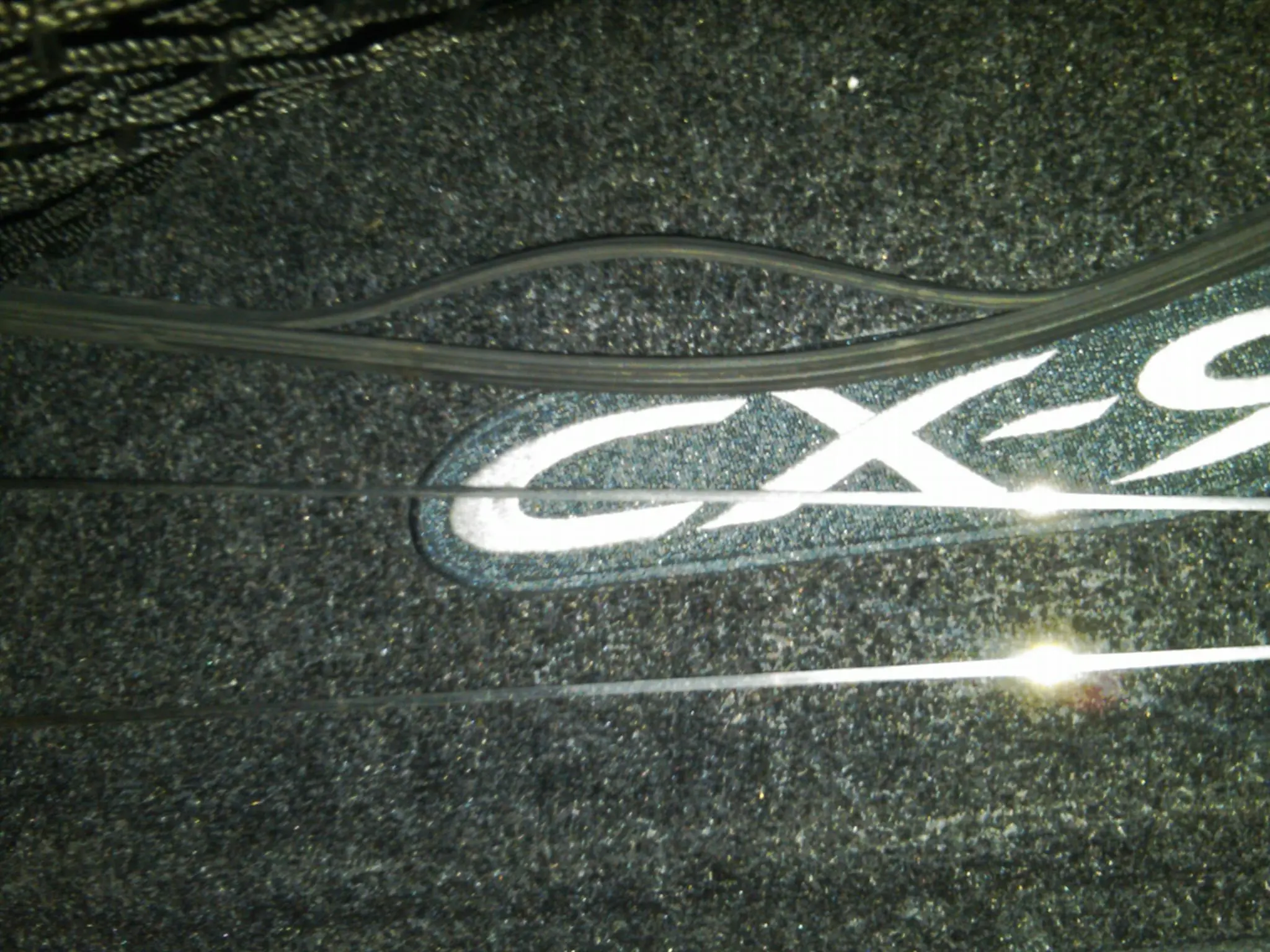

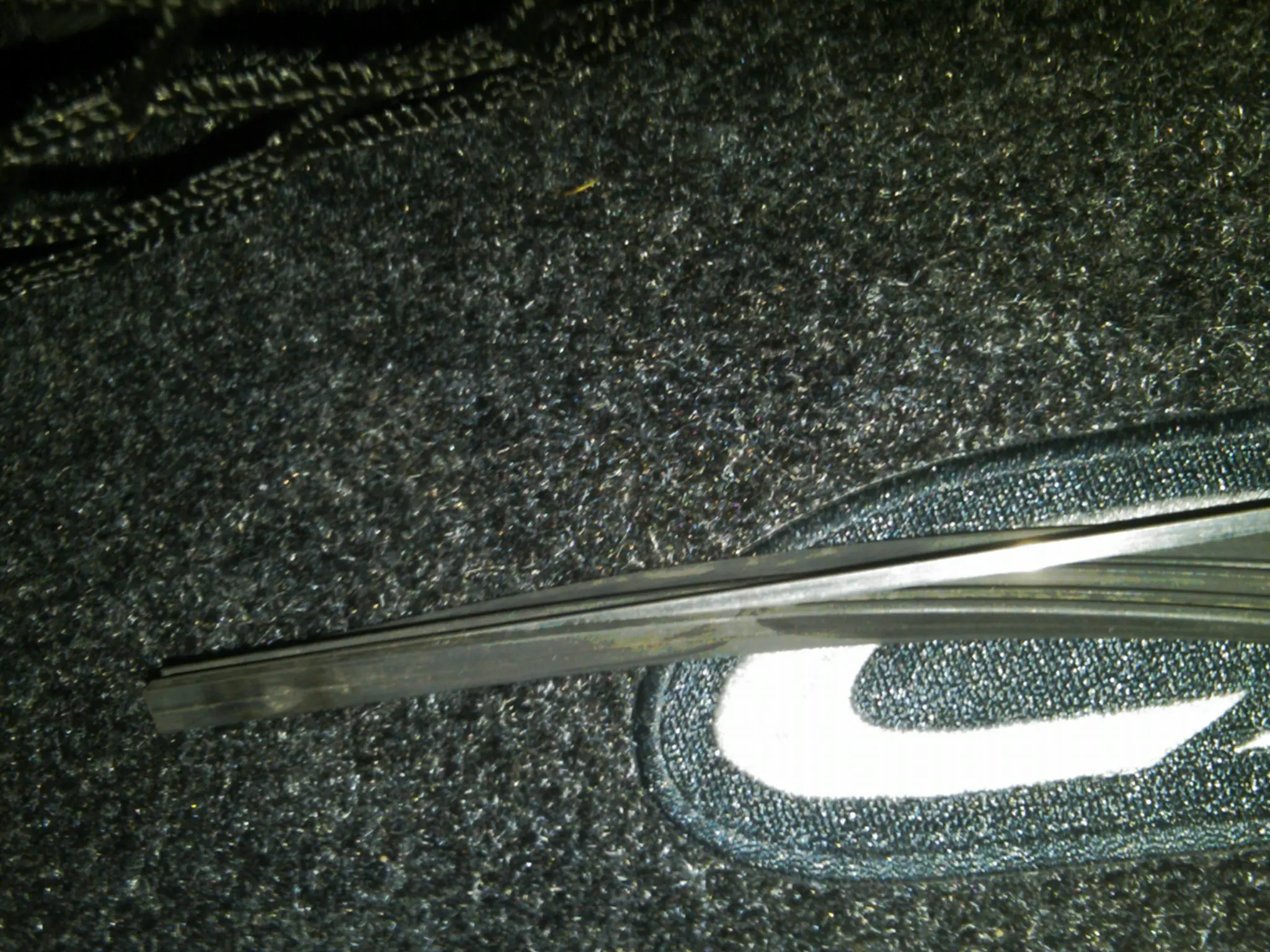

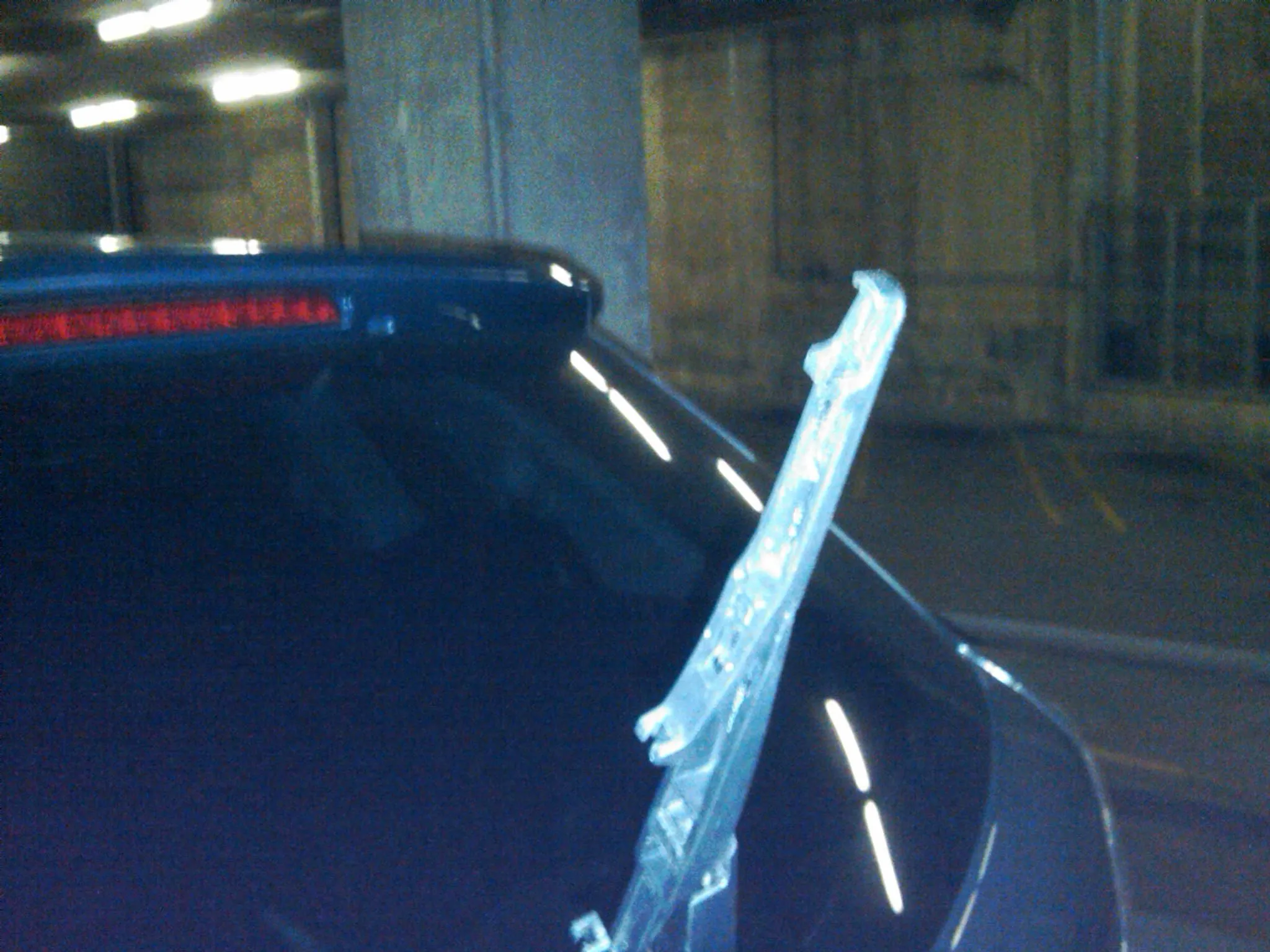

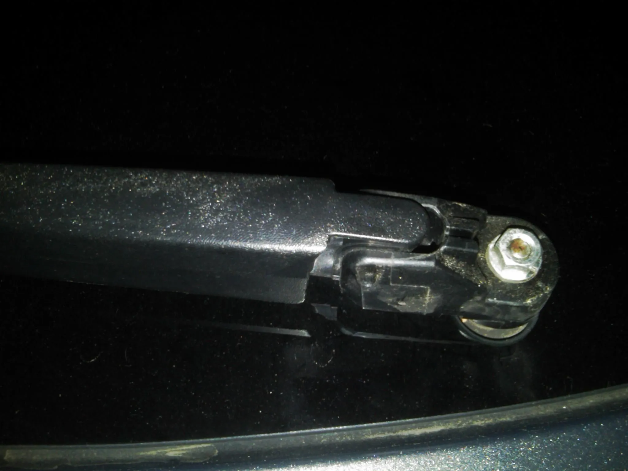

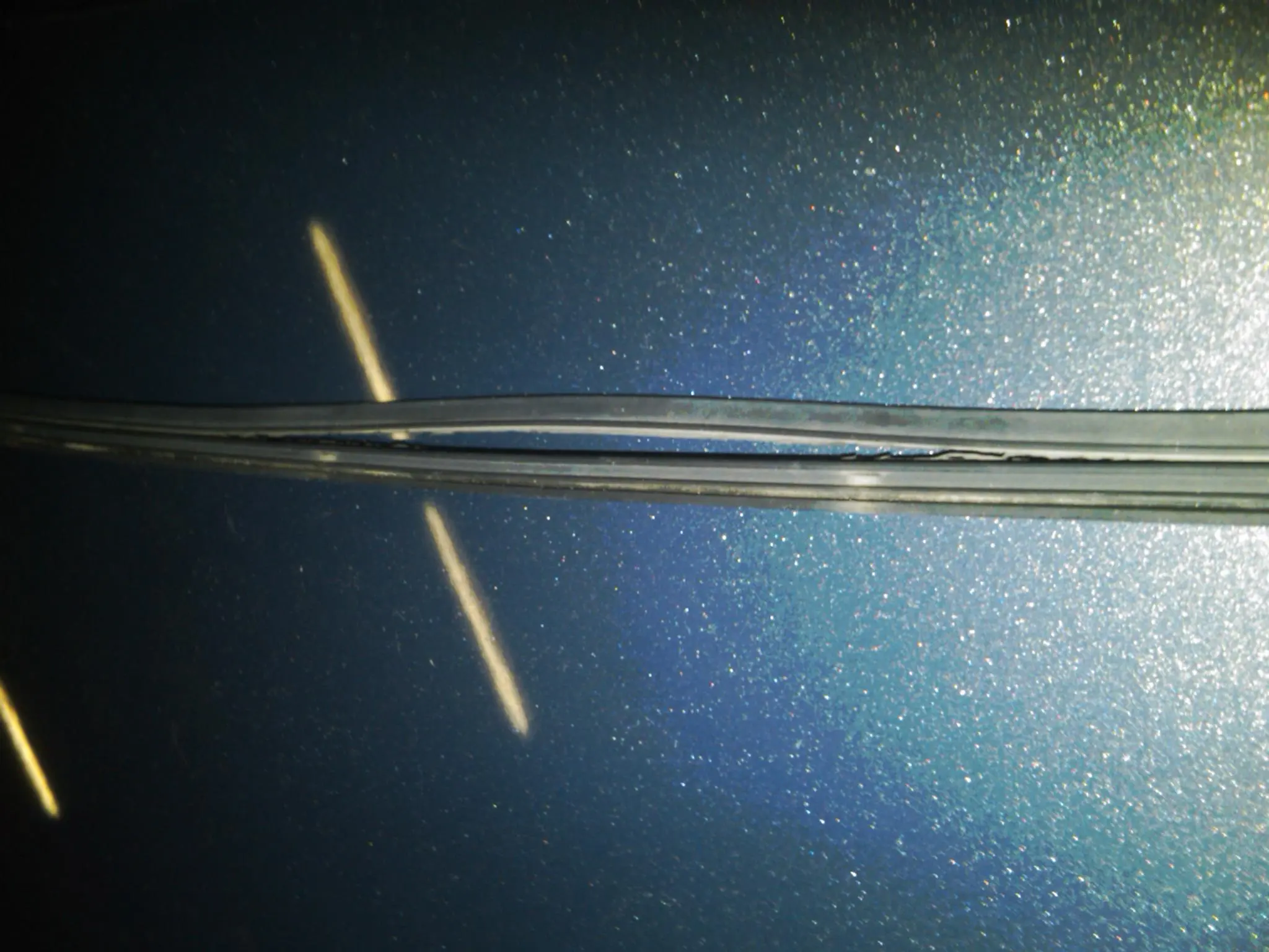

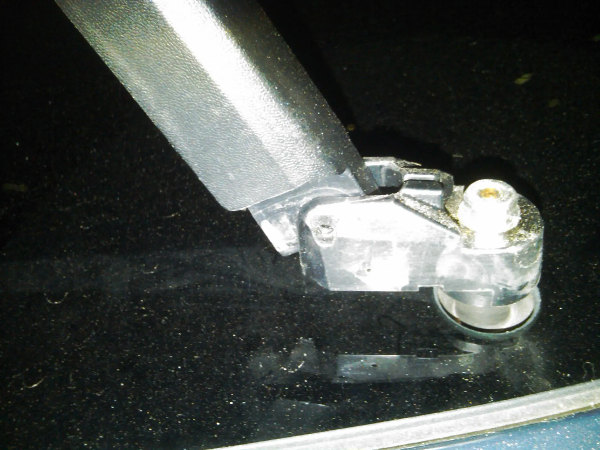

Well I know it's been a while but here are the pics of the rear wiper blade replacement installation as promised... (if anyone cares)
1) Remove Cover at the base of the Wiper Arm which prevents the arm from bending out. Simply pull sides out and lift (there are no screws involved).
2) Lift arm to stick out.

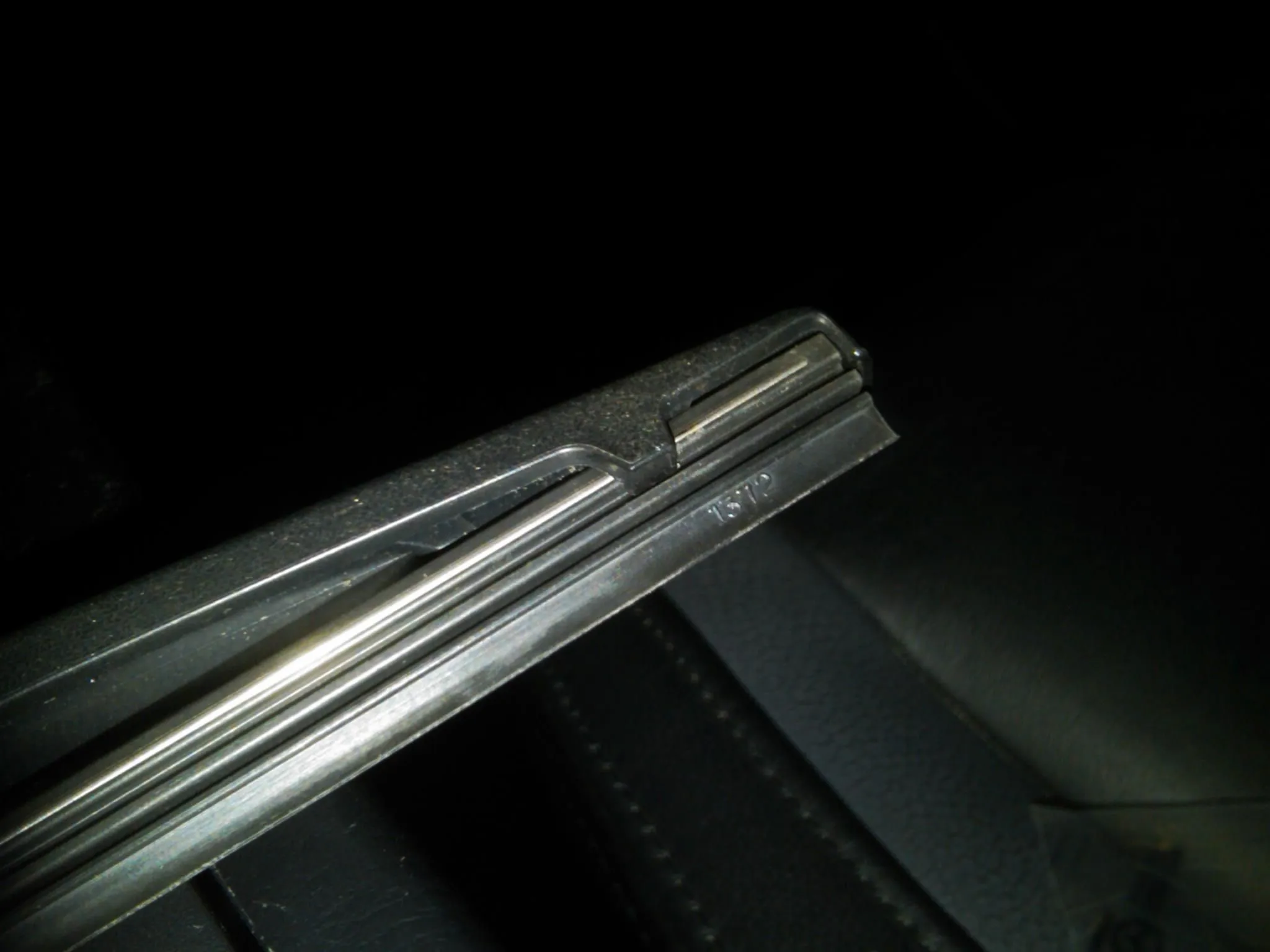

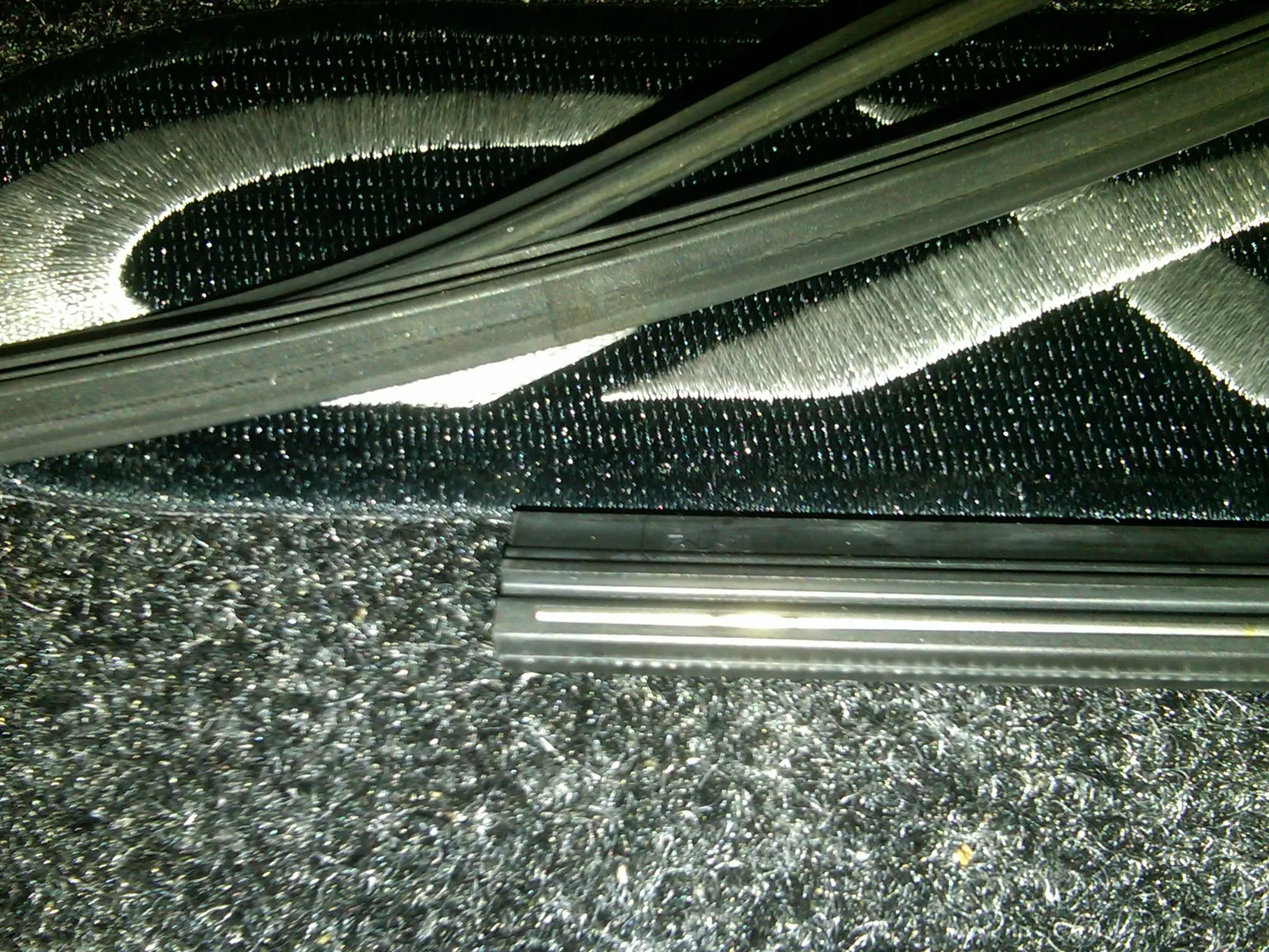

3) Slide Blade Assembly out of arm. Blade Assembly consists of two steel rods (Backing Plates) and the rubber Blade. The Backing Plates are wedged into the two sides of the blade.
4) Remove the plates from old blade.
5) Wedge the two plates into sides of replacement blade.

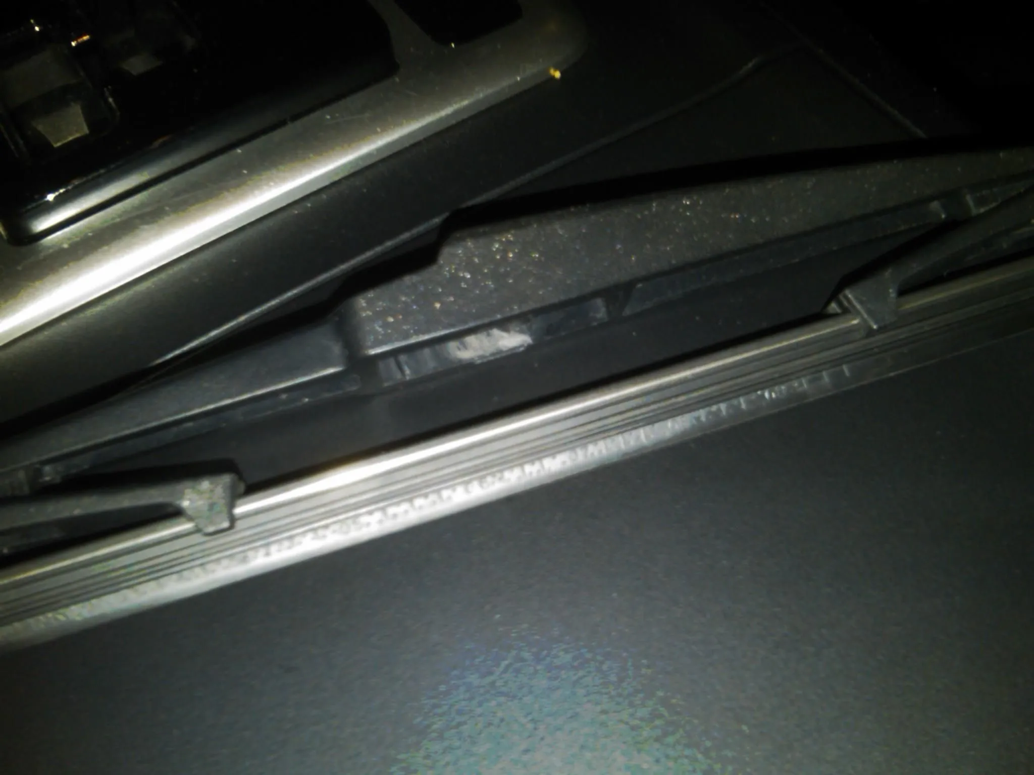

6) Slide Blade Assembly (BA) back into the arm. Be sure to set the BA correctly where the rubber is holding assembly in the arm and not the plates.
7) Lower arm back down to glass.
8) Replace Cover by simply snapping back into place.
