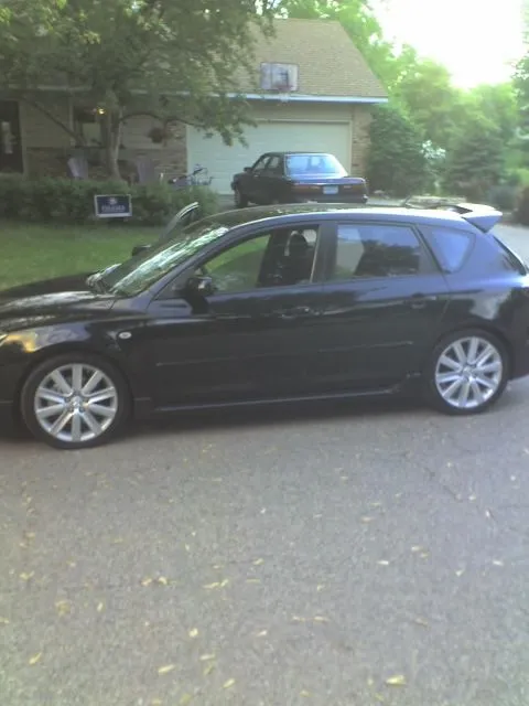

the float is totally gone and with the h&r you get bouncing. With the cobb I have ZERO and i mean ZERO bouncing. as far as pix i only have some cell phone ones because i can't find my camera cord
thats what i thought when i finally lowered the car off the jack stands. I am deffinatly happy i went with cobb. No regrets here. Tonight i have to go into the cities to go to work so i will let everyone know how the cobbs do on some crappy roads
when I lower my cars I usually like to be dropped on my ass. But I'm tired of terrible ride quality, its time I keep the good ride going. I like the pic. Let us know how she rides! I also hope that settles a little bit more for you, a tad bit lower would be ideal to me
Look forward to hearing your impressions.. I've got some Cobb springs on the way. And around here, all the roads are crappy. Still, the ride should be somewhat improved since the stock spring/shock combo is overdamped. With the Cobb springs, minor road imperfections should be soaked up better.
looks good... tell us how it is on the bad roads lol... if u do get better pix put them up... now i cant wait till i install mine...
So would you say the gaps between your tire and fenders like an inch or more? It does looks lower then most people drop on Cobbs though. Please take some pictures after they settle. Preferably with a digital camera?
