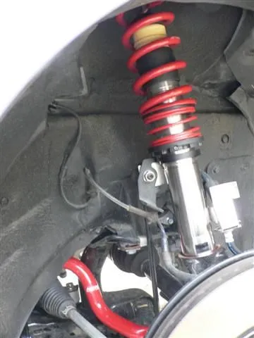

Simply put, the springs are too short for the setup. The usual fix is a "helper" spring. This is a light spring that compresses immediately when there is any pressure, but keeps some tension when the suspension is unloaded. The pic shows an example.

Well, mine came with my coilovers. You have to get springs that are the same diameter as the main ones. I suggest going back to the place that sold you the springs and seeing if they can help out.
Sorry, the real name is "tender" springs. Here is a possible source:
http://www.hrsprings.com/products/idrace/
Or here:
http://store.summitracing.com/egnse...ts=false&y=0&N=700+115&Ntt=tender+springs&x=0

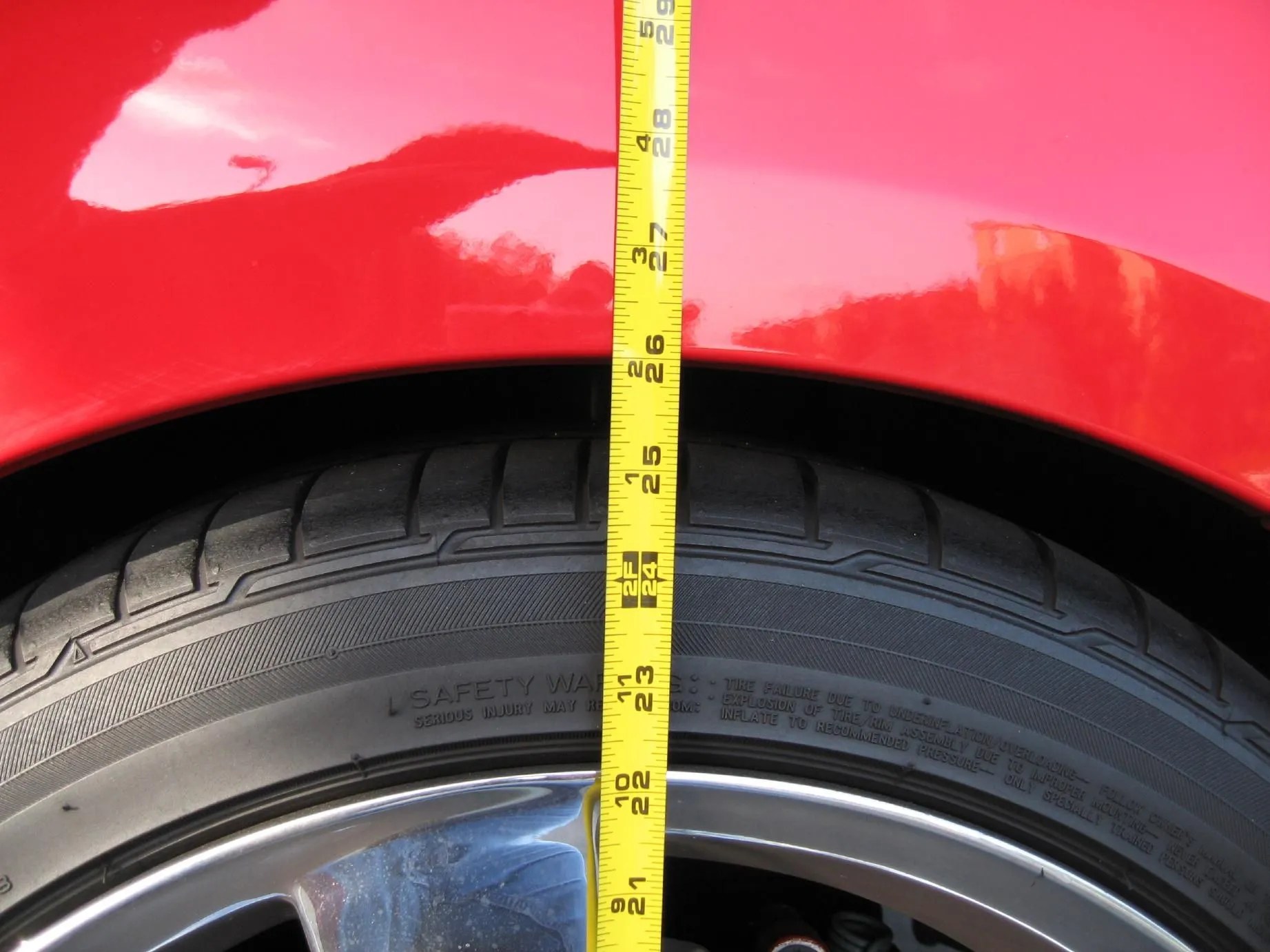

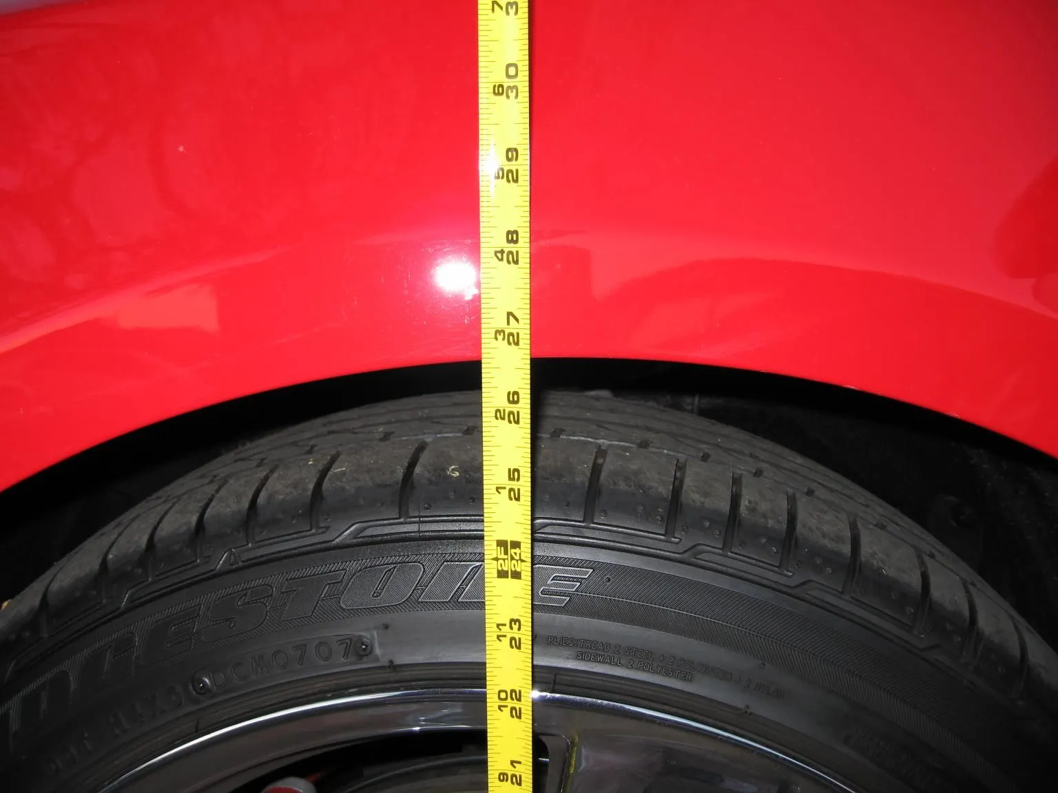

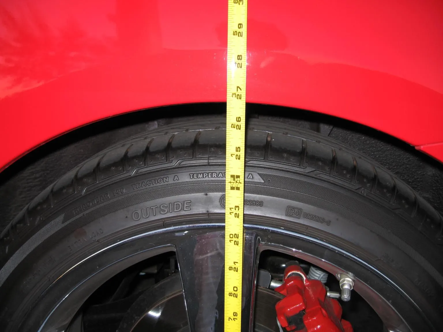

I have had my MS spings and camber plates installed for 8 months - maybe 8,000 miles and I have to say they are very nice. I wanted a progresive spring but one that did not lower the car more than one inch. I had a Miata that was super low and hated speed bumps with a passion. To my knowledge most other spring dump the car more than an inch or 25mm so they were out of the question.
As for the ride - it's not stiff but it is firmer than stock, it goes around a track just fine with a little swaying but I still have the stock swaybars on it. I might change those next but for the $400 (springs) it is nice. The coilovers were a little pricey and when I did mine I could not find any reviews of them. I measured the car before and after - it was about a 1" drop in front and maybe 5/8" to 3/4" in the rear.
