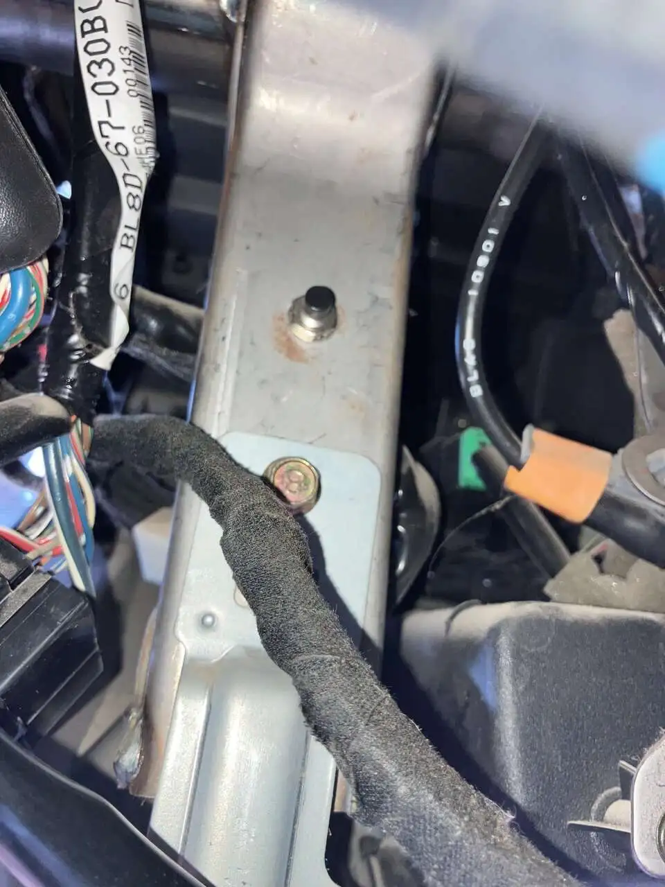

Right up under the dash on the driver's side. Grab a flashlight and crawl under there you will find it. It's attached to a large metal bracket.

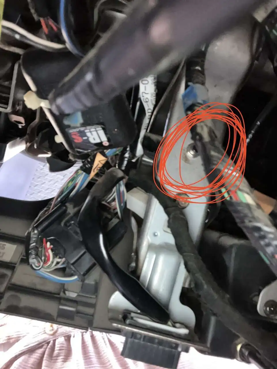

omfg i found the little black button!!!
thank god its there..
impossible to find... guess thats a good thing?
it worked. but for some reason my remotes arent anymore.. everything is plugged back in.
btw. future reference.. its pretty much behind the coin slot on left side of steering wheel

After scouring the internet, trying to figure out where the fool button is, looking for pictures/videos/anything, I finally found this, your beautiful, wonderful, little gem of a comment describing the location. In honor of you, and with great gratitude, I will attempt to gift The Internet with a picture of The Secret Mazda Button (hopefully it uploads). Go ye forth, frustrated Old Mazda owners, and reset thine alarms!
