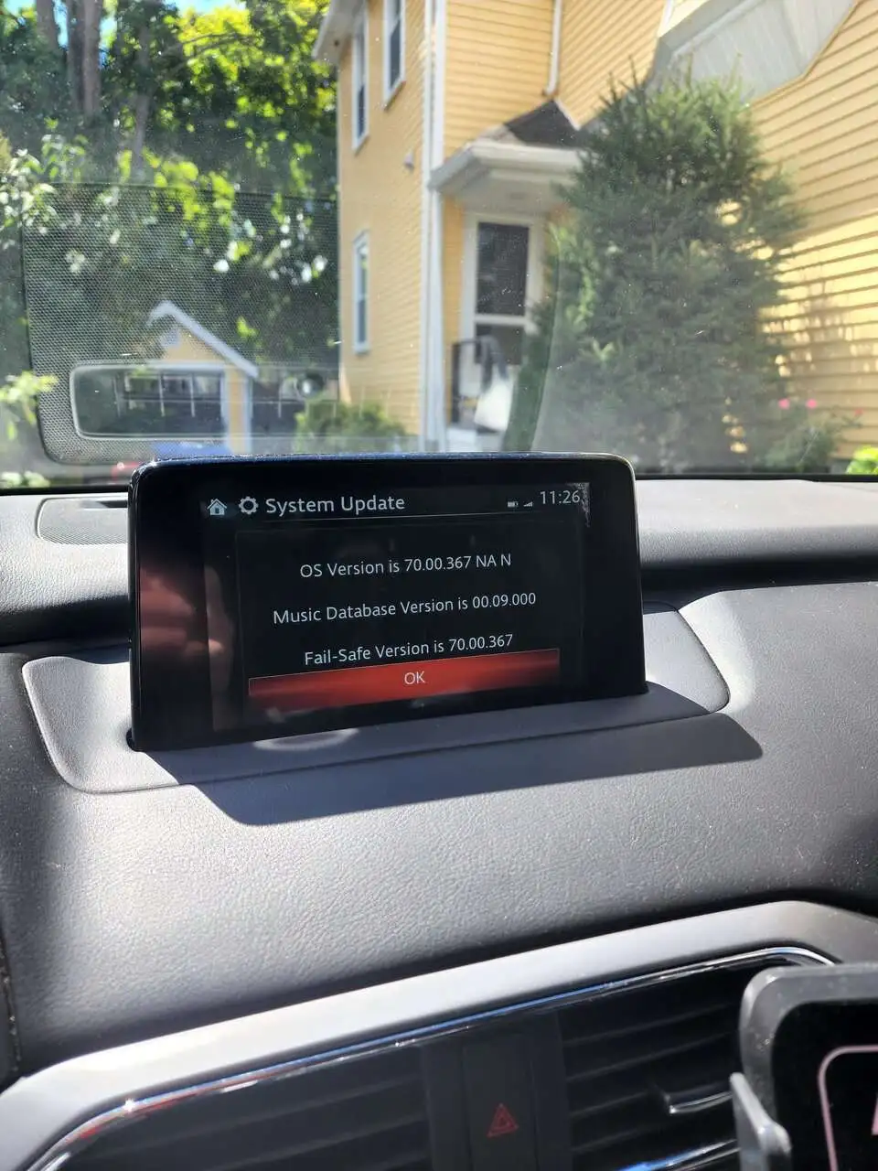

Is it possible to get the 74.00.230 update for north America? I did the upgrade to 70.000.367 myself about a year ago and that worked well. Like many other posts hoping it starts up faster.
I think you can go straight to the latest avail le from they one you are at now , the current is 74.00.311 NA.

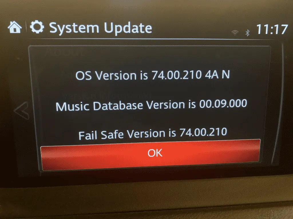

Hey everyone. I have CX-9 with the 9-inch screen. The system shows there is "Network Management" section where you enable Wi-Fi. However, Apple CarPlay can't be added without using the USB cable.
This the system revision for your feedback. Thanks
This the system revision for your feedback. ThanksView attachment 313431
I just went to the dealership and was charged equivalent to $40 to diagnose and upgrade to the latest software, 74.00.311 4A N. Still can't use wireless CarPlay
I just don't understand November MY2021 wouldn't be compatible with wireless CarPlay! Are there any other parts prevent this to work?
