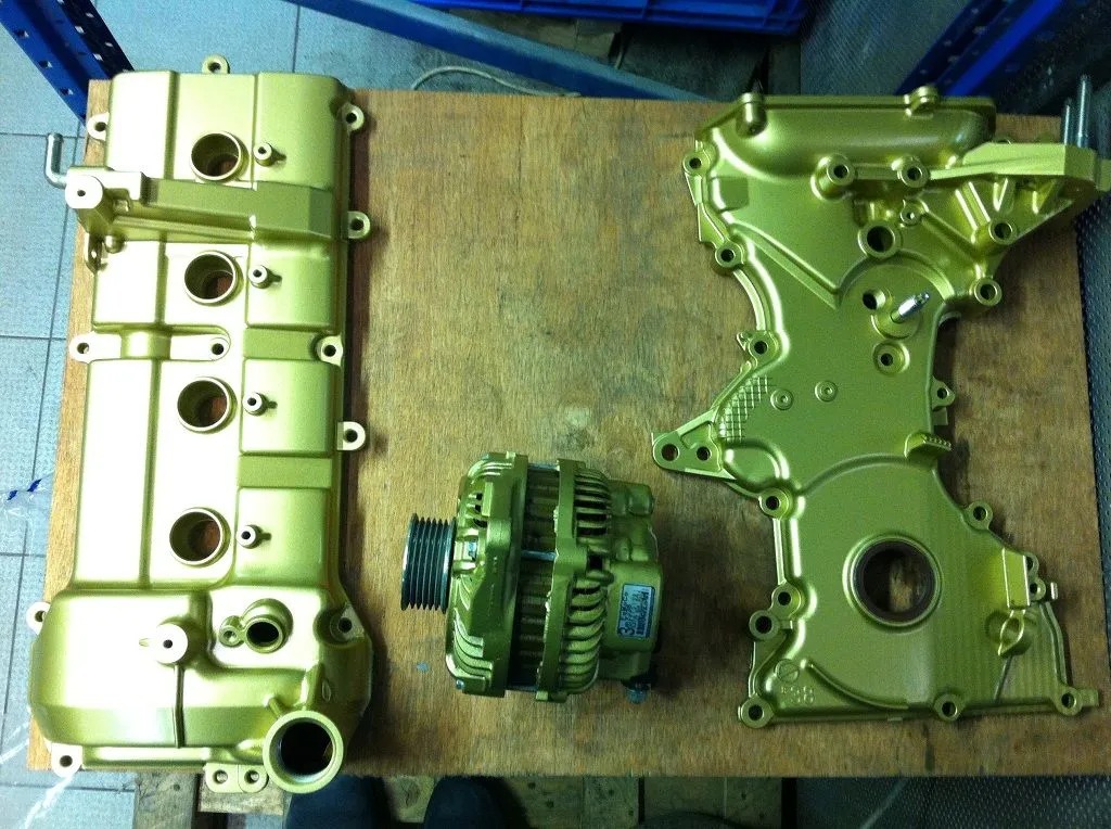

Gold painted engine head cover , timing cover , alternator ,engine mount

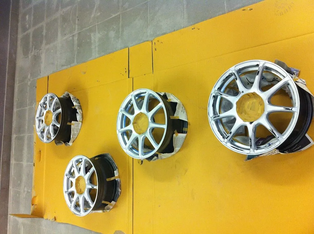

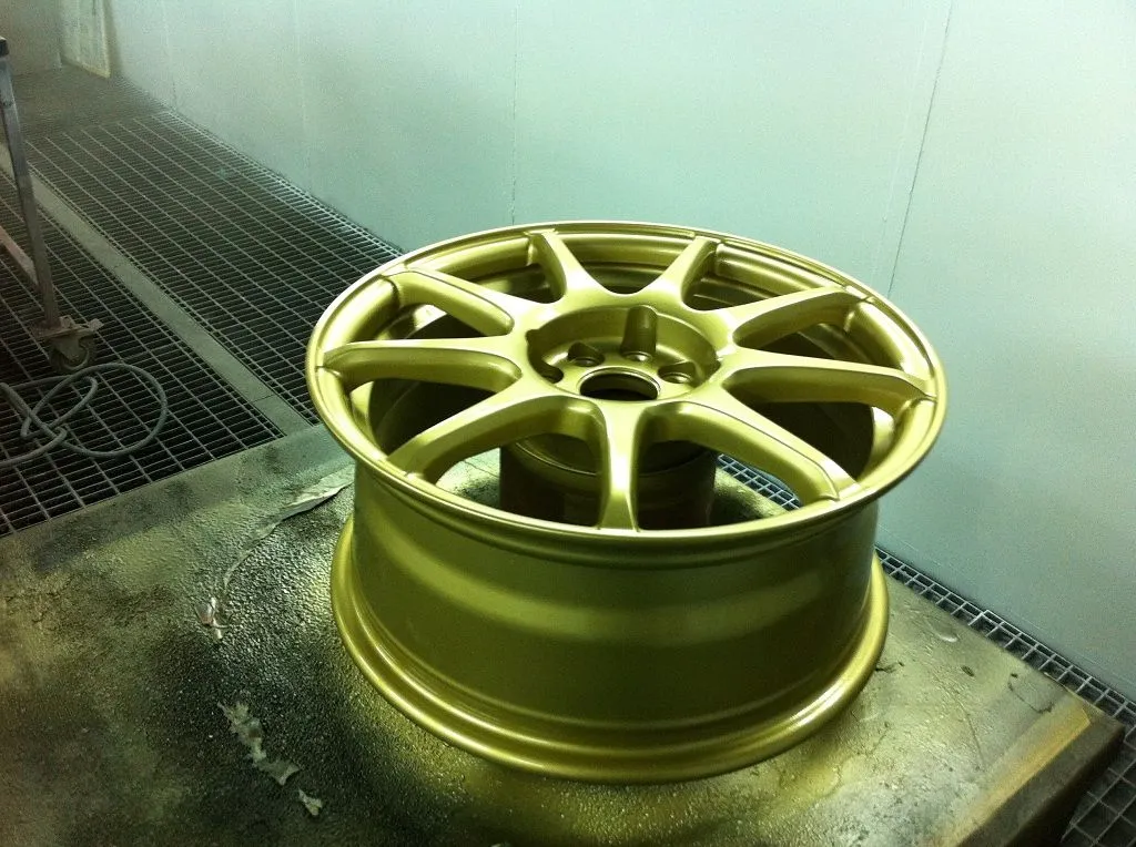

16" gold painted rims with 205/45r16 yokohama Sdrive tires
Gold painted front and rear ornaments , foglamp covers

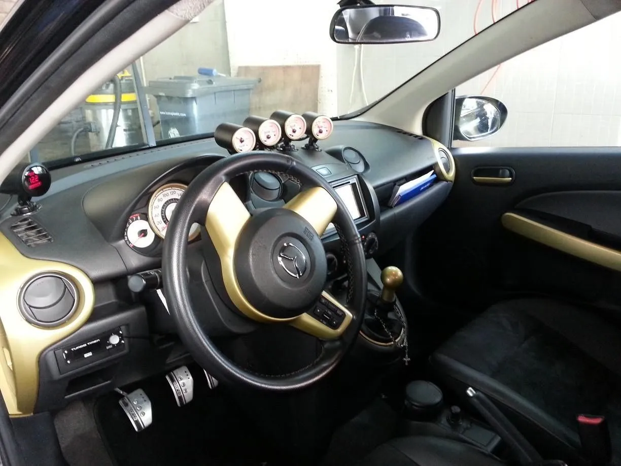

Interior:
Custom gold painted steering wheel, dash, door handles , shift knob
Multimedia screen with GPS, bluetooth hands free , rear view cam
clarion 500w oval speakers
clarion amplifier
clarion 4 round doors speakers
clarion 12" subwoofer
Recaro front seats +custom black fabric ( alcantara and leather)
Innovate AFR gauge , boost gauge , oil pressure oil temp gauge, and water temp gauge
HKS type 1 turbo timer

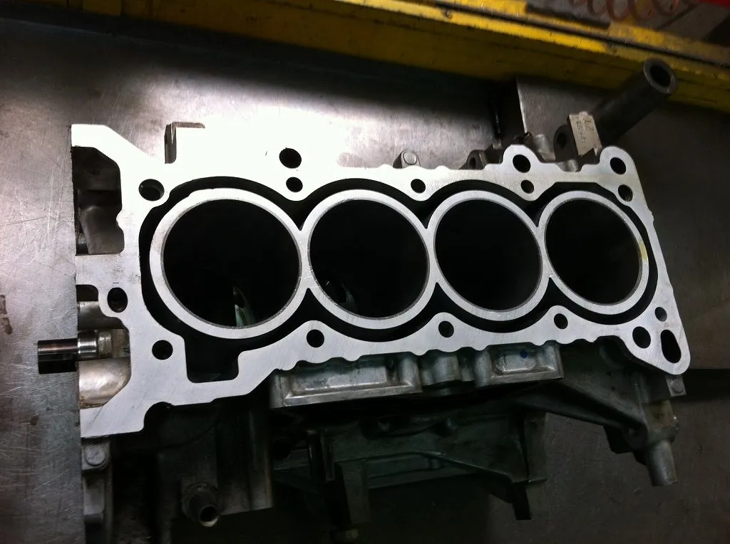

Custom built engine 1.6 internals

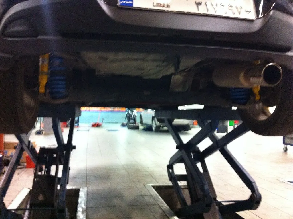

Bilstein B14 adjustable coilover suspension

I'd like to know more about this 1.6 bottom end. Any details and pics of build of that?
EDM spec Mazda3 used a 1.6l variant of our engine. Parts are pretty much interchangeable in the block. Drops compression I believe, which is why a couple people have used the rods/pistons for turbo builds.
the pistons and rods of the 1.6 are a direct fit to the 1.5, but the whole piston is 3mm shorter due to a shorter yet thicker rod , with a slightly concave face it gives a perfect setting for a low compression engine using OEM parts . i am preparing a collection of pics to upload , will do that soon .

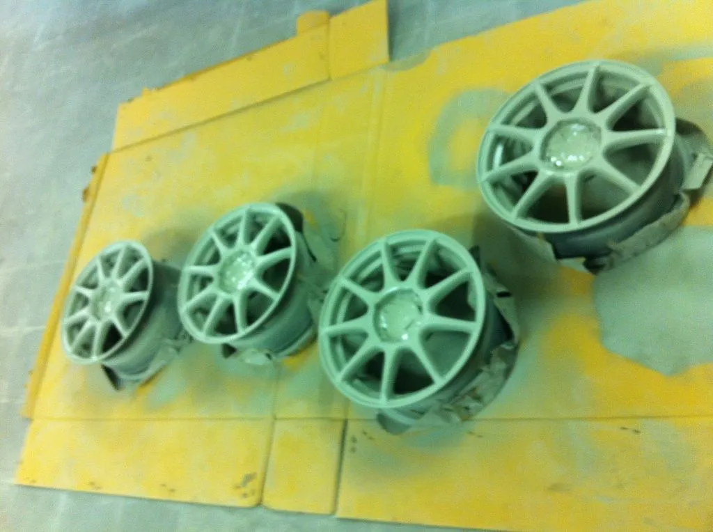

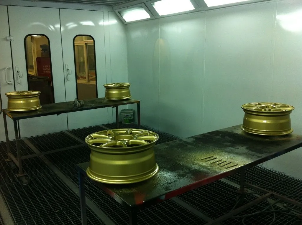

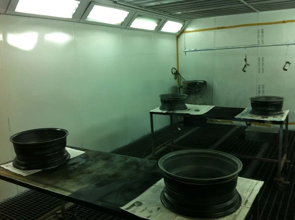

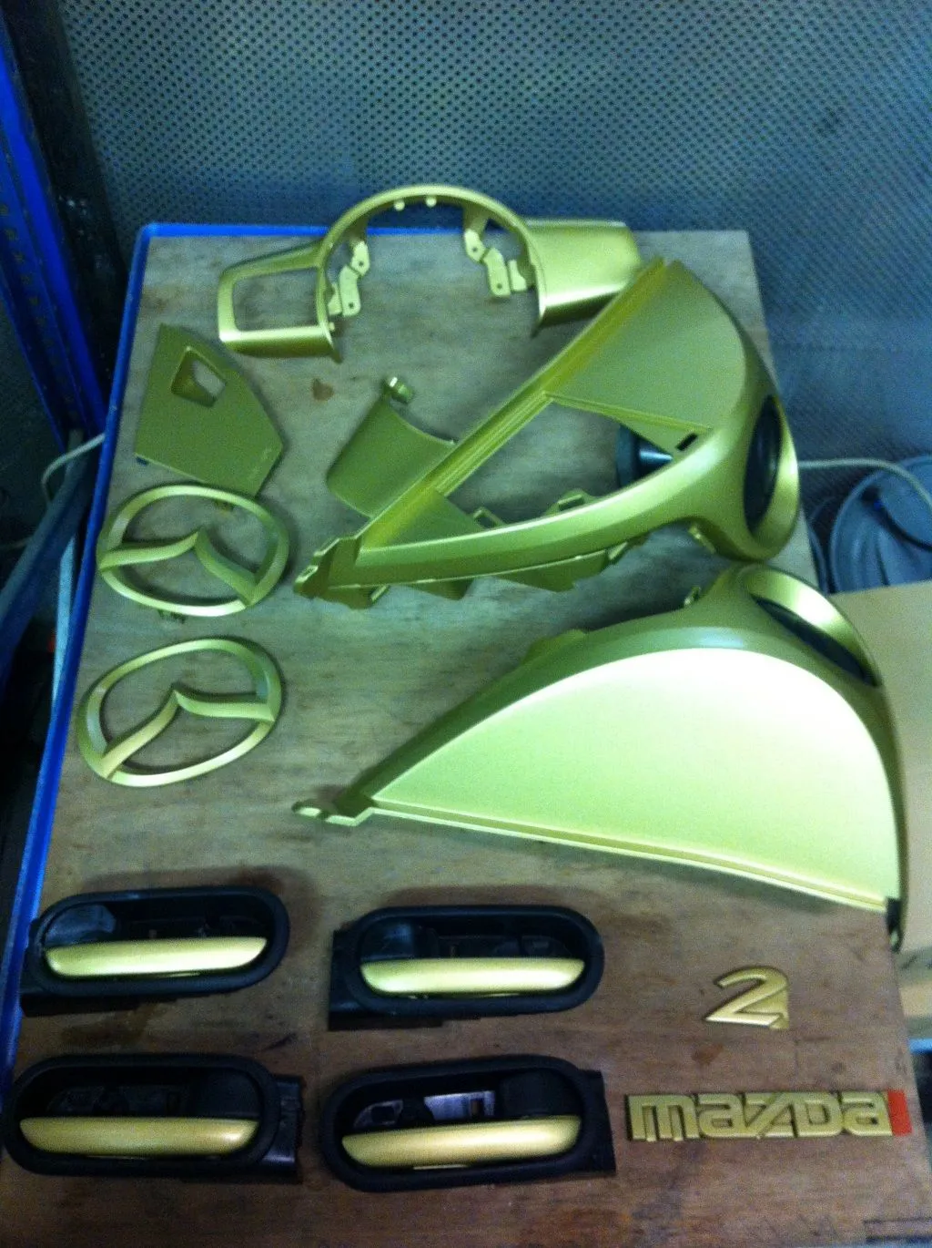

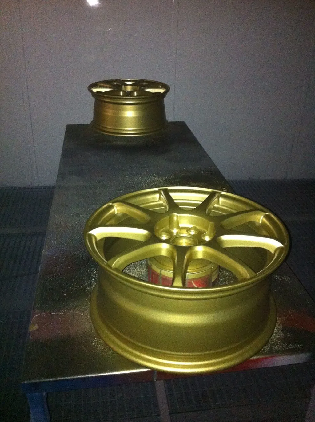

some more pics from the build
here are some more pics from the build
and some more pics
gold accenting at its best

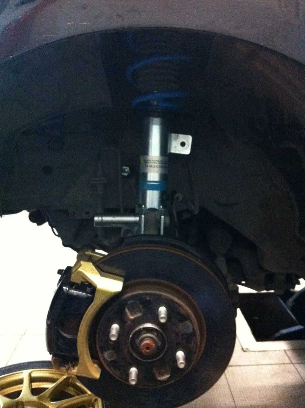

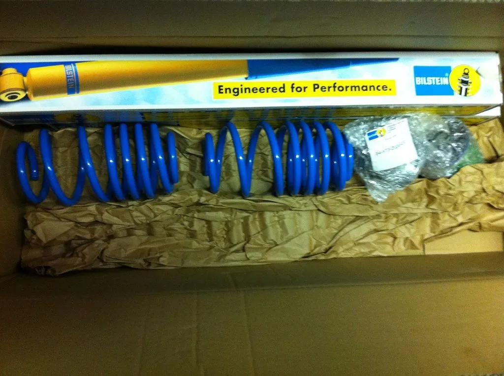

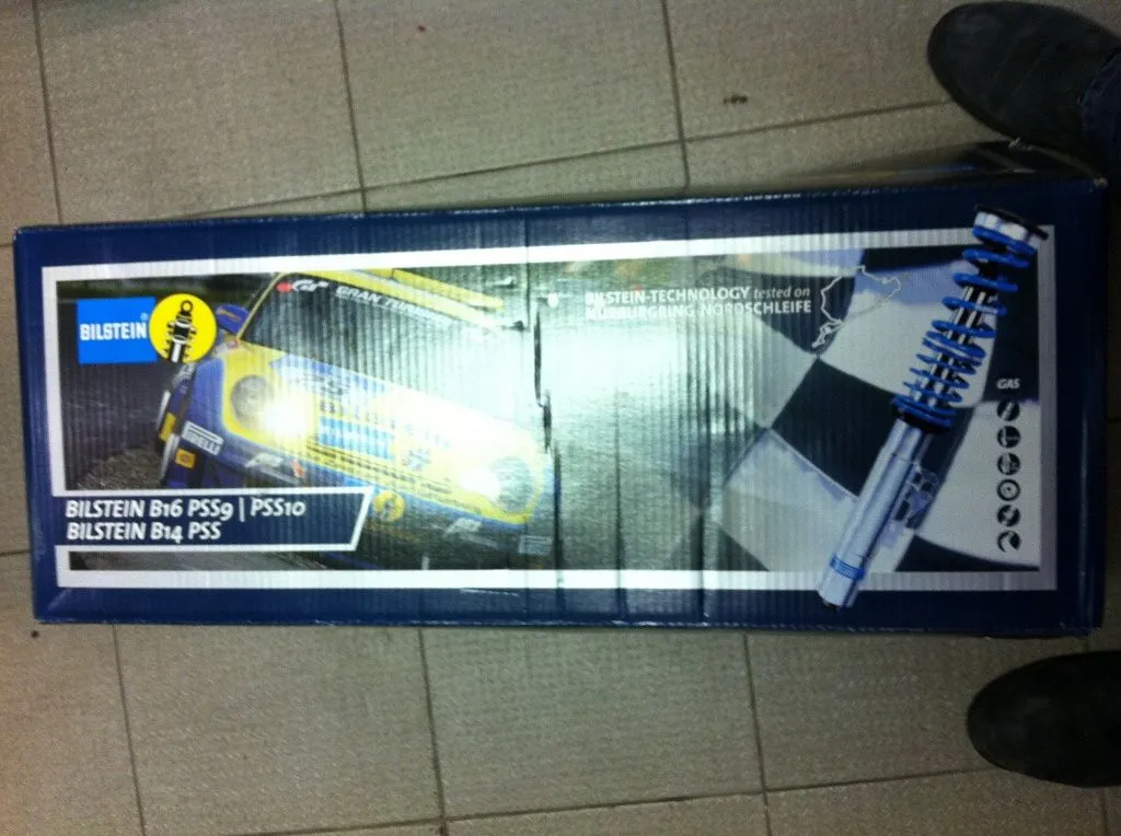

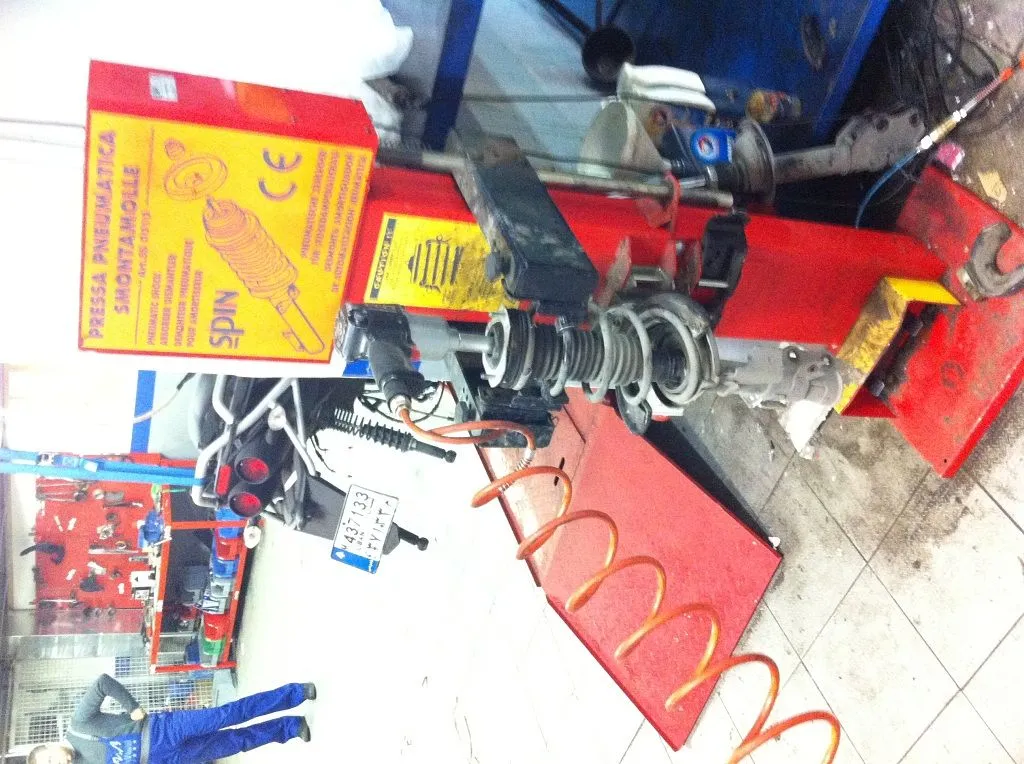

suspension work
bilstein all the way

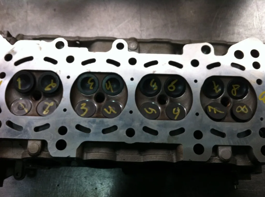

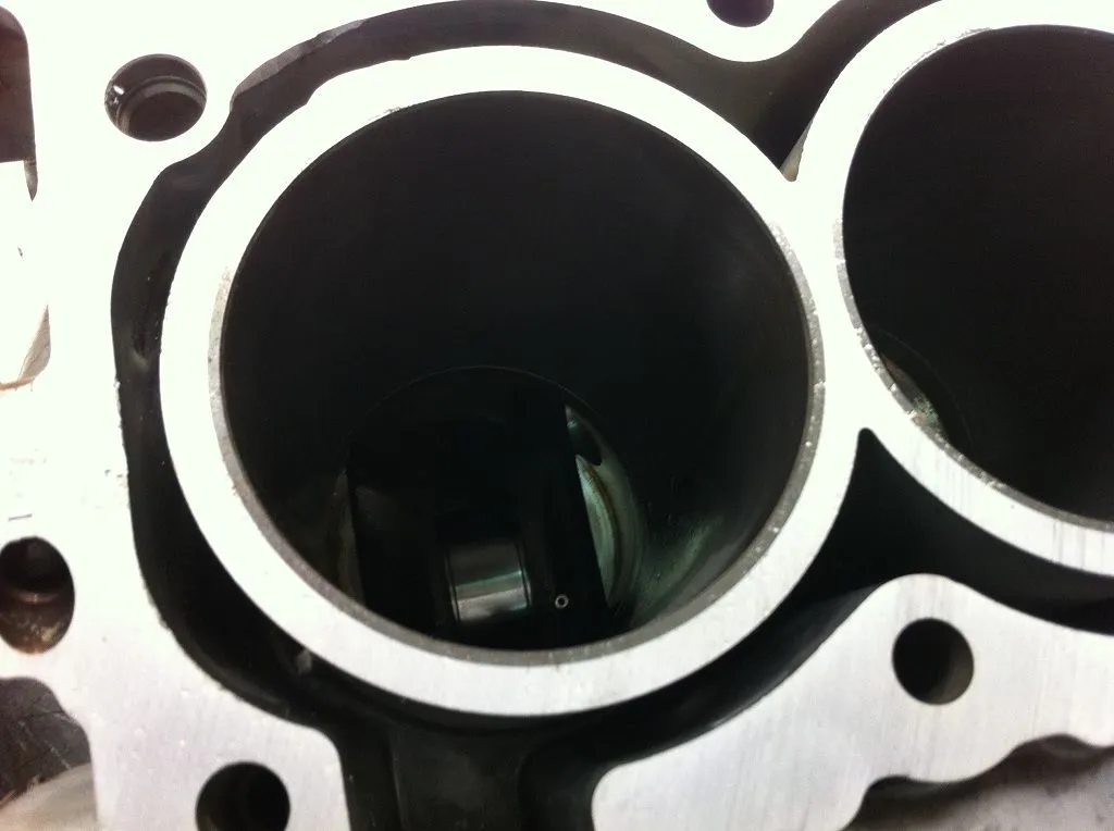

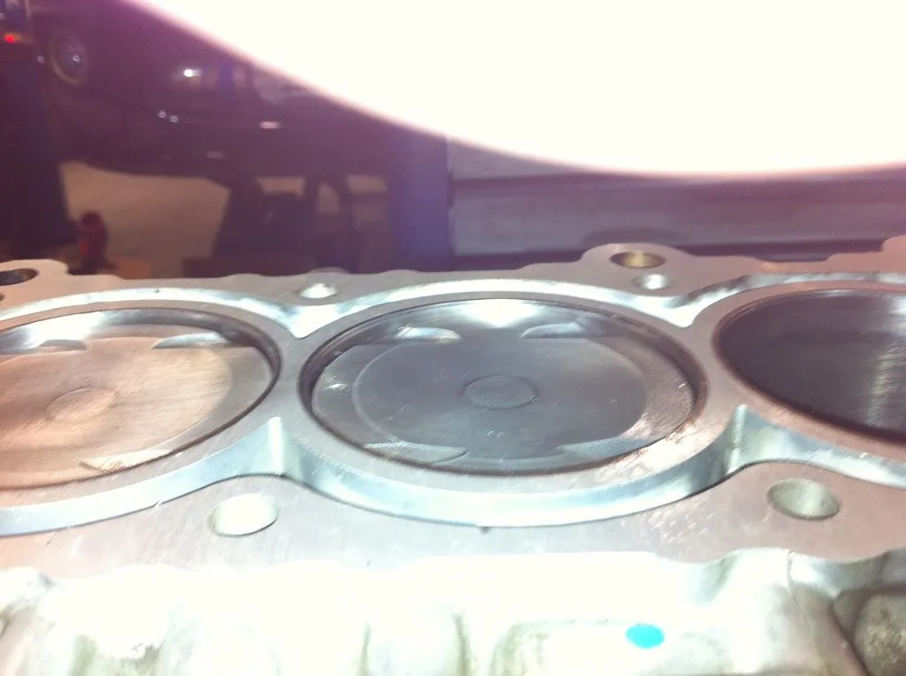

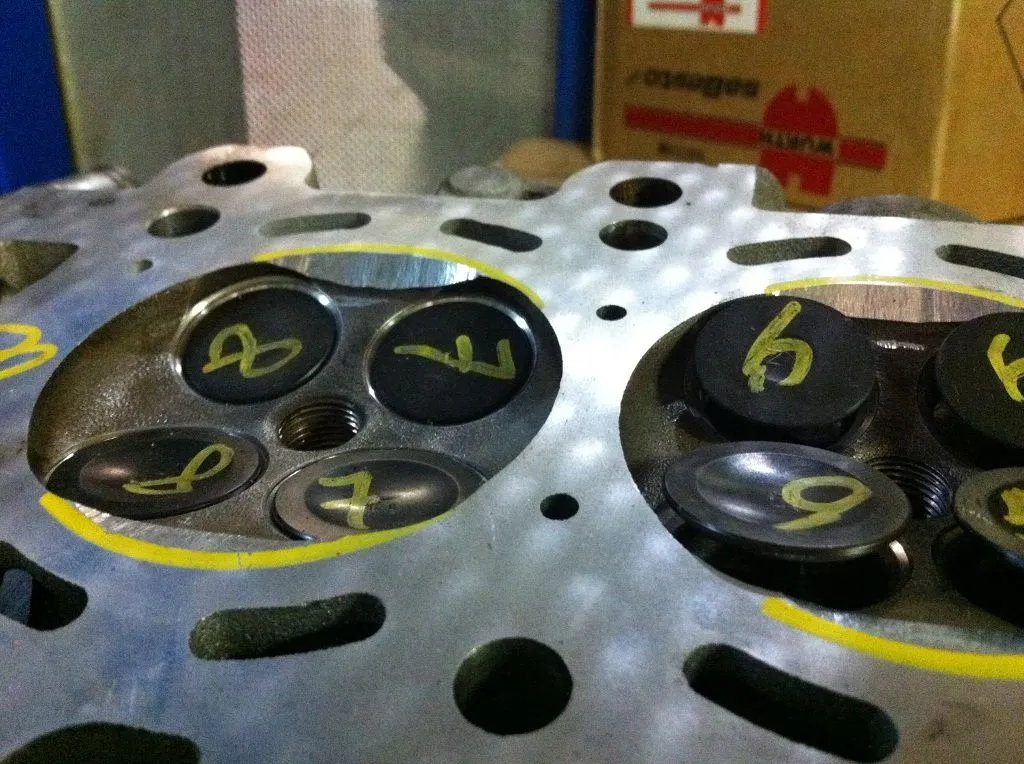

engine work
cylinder reinforcment and 1.6 pistons in
Ohhhhhh! I love pics of the technical details. ^_^
Why did you mill away part of the cylinder head? To lower the compression?

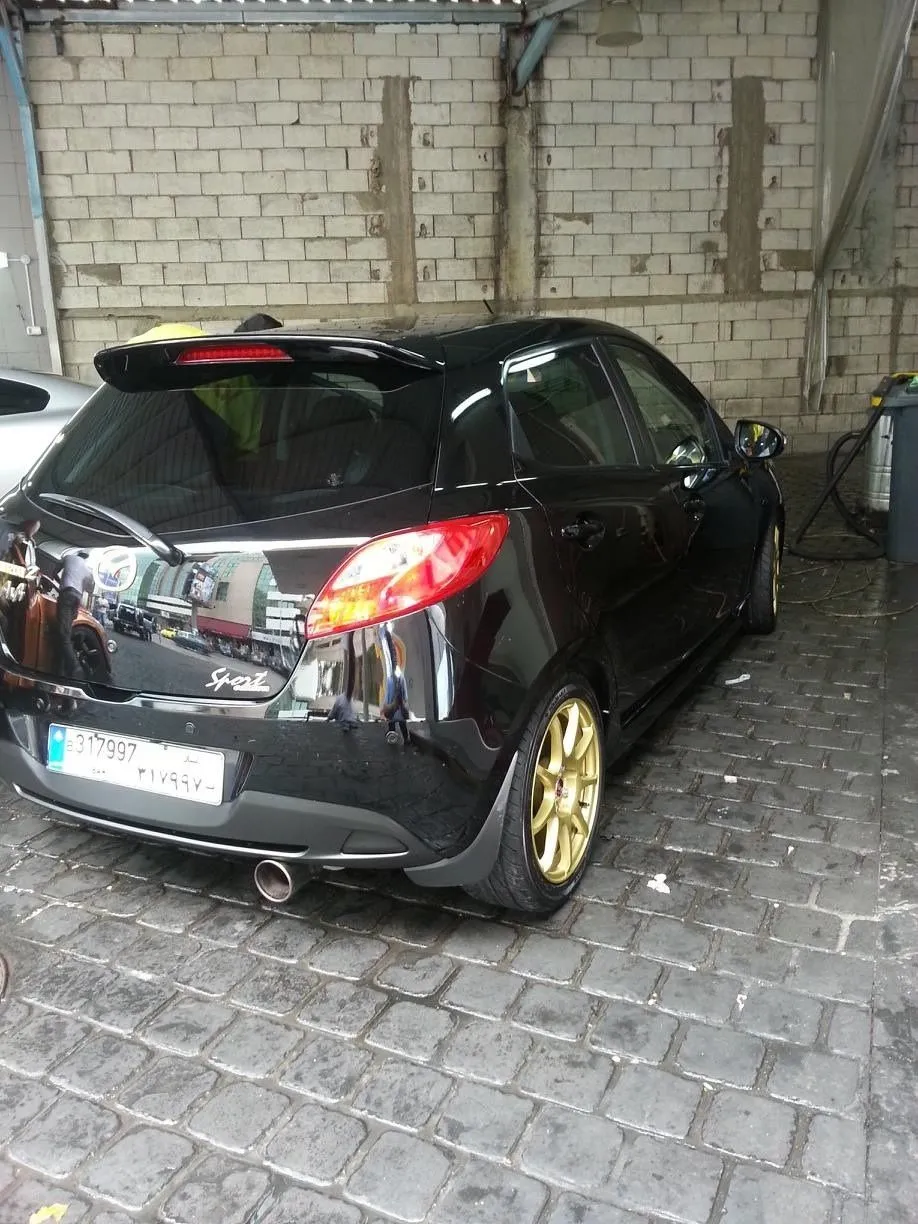

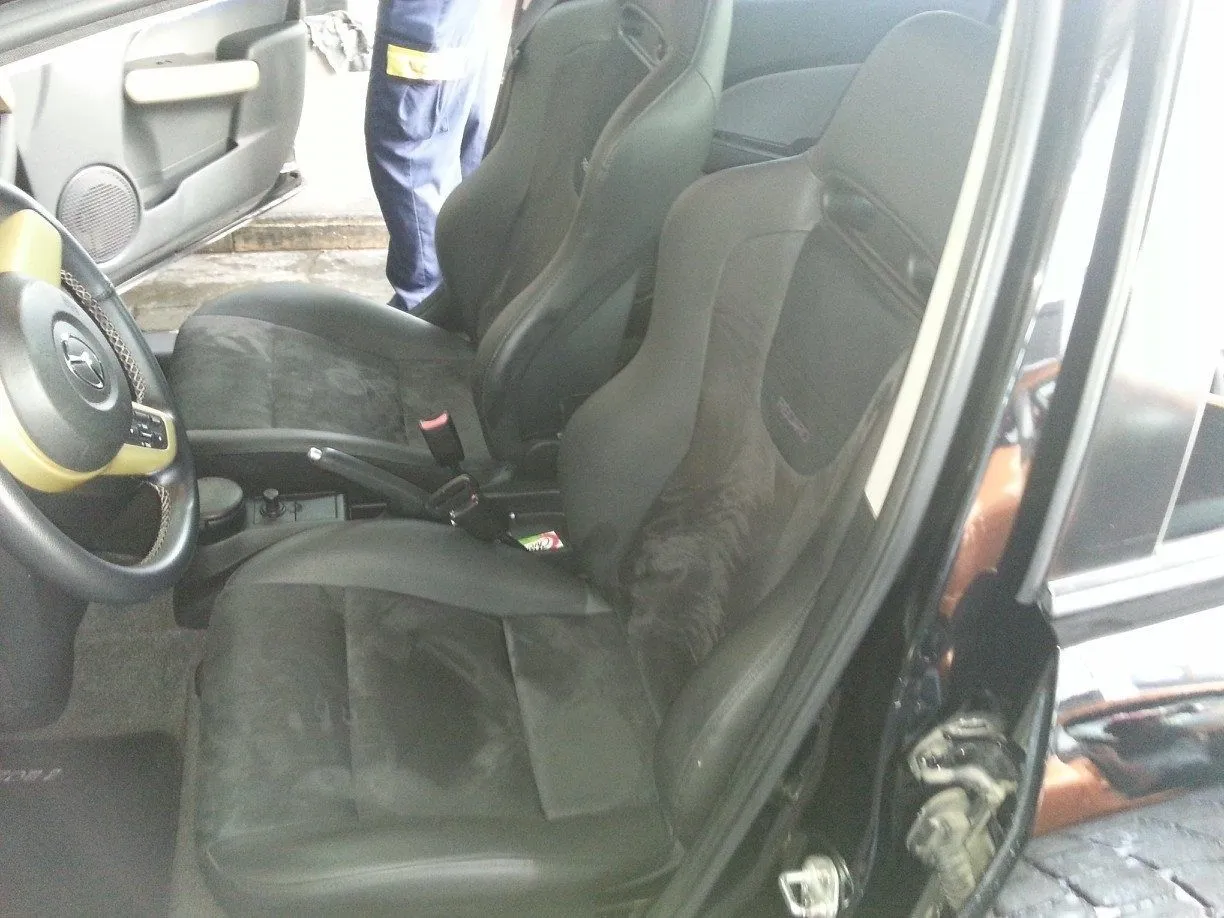

this a before after picture of the m2 enjoy
Not usually a fan of gold wheels, but they really look fantastic! it's the perfect wheel choice also. Subtle, but aggressive. Almost like a baby WRX wagon.
