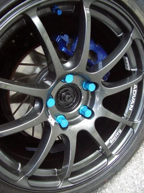

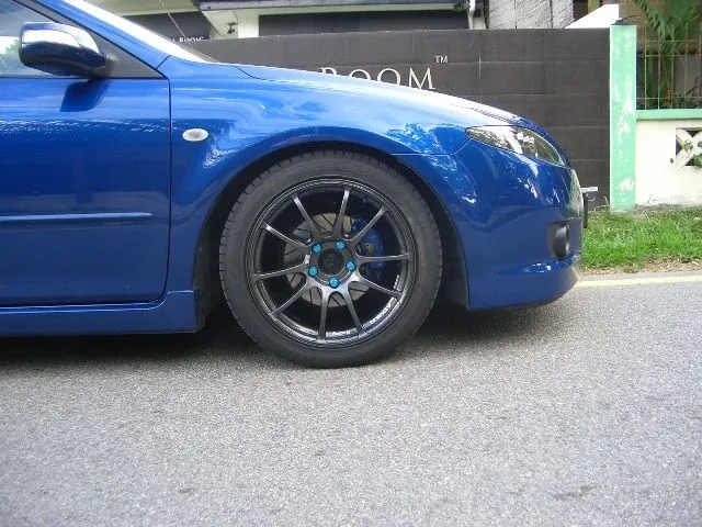

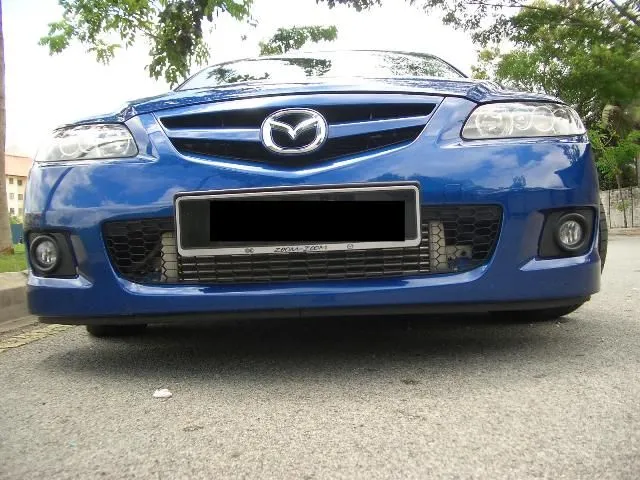

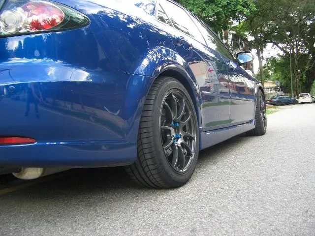

Got me some new rims so here is how she is looking today.

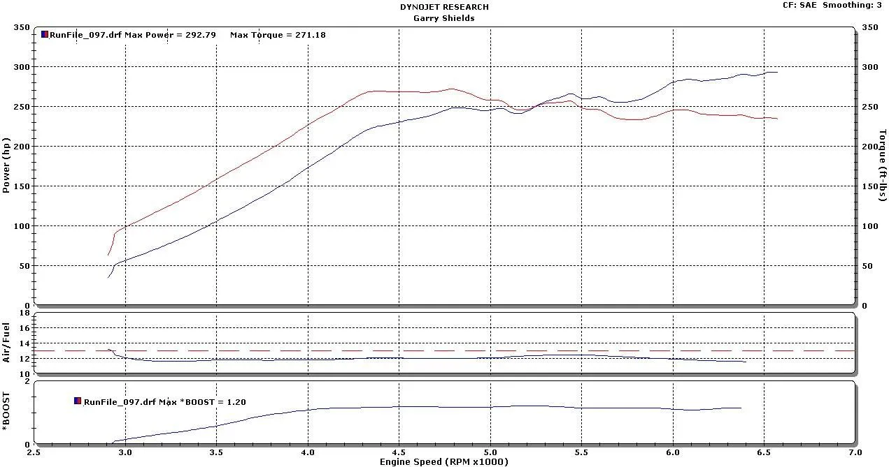

We had some problems tuning after the last round of mods. Fuel system was upgraded with custom higher capacity fuel rail, surge tank, fuel return system, fuel pressure regulator, twin Walbro pumps and 550cc RC injectors.
The main problem was our inabillity to maintain a consistent fuel map for more than a few runs on the dyno. We did a lot of brainstorming to come up with various work arounds, fixes, patches etc. Many thanks to the guys who contributed to this process (you know who you are) and your assistance was invaluable.
Eventually we decided to install a G-Reddy 3 bar MAP sensor and wired that up to the E-Manage Ultimate. At the same time, we used the boost limiter cut on the Ultimate to voltage clamp the stock MAP sensor so the stock ECU sees it within tolerance all the time.
