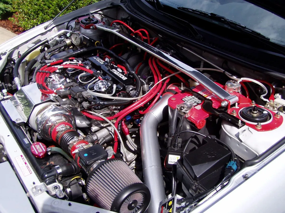

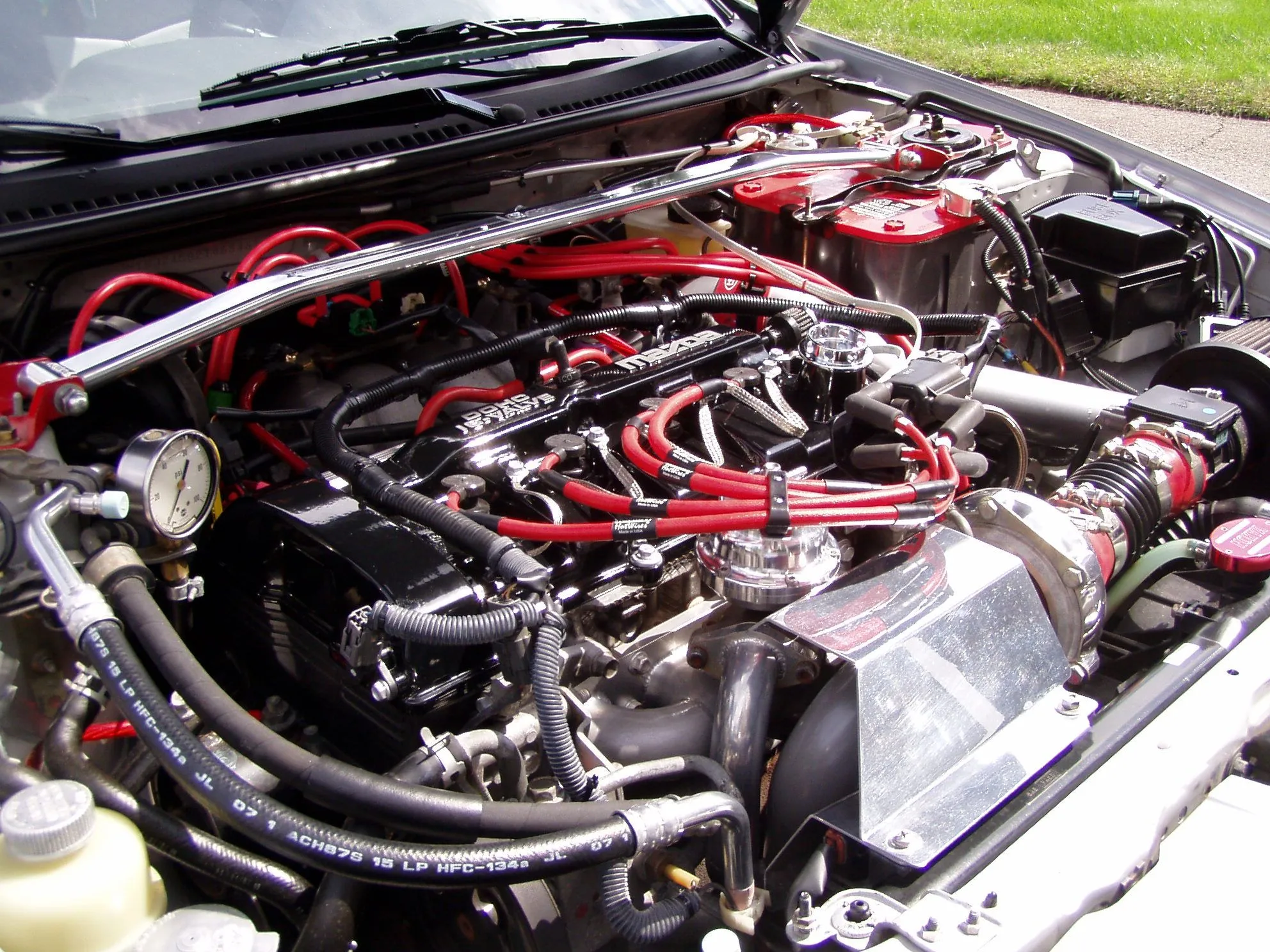

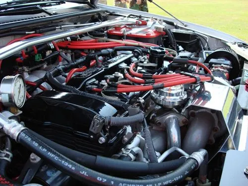

the auto suffers and the fun factor is low...you can safely turbo you auto, beef up the tranny with some lentech goodies,uis a rrfpr from begi, fm o2 mod, stay at 6 psi...and have a blast!...not cheap though...

I think im in love.
attachment.php
i was in love once too! she's still turbo'd but at 160k miles and 10 ne winters she slowly slipping away...but she still can oput a smile on my face!!!

WOW that is a very nice ride you have there Bazooca, I am not looking to go anywhere near that as I am just looking to gain a small bit (nothing special) and see if I can get a little better fuel mileage out of it at the same time. I have auto for the wife as she is the primary on the car and I am not looking to make it alll loud. I am not overly happy with the Hwy mileage as it just seams to burn threw the fuel far to fast for a 4 cylinder car :( I will look at doing the Injen cai and a Magnaflow catback for now and see where that goes. I found only 1 header for this car, would going this route will I then add a high flow cat after the header and before the cat back?
