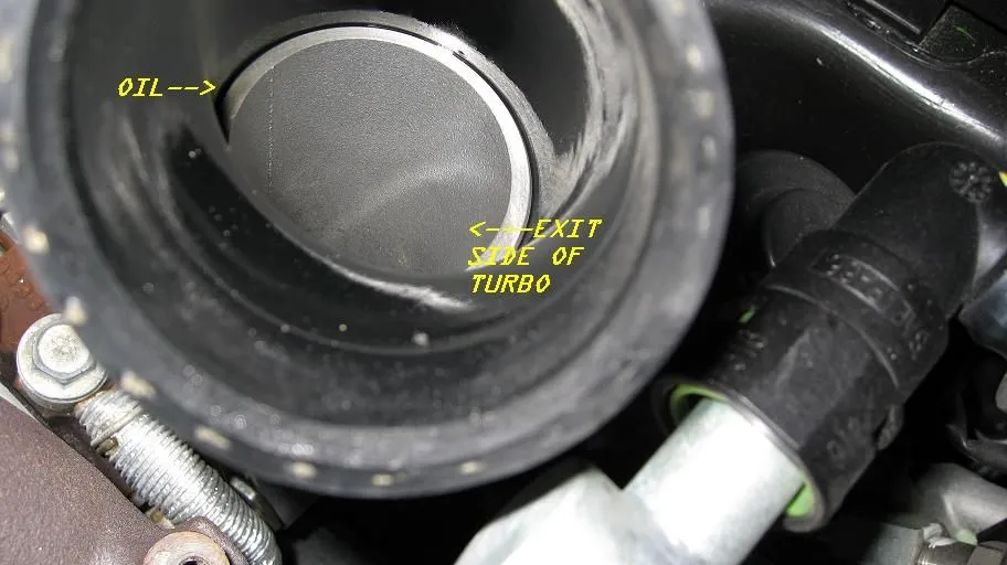

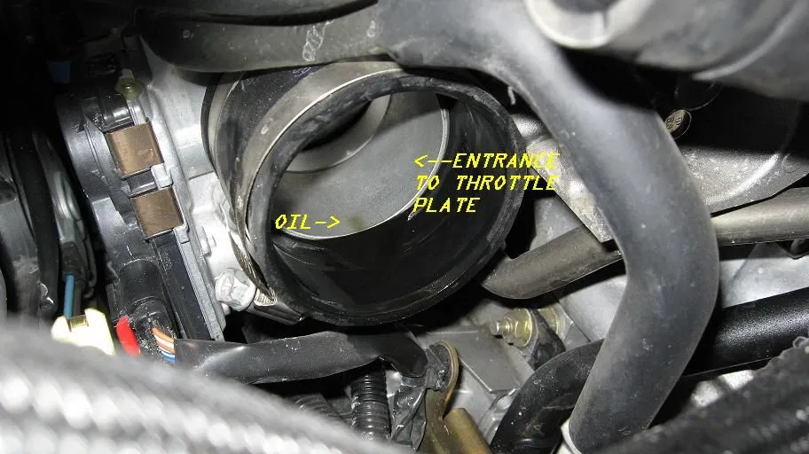

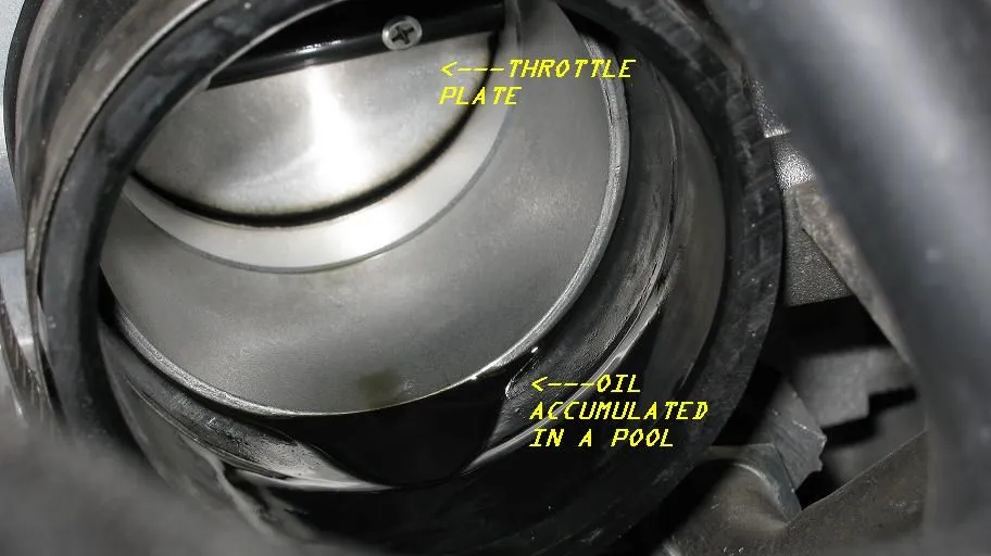

PLEASE SEE THE PICTURE I TOOK BELOW. The only way for oil to get here in a pressurized system is for it come from the charge point which is the turbo. The oil is actually exiting the turbo seal on the compressor side, going through the turbo and then the intercooler, to the engine. I am actually boosting oil. I know this for sure because the hotside of the turbo is dry, the inside of the factory downpipe is dry and not dark, so it has to come from the compressor side. Also, the fact that there is such a short amount of distance or travel between the turbo and the throttle/intake, the oil is going to get in the cylinder's very easily.

So all in all, THE FAILURE IS THE FACTORY TURBO SEALS. I would like everybody to chime in who have had this happen to them, pop off your intercooler, its only 2 hose clamps and a few mounting bolts, and check the exit side of the intercooler for oil. The entrance may have a bit as well obviously. If others have had dealerships give them a hard time, please reply. If others have had dealerships fix this problem for them, please give the name and address and phone number of the dealership and provide names of employees if possible.

Ok, first remove the black engine cover. There are two 10mm bolts holding it in place. Then remove the blow-off valve recirculation hose, and a small vacuum line. You can take both of these off using needle nose pliers, or standard pliers. Then loosen the hose clamps on both ends of the intercooler, one is by the throttle body and the other is the turbo outlet is, both are very accessible. You can use a flathead screwdriver or an 8mm wrench to do this. Then the last thing to do before you remove the intercooler is remove three 12mm golden bolts holding the intercooler in place. Once you take off the intercooler, look inside of it for oil saturating the inner lining of the black hose couplers, and look inside the turbo outlet (back of the engine bay), and look inside the entrance to the throttle body, (front of the engine bay) for oil build up. If your car is smoking, I can almost guarantee you have the same problem I have.

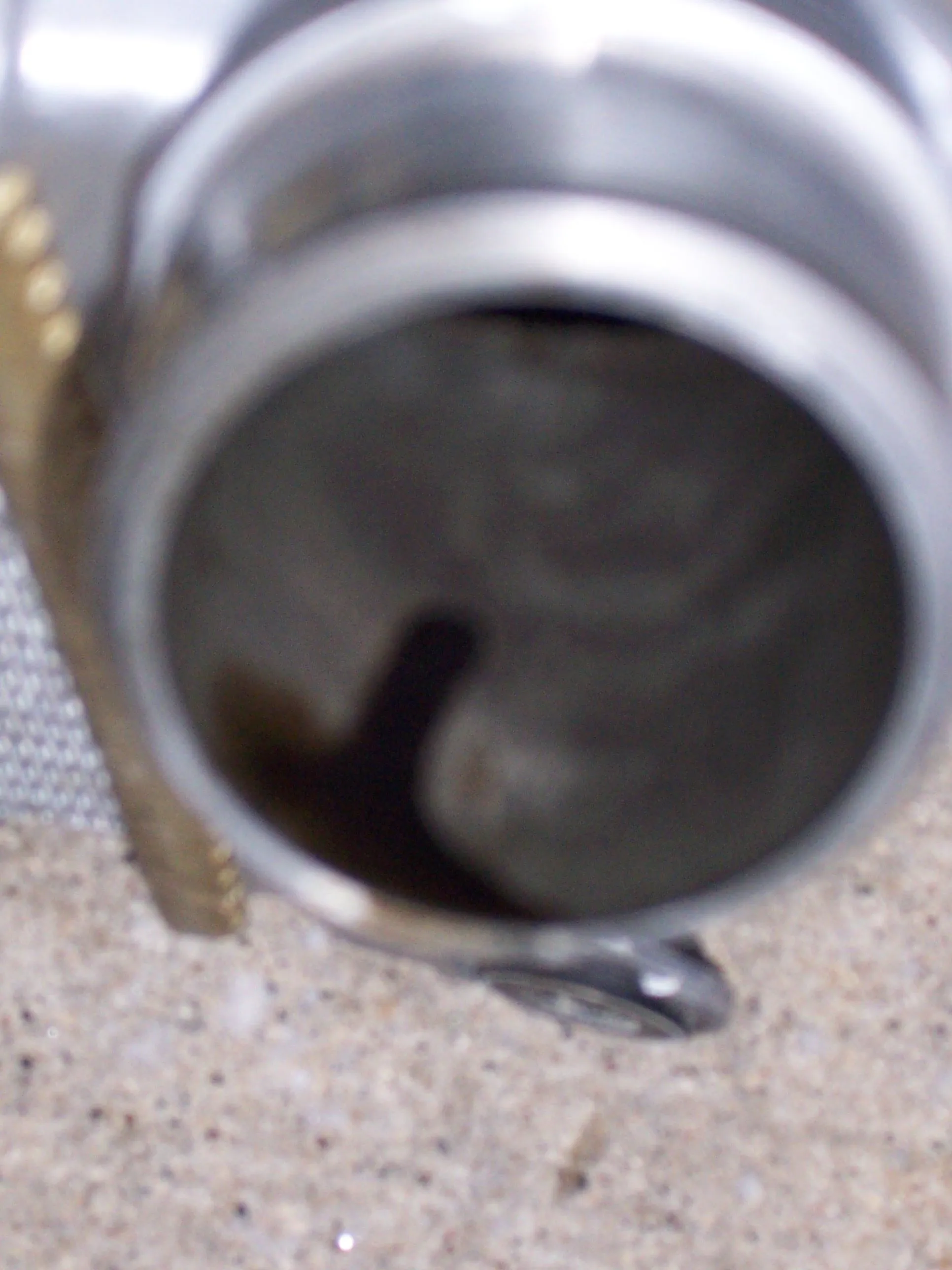

jcgemt2003 said:

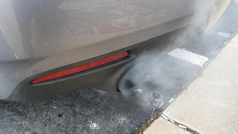

Does it look like this? (son of a b****!):mad:
I appreciate you taking off your intercooler in such a timely manner. That is exactly how mine looks. This problem must be evident in every last mzr disi turbo engine. I don't feel so bad anymore thinking I am the only one. VERT brought up a great idea about a catch can. Does anyone know of such a can on the market designed for our setup?
Almost all turbo motors consume some amount of oil and its normal. Even brand new, the system is put under extreme pressure and will inherently have blow by(turbo seal) because of the design. And the smoke you have pictured looks like normal steam from the system on a cold day?
Its true that the motor will consume oil but he is saying this is "blue" smoke not steam. The question is how long does it linger?
If its gone 6 ft from the car then no worries but if the clound floats down the street then there is a problem.
The bottom line here is yes your motor will consume oil but if its enough to get oil smoke out of your tailpipe there is something wrong.
