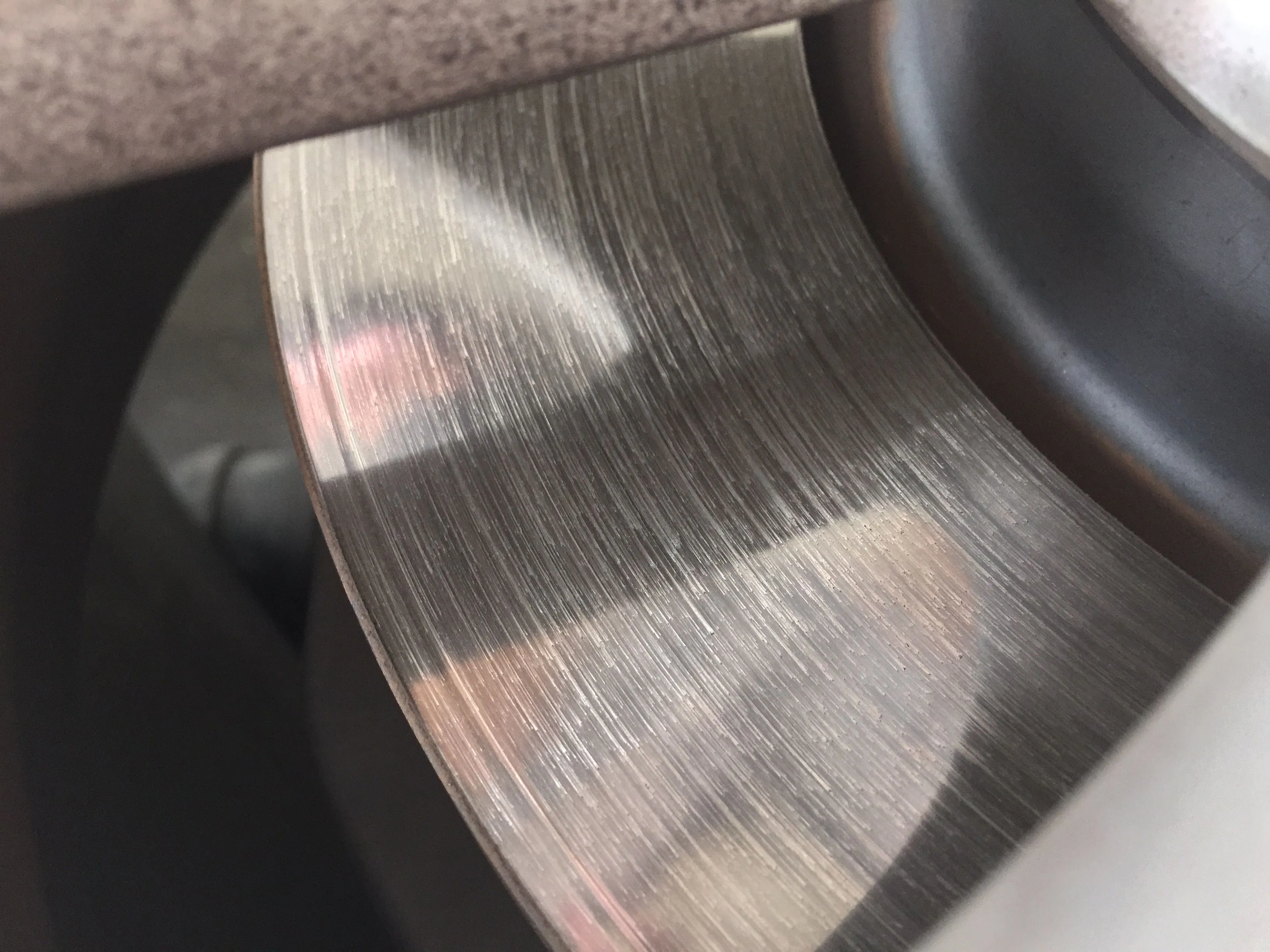

Here is my issue(bang)... I have measured my rotor thickness variation as well as runout. All are within specs. Runout in particular is at ~0.001". But I have a very small groove in one of the front rotors.
Now do I...
A. Just replace the pads? No additional costs. And not worry about it.
B. Cut the rotors? Bench lathe may introduce more runout. I do not have access to an on-car lathe. $210 from the dealer.
C. Replace the rotors? ~$130 but could be $340 if the new rotors have some runout and I have to cut them. Rotors in mind are Centric High Carbon Premium Rotors.
Attached is a pic of the rotor with the small groove. Hardly noticeable. Please give me your thoughts. Thanks for looking.

My worst case scenario had come to life. Had a shop bench cut the rotors. Bad bad bad idea. They introduced so much runout that I do not want to drive the car at the moment. At any position, runout is at 0.01", 6.67 times Mazda's maximum spec. The shop is willing to re-do the cut. Looking for suggestion to go forward. Need to get the 5 back on the road asap.(argh)

How many miles are on your current rotors? Are they original to the car? Why not just get better rotors that are going to stand up to your EBC pads for longer? That's what I would have done in the first place unless the rotors on the car now are nearly new. Centric high carbon are a good choice!
You should have sanded, not turned the rotors. Hindsight
Have them re-turned (free hopefully), check runout, check thickness, if within spec, run with it. If not, replace them.
I'd have left them as is. Now probably best to buy new set and get a refund on a cut.

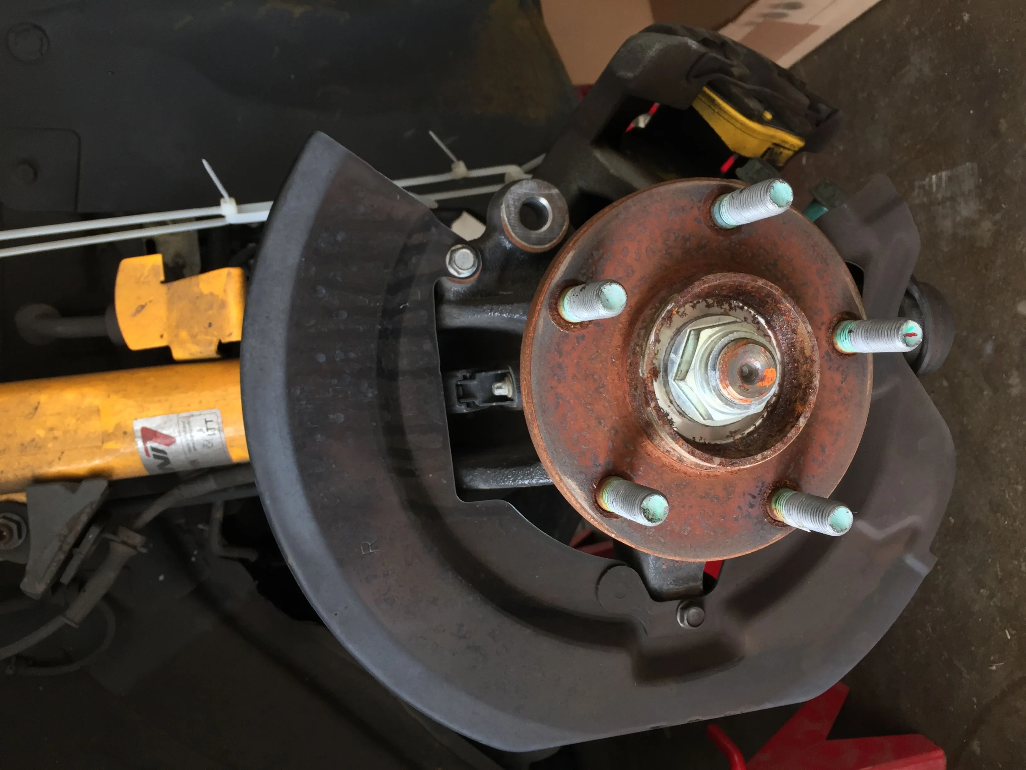

For those that changed their rotors, was there a ton of rust on your hubs? How did you clean them? Mine were pretty rusty. I used a wire brush and 3m synthetic steel wool med to clean as best I could then coated with some superlube.

Those don't actually look too bad, especially with at least 50k on them. There have been members on here who had to beat their rotors off in pieces they were so badly rusted. I'm planning on cold galvanizing mine when I replace the rotors.
I'm in Vermont so when I replaced front and rear rotors on our 2008 Mz5 at ~62k miles the hubs were quite rusty. I had a helluva time getting front rotors off actually. I had to beat them with a 4lb mallet until they shattered and then I could pry them off with a claw hammer. Pic of ruined rotor below. I used a wire brush and sandpaper to clean up the hubs and put a thin coat of anti-seize hi-temp on the outer edge of the hub before installing new rotors.
My hubs were rusty as hell and I left it exposed to elements for a little bit before I got back to it so it was extra crusty. I used Rust-Oleum Rust Stripper + wire wheel and cup. There are a few spots, especially around and in-between the lug bolt and center bore, which was hard to reach so was not cleaned as thoroughly as I should. I'm going to pony up and get the 3M Roloc hub kit and try again to get a good clean surface. I hope this resolves it for me. Otherwise, I have suspicions it is something else that will involve more time/money.
