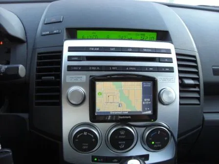

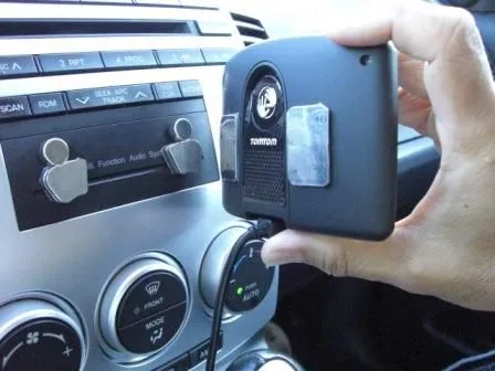

I used double sided tape to mount the first layer of magnet. Some 3M brand i got from walmart. Mounted it in summer. so far winter came and went and the double sided tape held on.
The magnets I got from inside defective hard drives. But there are similar strength magnets in the stores. You can place layers of magnets to maintain the gap between the 'wall' and to 'angle' the gps screen towards you. Magnets should not affect operation of the gps.

I have 2 locations for my gps. lots of possibilities with these magnet mounting
ideas. The gps already has bluetooth so my cell stays in the my pocket.
gps remote control also comes handy.

are you trying to tape them on the lower radio cover? the black one under ther radio unit itself? you can remove this. you need to disassemble the center console and push the cover from inside out. you can then use a hot glue gun to glue the magnets into that cover. this way they will be invisible afterwards. so pretty much the same way i glued the magnet under the shifter konsole.
on the first picture you see that glue gun on the right. dont know the english name for it but i think you can see what i mean.

It maybe be the type of mounting tape. And the problem of small magnets
having too small surface area for the mounting tape to support the load.
Another option is to use a piece of metal ruler, between the plastic surface and the magnets. Here's my 2nd gps location on the mazda5.
Its still a prototype. I'm still to make the setup look pretty. maybe color
the metal piece.
The photos show a tomtom One. But the magnets can support the heavier
tomtom 930.
