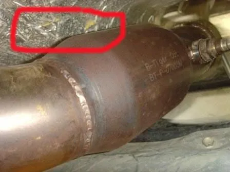

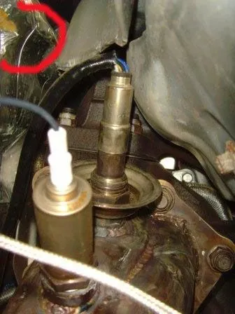

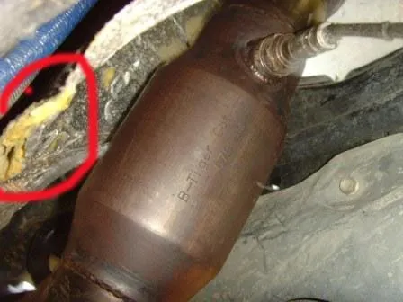

I scratched mine up a little and meant to buy some tape to make repairs but never got round to it. If i was to do it again i would have the tape ready when i did the install.
Example- where the 2 brackets are just by the cat or at the first O2.

Oh, I thought you meant the actual metal heat sheilds. I see now.
