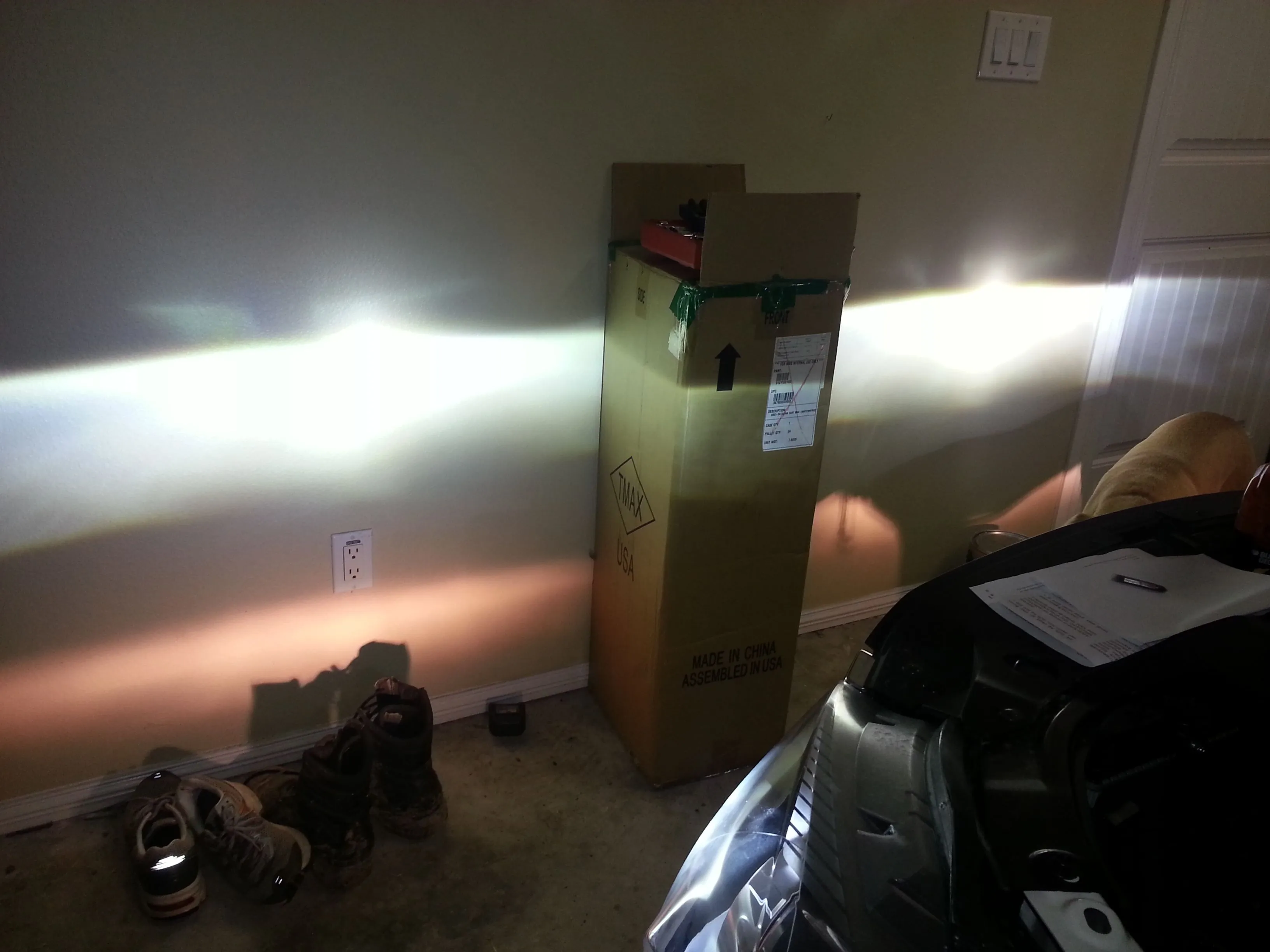

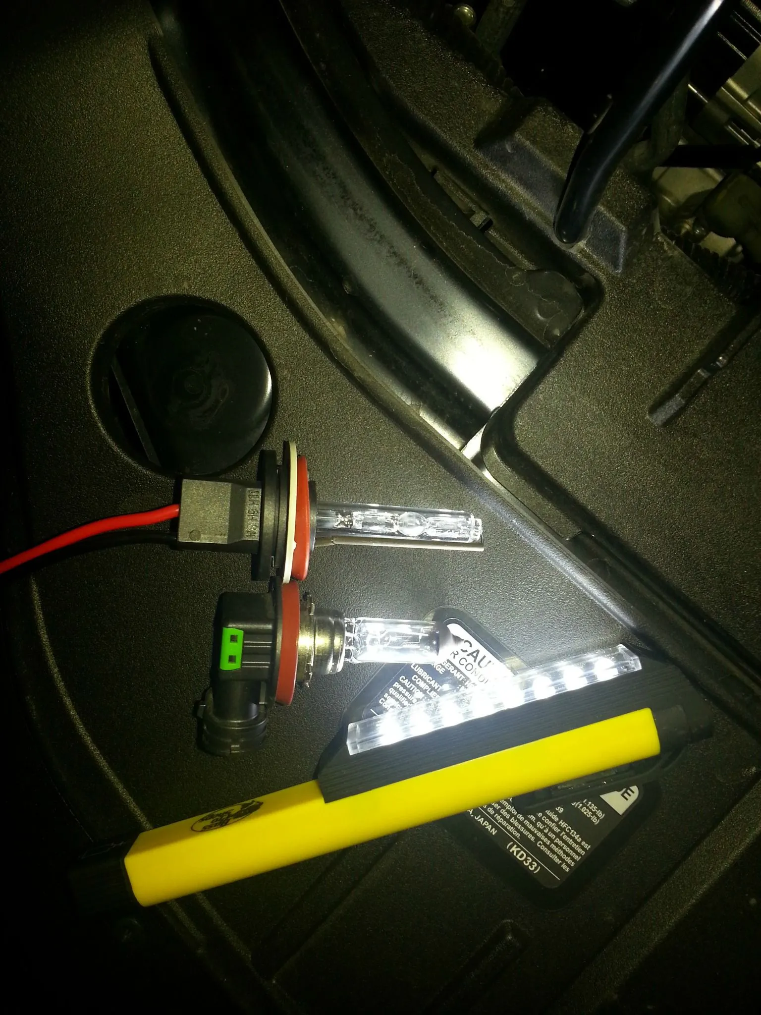

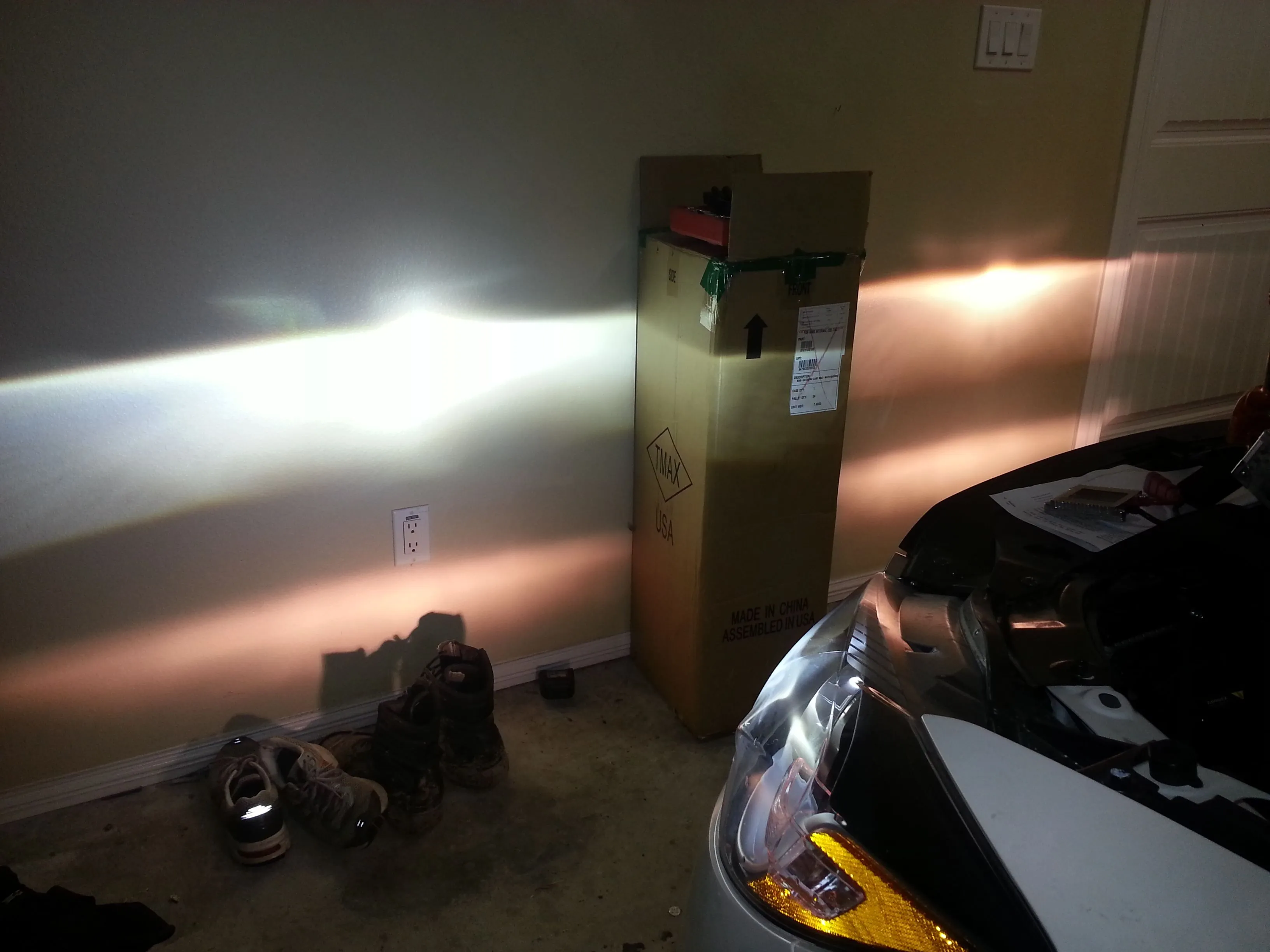

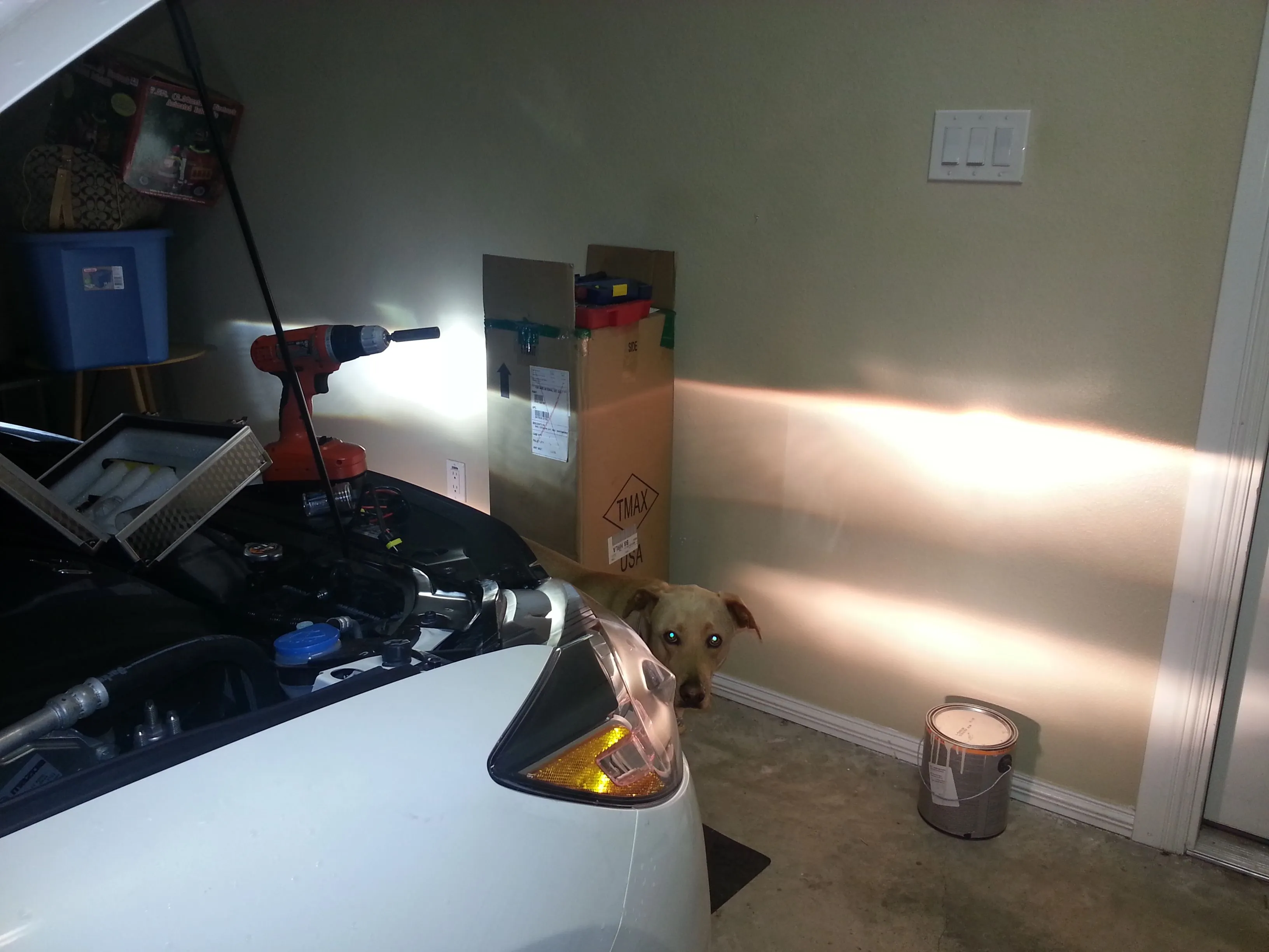

Well after much research I purchased this rather inexpensive HID conversion kit:
https://www.amazon.com (commissions earned)
The reviews were mostly positive, but I always assume I'm the one that's going to have the nightmare experience but I can honestly say that I am very pleased with how they've turned out. I decided to replace my headlights as opposed to replacing the daylight running lights (DRL's) only because I always have my headlights and fog lights on.
Installation would've been a breeze had I known that the replacement lights had an extra rubber washer (the white one) that I needed to take off. Also I should've been familiar with removing the connection from the bulb (stupid easy). So the first light took me about 35 mins but the second one only took about 8-10 mins tops.
Next I'm going to replace my fog lights.
Anyways enough of me yapping on, here are the pics:

Have any pictures of before and after from the front? All the HID conversions I've seen glare a noticeable amount more than the stock lights. And while I love more light in front of me at night I'm not willing to become the guy killing the oncoming traffics ability to see.
I believe glare is mostly a problem associated with reflector style headlight housings. The CX-5s have projector style housings that have a pretty clean cutoff.
the really, really bad glare is from the non-projector ones but I see a lot of ones with projector headlights that glare noticeably and distract.

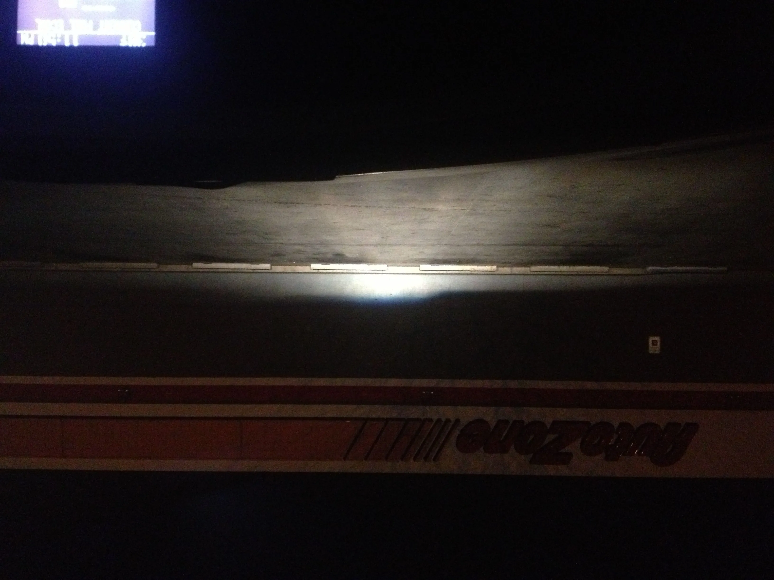

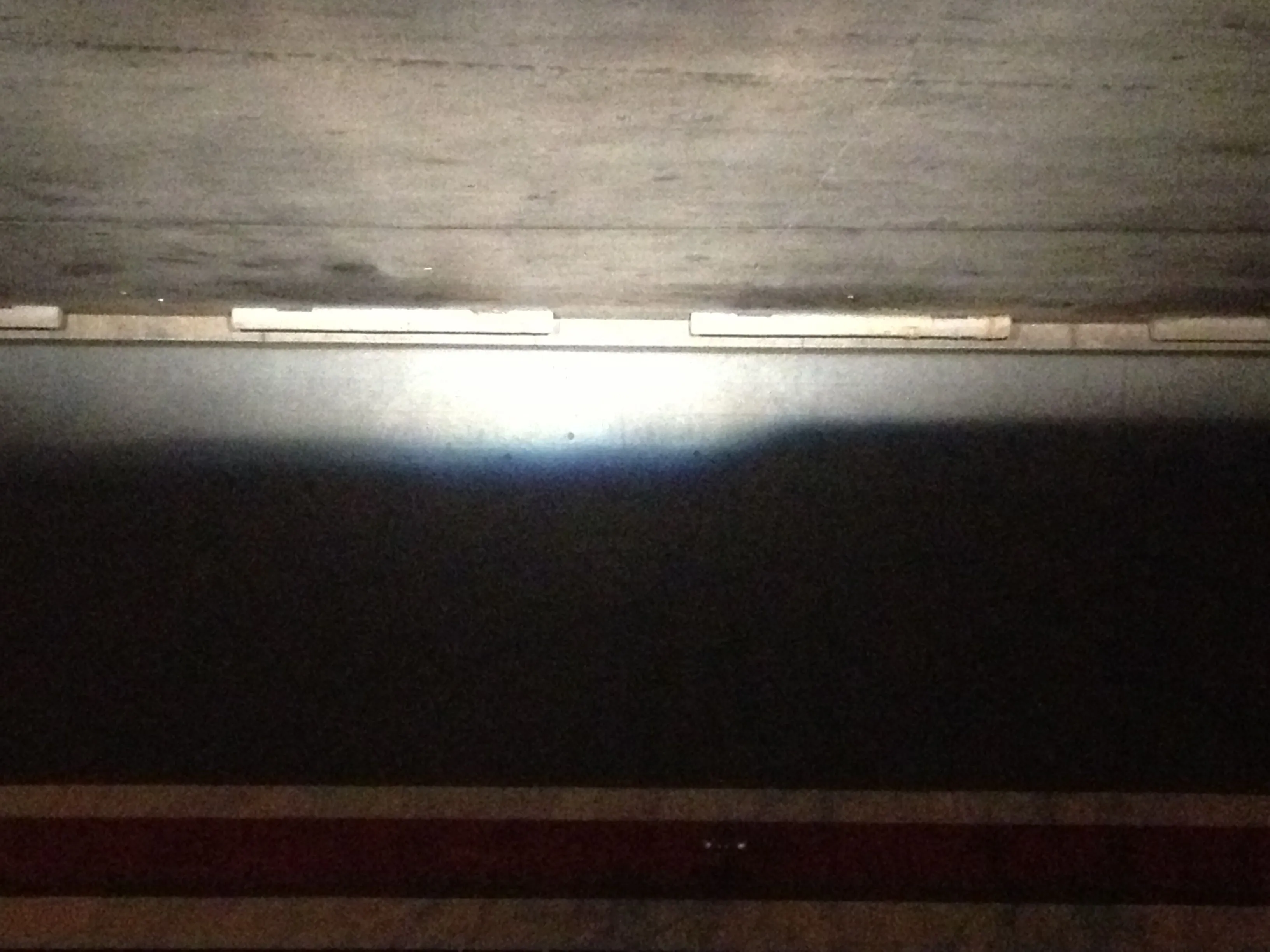

There is still glare. You can see there's still noticeable bleed off above the cutoff that's not associated with the squirrel finders. The cutoff on these Koitos are okay but I would not call it clean by any means. A clear lens would make it clean vs the stock fresnal lens. I have Black Series clears lenses from TheRetrofitSource.com and I blocked my squirrel finders. I believe these are the same Koito projectors that the 3 uses which are okay but even modded they don't compare to a true HID projector.
