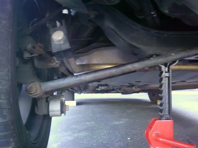

i need help with awp rear sway bar
LostSoulx316
Contributor
2003 Protege5
i can remember if it goes over like in the pic or under
Don't jack the car up to install swaybars. Should be installed on ramps...
And it depends... Mine adjusts so it can go on either side depending on how it is adjusted.
EDIT...UNDER!!!! thought you were asking about where the endlinks would go...Maybe I should see the picture first...and...You should install the swaybar on ramps...it should be installed with weight on the wheels/frame.
ya i know that i just jacked it up to get the bar on and then i was going to lower it to put the end links on and thank you for your help
What lateral arms are those?
Over/Under... well not sure about the AWR but the progress and stocker goes over (above).
See Attachment...if you can... Swaybar is under, endlinks are over.
I better check my installation... LOL... I must be imagining things the wrong way in my head.
