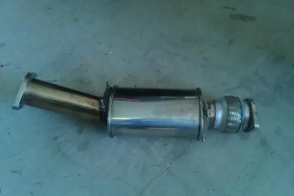

Read my sig below. I have a 3 inch Vibrant Ultra Quiet stainless resonator welded into the middle of my racepipe. I'm running a catless dp/rp into stock CBE. It droned badly at 2,500 rpm range, especially when cruising or when decelerating though that range. The reso zapped the droning and took the edge off of the catless dp/rp volume. It's an easy install. There are threads here about this. I installed the reso right after hearing the drone which was at least 35,000 miles ago. It is holding up just fine. It is a big open straight through reso and will not steal any power. 60-100 comes up in 6.1-6.3 seconds depending on weather. 40-120 comes up in 12.5 seconds. The reso takes nothing measurable away from performance.
The size of the reso will depend on where you put it. If you have a one piece dp, you would put it close to the end in what would be the rp section. If you have a separate rp, it goes in the middle. The size will depend on your own piping at the location you chose. Since my rp was 3" that's what I got for the reso. It will slip fit over the outside of your pipe. You can then clamp it in place after rotating to fit, then remove it and take it to a muffler shop to get it welded. Easy.
Cost should be around $90 for the reso. Vibrant part # for the 3 inch is #1142 and for 2.5 inch is #1141. Extremely high construction. Amazon is going to have the best price.
Here is what it looked like before I took it to the shop for welding. Can't find the post-welded pix, but you get the idea.

Excellent writeup MSMS3! I considered adding another resonator to the factory exhaust when I had it. I may have to do this instead though! THanks!
hmm that seems nice, i want to keep my downpipe and racepipe the way it is though, would it still work if i put a GIANT resonator after the racepipe? I was thinking like a 15 -20 incher if it fits LMAO
Don't know why you want such a long reso, and not sure where you could fit such a reso in the CBE section. Most of the internal volume you are getting in the cabin is coming up through the floor via the general area of that frame cross member and resonating inside the cabin. Your racepipe runs right through that area. IMHO, that was the ideal place for me to attack the problem.
Of course, I was concerned about the drone primarily and secondarily the increase in volume. Your concerns may be different.
Let me say that the expensive part of the race pipe are the flanges on each end and the flex joint, if yours has one. Adding a reso does not affect any of that. You can go back to stock very easily. Just save the section you or your muffler shop cut out. Test the reso first with stainless muffler clamps before welding in place. If you like the result, and I think you will, you can then leave it with clamps or weld it in.
If it doesn't work, the removed part of your rp can be welded back in place.
Putting a reso further aft, if there is room, might help noise level outside the car, but if cabin noise is the issue, attack the problem at its source, and where there is room to make the change. I'd just hate to see you cut up your CBE which is way, way more expensive than your aftermarket race pipe.
