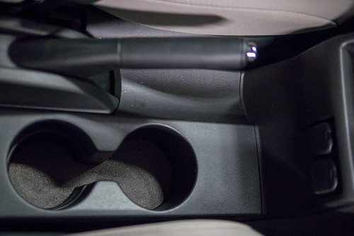

To start, you need to take the panel off and bring it inside. The interior is really easy to take apart, just get a pry tool and pop off the cup holder first. Once that's off, just pull the panel with the USB and accessory outlet and unplug the connectors.

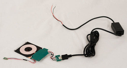

It's pretty easy to dismantle, just toss the aluminum stand that comes with it and run a flat head screw driver between the top and bottom plastics. It doesn't hurt to pry a little to get it open. Once its open, the charging board is held into place with four bits of glue, they are the black circles on top of the metal. You can gently pry the piece off and you'll have the charging element.

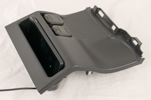

You'll want to align the charger around the middle of the cubby. I had it plugged into a wall USB charger while my phone was in the cubby to make sure it was charging. Once I verified a spot, I hot glued it into place. You'll notice the charger has a LED to show that its charging. I drilled a small little hole on the top of the cubby and glued the LED into place. I also glued the wires to the micro USB connector so it stays in place as well.
I tested it for a couple hours to make sure the charger did not overheat or get warm. It stayed cool the whole time. The green little dot is the charging LED reflecting off the glass screen.

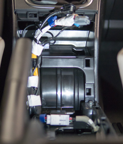

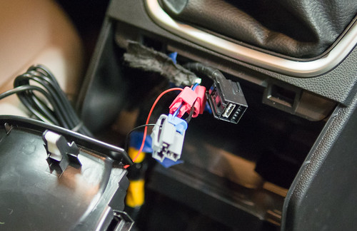

Now you have to wire in the EDOTECH micro USB hard wire kit into the car. I just tapped into the accessory power jack using wire taps. The blue is positive and black is ground.
I used gray double back tape to tape the little brick part of the hard wire kit to the bottom left of the cubby. I taped the wires up using electrical tape. I kept the EDOTECH adapter still tied up and just let a little bit of wire loose for the micro USB connector. I tucked the wiring into the little area available behind the USB and accessory jack wiring harness (in front of the eBrake).

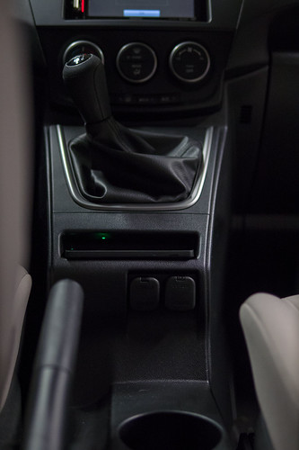

And that's it. Since I tapped the accessory jack, it only turns on/off with the vehicle ignition so there's no phantom power drain to worry about. Let me know if you have any questions or comments.

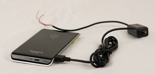

- ADATA Elite CE700 wireless charger - $40 (the official Nexus 5 charger is too thick and will not fit)
- EDOTECH hardwire micro USB kit - $15 (they have an Amazon store)
