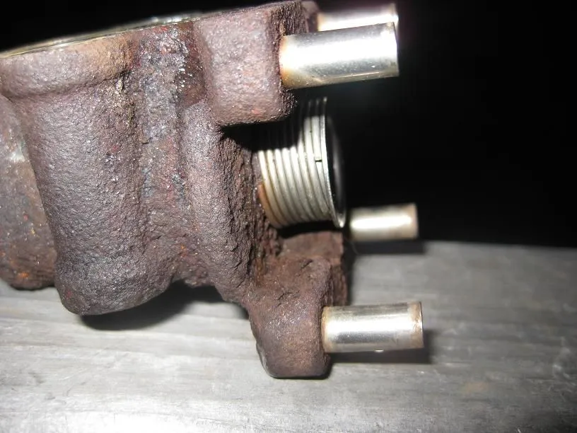

I removed and am cleaning my EGR valve now... my car was stalling, 125,000 kms, never had this cleaned before. It seems to have clogged at the same time that my alternator died, but anyway...
I had a hell of a time getting it off (2003 protege5). My spring does not look like the loose one pictured at the start of this thread. Mine is tightly coiled, and I can't get it to move at all. Is that normal? I'll attach a pic. Is it jammed in the compressed state, and is that why my car will not idle (at idle my tach bounces like a kid on a trampoline, low, then blips up, until it stalls).
Just wondering if I should do anything before I go to the trouble of reinstalling everything. Do I need a new one???
And what is supposed to get cleaned, the walls of the holes, or is it the parts at the bottom of the openings? I can't really get at the bottom, I just scraped the sides a bit, and let it soak in Carb cleaner (Gunk's Carb Medic) for a couple of hours. Is that adequate product & time?
Yours is gummed up, that spring should not be compressed. Try to clean the valve so it will move again but it's probably time for a new one.
