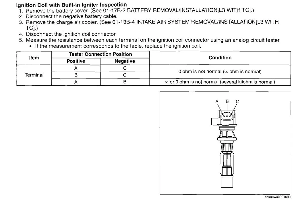

There is definetely a resistance value for both the low and high tension parts of the coil. Mazda will know this value and you can test it with a simple volt/ohm meter on the bench. However, a melted spark plug will usually take the coil with it.
Here it is from the manual.

thanks guys i ordered a new coil from dealer will pick it up tomarro at 930 hopefully it resolves the problem. But tell me not it sounds HOTT lol!!
