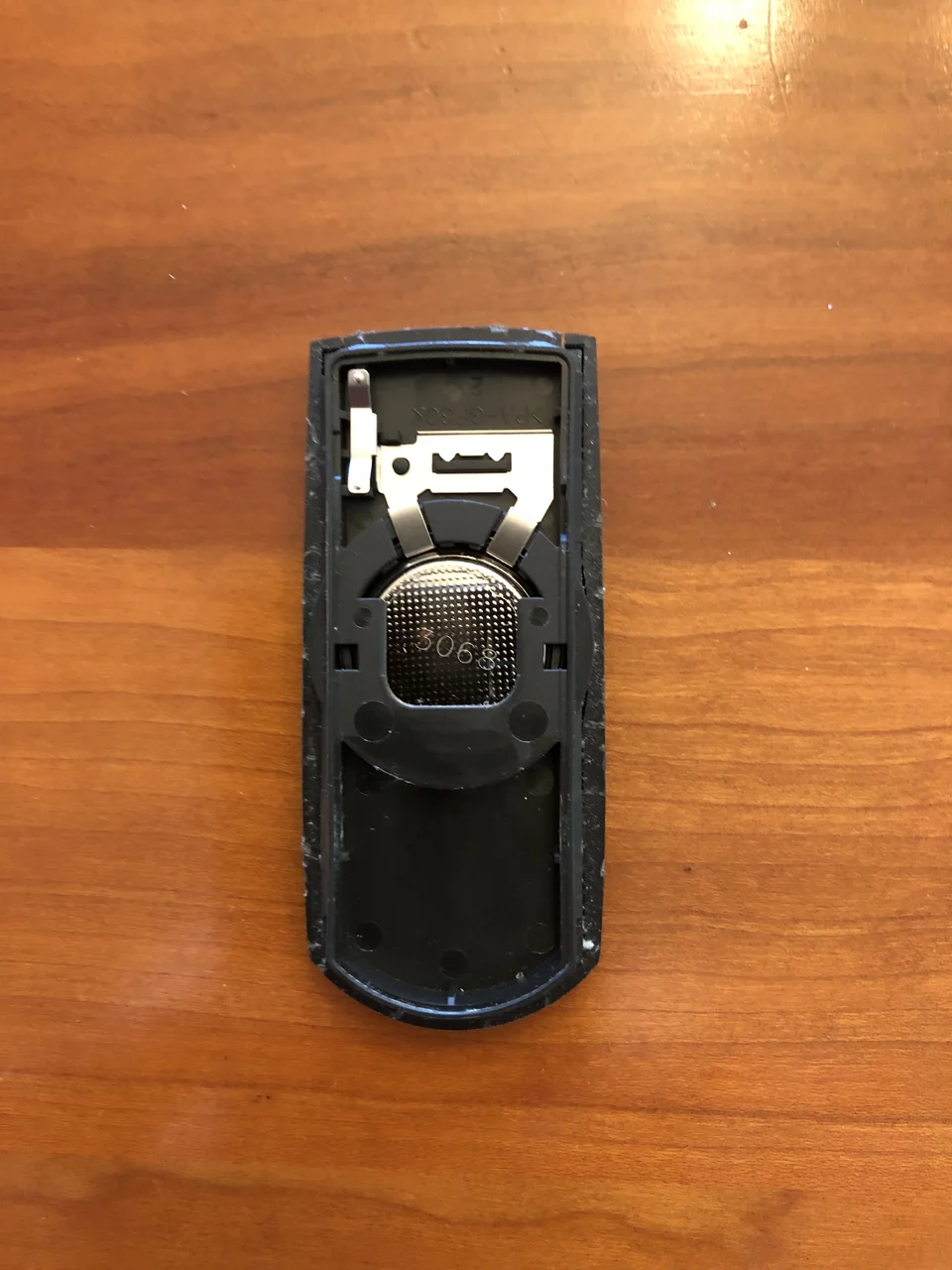

How to change CX-9 Key Fob battery?
Does anyone know how to change the battery from this CX-9, 2014 key fob?
Replace the battery, marked 3068, by sliding it out from the fob. Make sure you put the new one back the same way.
For a 2014 CX-9, here's the manual -- take a look at the section on p 3-24, and note that it suggests gently using a small screwdriver to pry up the battery:
For a 2023 CX-9 here's its manual -- on p. 6-33 it suggests gently using a tape-wrapped small screwdriver to pry up the battery.
My own 2016.5 CX-5 is much the same. I can generally get it out without using a screwdriver, but a couple of times I've resorted to one.
Pro tip: the teeth of the physical key are just the right width to fit in the groove that runs around the edge of your fob. The key makes a pretty excellent prying tool.
