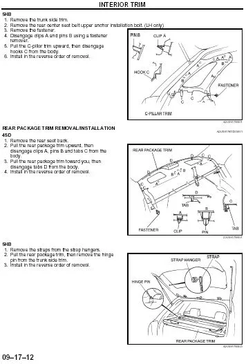

removing rear trim...
Here are the diagrams on removing the rear trim (taken from the workshop manual)...

Awsome, any more you want to email me or post I would love to get in a sticky thread.
