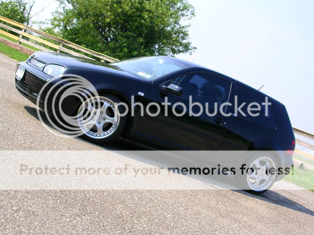

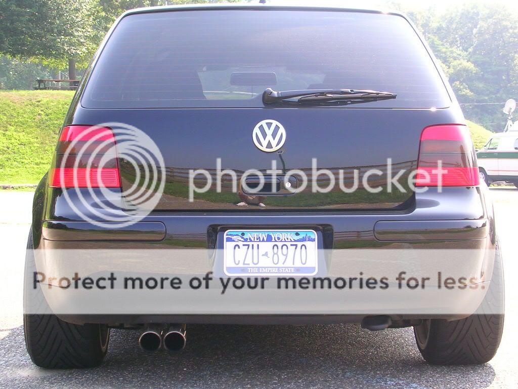

This is my car from back a few summers ago.
Other than the fact it is not practical, I see most of your arguments out the window. The recurring 'retarded' explanation carries no weight.
There's plenty of cars with differing body lines where it looks and fits normally.
Sure there is an increased cost due to tire wear, and hindrence on racing performance but I still see no reason why it can't be done for looks!
Nothing more than personal opinion!
Never said it can't be some simply for looks. But, to me, the "look" isn't worth screwing up the handling of my car. The car loves to understeer enough as it is, I don't know why anyone would want to make it worse.
It don't look retarded to me it looks like real performance.
