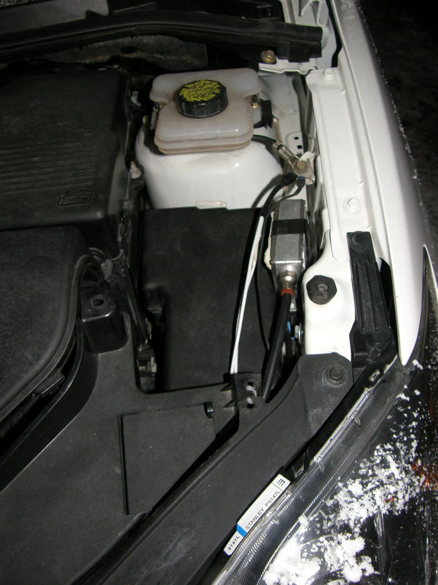

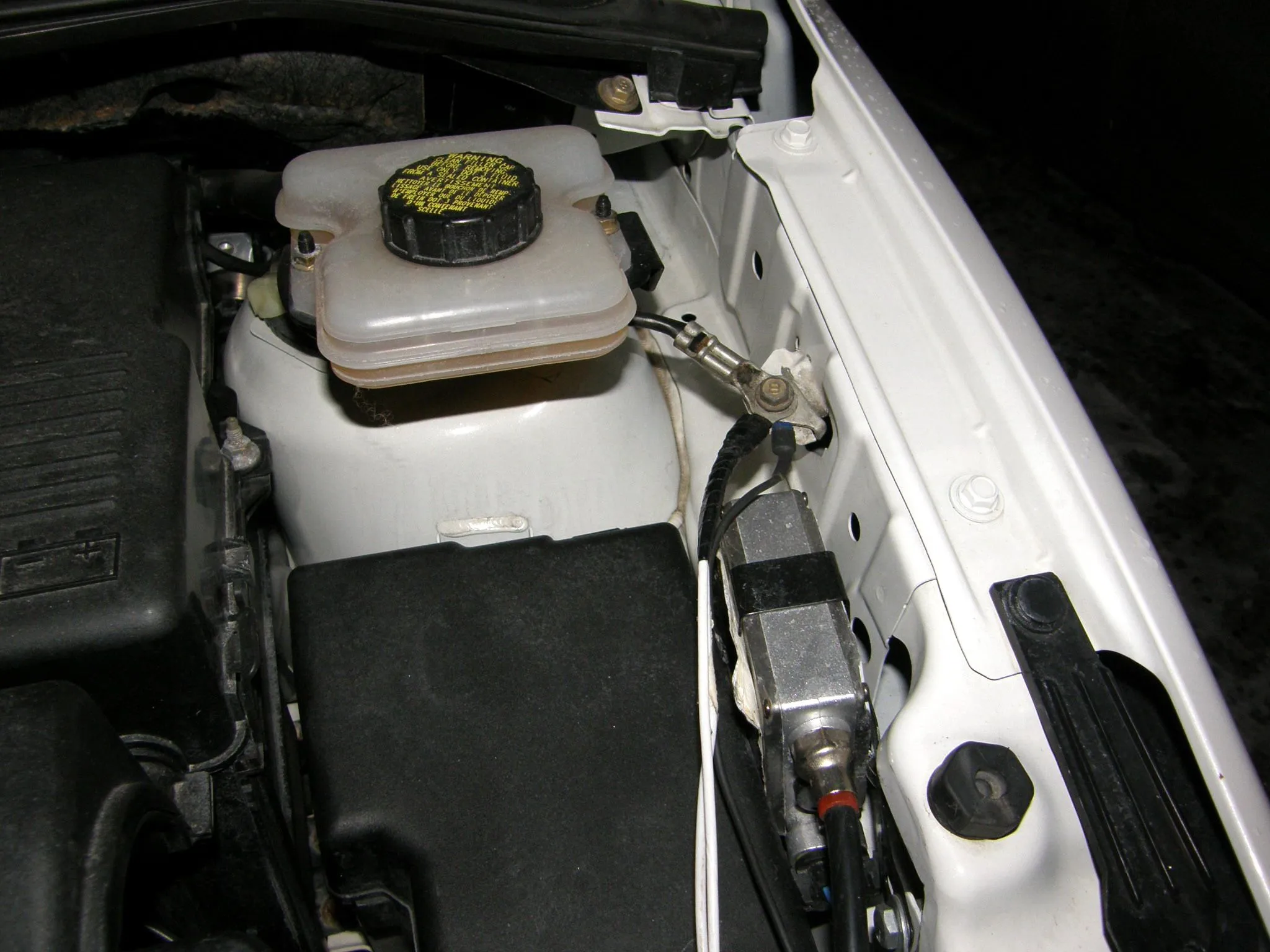

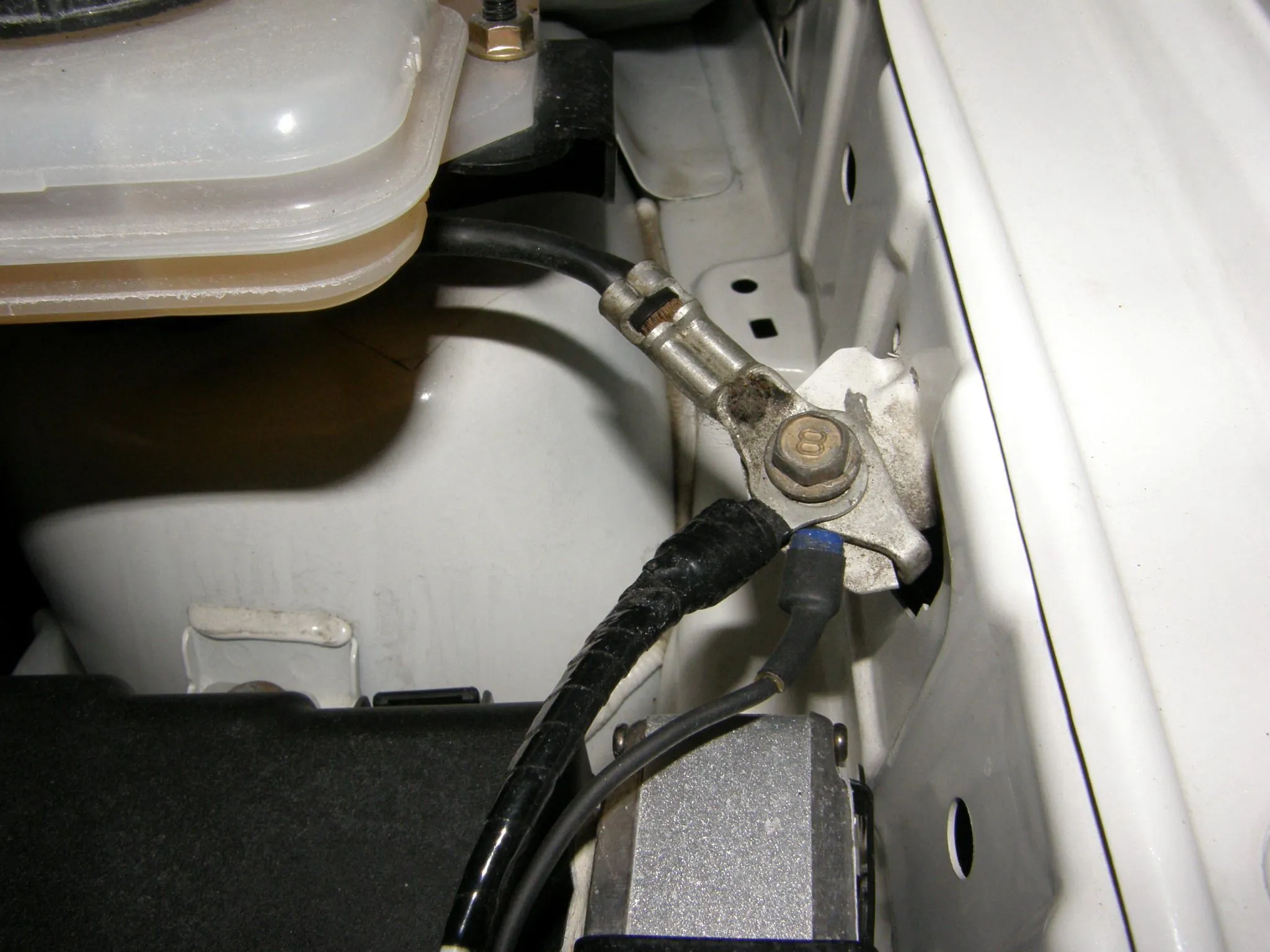

What I did when installing the HIDs, is to install a relay (with fuse) and the ground is directly to the frame of the car.... And still, every time I start the vehicle, they start flickering... Are you telling me that I should look for another ground? I just went outside to take 3 pics to show you where it is located. You'll see that even the battery wire is connecting to this section... And the reason why you see an extra 2 wires, is that one is for my low HID and the other one is for my fogs HID.
Dima, if you could help, I would really appreciate... I'm tired to see my wife driving the 5 and forgetting every time to turn them on first... Same thing when I bring it in for service.
Would you mind taking a picture to show me where you've put it?
Thanks,
Jasma.

Hi Jasma1,
They mean the ground from the car light plug ground wire. Cut the ground wire from the low beam light plug then ground the ground wire from the light plug on the body of the car. Tape up the other side of the wire and don't use it. What it does is your HID will get full ground from the body not from the low beam wire (ground wire only).
When Mazda make our Canadian M5 with DRL, what they do is when DRL is on, they flick the ground wire very fast on low beam to make the low beam deamer on DRL. Because they flick so fast, our eyes can't tell it flick and only see the light is deamer then on full low beam. When you turn on your headlight, they give full ground. Because HID work diff. then filament bulb, thats why we see flicking when you put HID on our Canadian M5 with DRL.
I hope you understand what I mean
