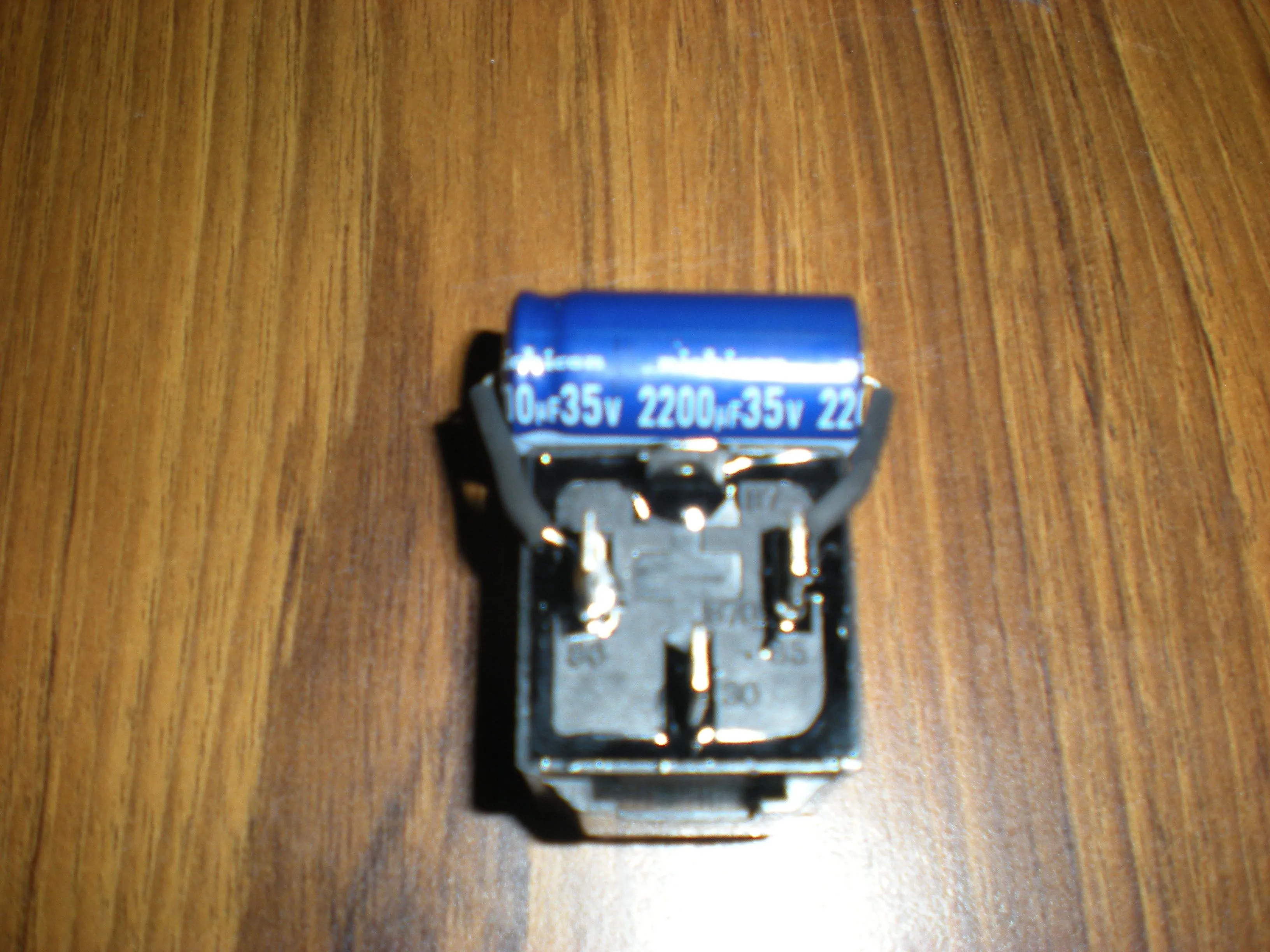

6) Solder the negative lead to the relay lead you noted (in step 3) as negative and the positive lead to the relay lead you noted as positive
See Attached Picture
7) Insulate the exposed leads with electrical tape or shrink tubing so they don't short out
