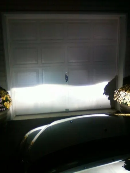

Hey guys. Just wanted to ask if this beam pattern seemed right to you. I honestly can't remember what it was like with halogens. Is the "wave" thing supposed to be like that, or does the passenger light need to be adjusted up a bit?

first if you installed HIDs in a car that did not come with HIDs the level will never be perfect due to the fact that the headlight assy is not set up to the proper pattern for HIDs.
That being said HIDs when set properly will project out in a step pattern with the drivers side being lower than the passenger side. That is to stop them from blinding oncomming traffic...
Think of the light pattern as a series of 3 steps with the drivers side being the lowest step and the pass side where the highest step would be and thats what the pattern should look like
The wave should not be there it should be a straight line with defined steps going up from drivers side to pass side....
Hmm...I've found a few shots of the pattern of others that did this mod, and theirs was about the same. Wavy and all. I just wish I could find the pattern for the stock halogens to compare with.

you get the wave because the beam pattern is designed differently for the halogen projector. a proper retrofit would include a projector designed for oem HID so you can have the correct beam pattern with cut off (although the retrofit still remains non-road legal in the US). i do not know if the speed6 headlamp assembly is the same as the normal mazda6, but my guess is no. the price for 1 normal mazda 6 halogen assembly is about $600, while a speed6 headlamp assembly is around $1000. also the 2003-2005 headlamps were slightly different than the 2006-2008 refresh.
