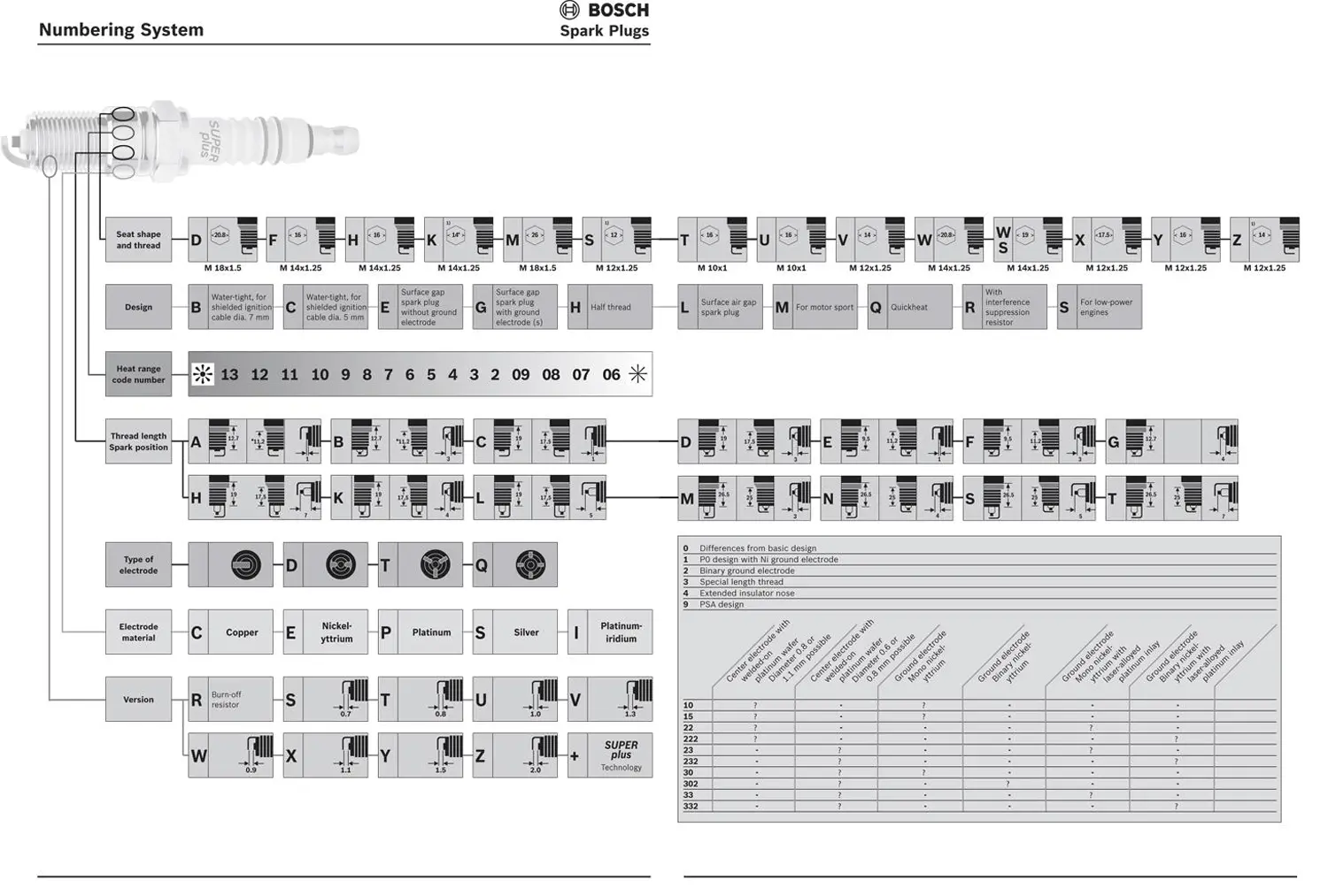

A little investigation info:
Bosch plug 4515 should have this number on the plug - HGR8MQI
If it does, it is my understanding that the 8 represents heat range 8 under Bosch's system. See attached chart to decypher Bosch's numbering code.

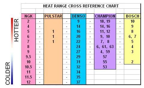

Then consult attached cross-reference chart.
If I am reading the chart correctly, that would be equivalent of an NGK 5 or a Denso 16.
If that is right, the Bosch plug is one to one and a half heat ranges too hot. This could be the cause of your problem.
Also, there is data to suggest that platinum (even in a blend with iridium, as with your choice) is not a good choice for high cylinder pressure engines, such as cars running nitrous or turbocharged cars with high boost and high compression ratio and direct fuel injection.
The preferred plug would have an iridium tip, but would have the core of that tip and the ground electrode made of pure copper which is better at transferring heat, rather than holding it, as platinum does.
I don't know if going to a proper heat range Bosch plug will solve your problem, but it would seem to me that you would be better with either stock plugs or the NGK or Denso equivalent with iridium tip on copper core and a solid copper single ground electrode.
